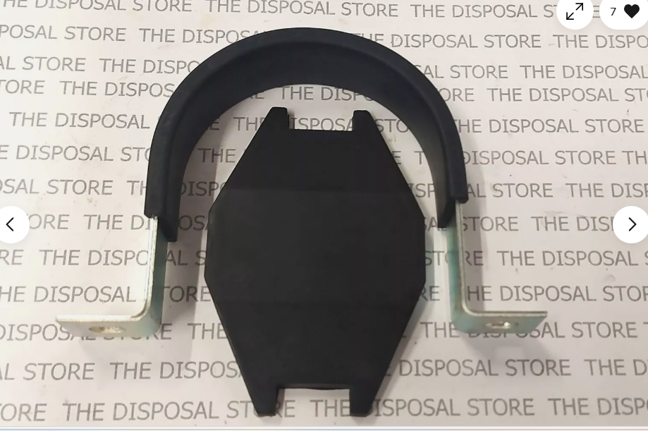

    it gets really tight when you mount the motor too at the a-pillar - -getting your new tail/ loom plug on can be a chore if you didnt plan it very well and the motor is in backwards
    dont skimp on the mounting, when you mount the motor down on the a pillar - -it will protrude a smidge into the cabin area - -this gives you the chance to really lessen the whirr- whirr of the motor though, especially on a long journey, you wont get hypnmotised with the dreaded whirr - -like when they are above your head on the header
