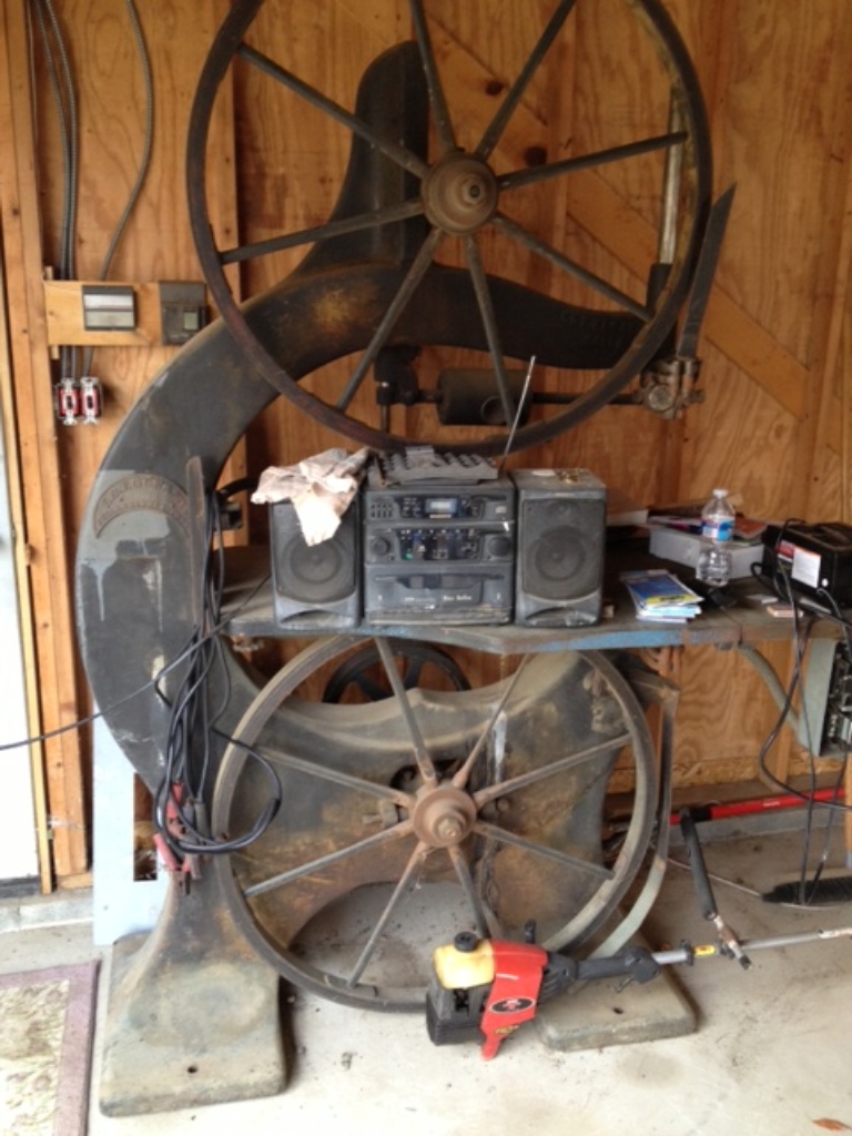

    i've got this old bandsaw that i'm going to strip and sell the C frame. would that work for you?

    Actually... I really want the whole SAW! I'll PM you...

  28. need louvers ?
    Joined: Nov 20, 2008
    Posts: 12,903
    need louvers ?
    That saw looks exactly like the frame Kiwi Kev started with.
  29. Now that is one kick ass cool band saw....I would take it in a heart beat.
