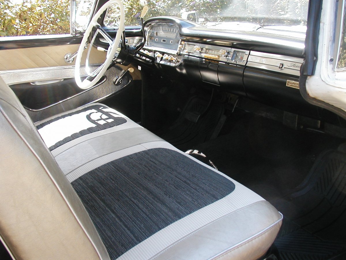

  7. I think you'll find the 56 seat is just a bit taller floor to bottom seat cushion. I can get you a height measurement tomorrow out of my 59 if you like.

  10. P1010167.JPG On the leading edge just before it comes around the corner the Welting is 9" to the floor and the top of the cushion is 10" to the floor. Hope this helps ya.
    Spooky likes this.

    Awesome thank you. I found a site that has the interior shoulder and hip width dimensions for the 56 and 59. The 56 is actually wider by a tenth of an inch. So they should work. But I definitely didn't think about the height. Thanks for this measurements I'm gonna check it now.
