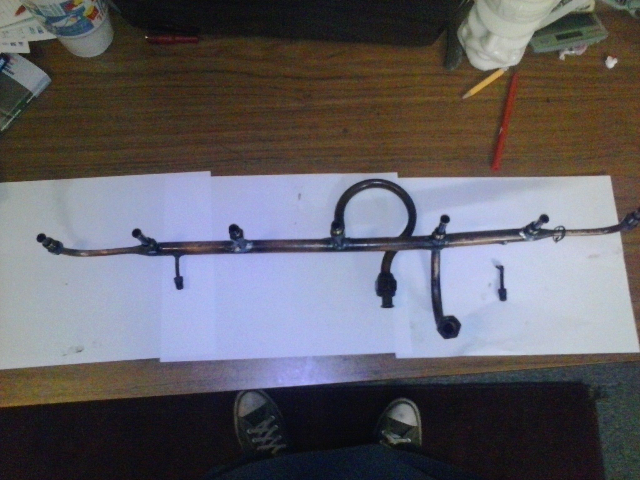

    Heres a picture of the line. My only concern really is would the JB Weld itself break down in the oil? I have it soldered good outside the car but once its up into the engine it may need to flex to seat properly and the solder might break like before. My soldering irons would not get it hot enough to do a damn thing but the small butane torch worked great. Im a little more than apprehensive about using the torch right below the crankshaft. THIS GOES INSIDE THE CRANKCASE. If this was a problem roadside the engine would have catastrophic failure. There would be no way to tell this was a problem until it was too late. Luckily I caught this in time. The small feed line running to the rear valve tappets was broken clear off with a gap between it. A few of the main bearing lines were loose but were able to stay in place while the whole unit was attached.

    Why would you be concerned about soldering near the crankshaft?, am I missing something here?

    Im concerned about using the torch near the oil soaked parts and the babbit bearings

    Why not solder up a new tube. You have all the fittings.

    X2. The new pipe would be a little more forgiving. No to JB inside the engine. Great for outside the engine or transmission. Just my .02

    Could you take a small strip of copper or brass and solder on some sort of reinforcement at the joint where this broke? You could heat it up with the torch as much as needed to make the repair, then put it in the crankcase.

    I don't know if the fittings are SAE or METRIC, but the part looks like it should be fairly easy to reproduce in more modern and stronger materials. If you don't have the time at the moment to make another one, you should at least take many pictures from several different angles, take accurate measurements, and build another when time allows. Or have someone with the specific talent to do build it for you. I think the epoxy would do what you expect of it, but what IF it did't? If it's somewhere that you can keep an eye on, that's one thing, but when it's out of sight..................................like inside an oil pan, that's another story. Butch/56sedandelivery.

    FWIW, I've soldered an similar copper oil line fitting on a greasy block under a wet pushrod cover and there were no problems with fire. I did it just like I was doing house plumbing and its held so far after 3 years and 3500 miles. Looks like you got it apart and ready to reinstall, but do you have to sweat another fitting on there once its in place?

  24. it looks like the branch tubes are just soldered at the ends, can you make some "T"s so the tubes would fit into them and you could sweat them like water pipe in your house? all you would need is the correct compression fittings and not use the nuts just solder it.
    OR just use the nuts and use the compression fittings.

    If you are concerned about the solder joint breaking cut a triangle of copper and solder it across the two tubes for support. Oil is not gas and it will not explode or burn rapidly without a wick or being atomized.
