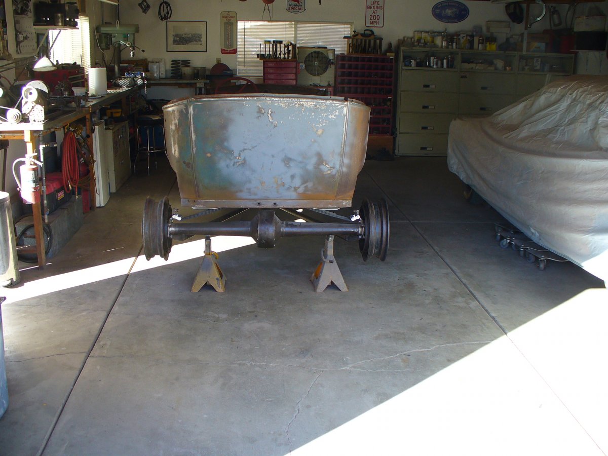

    tub 001.JPG I recently brought home the remains of a 29 Phaeton. I'm in mock up now, and have installed a 40 rear end that measures 59 1/2 inches flange to flange. The Model A rear end measured 57 inches. I had envisioned using 35 Ford wire wheels, but they are 4 inches wide. They look fine for the front, but appear skinny and too far away from the body in the rear. I would like to add and inch or so to the inside of the rears to better accept 700-16 Firestones, and close up the gap. Does anyone know of a person that bands wheels to increase their width? Here's a picture from the rear of the car. Thanks View attachment 4569909

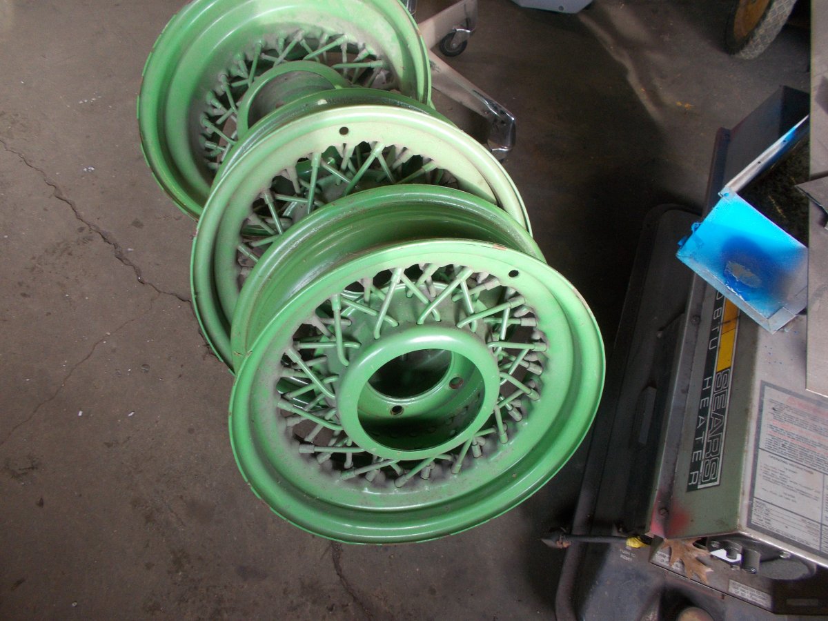

    Got these, made by "vintage , vintique ?" bent spoke wires this fall...
    they use the same spoked rims and weld in the bolt pattern you ordered...
    15" x 4.9" and 15" x 8" not what you want but they are making them...

    I have to wonder if a little creative measuring/machining in the areas pointed out by the arrows wouldn't allow for the complete installation into a larger (16/17/18") rim that was also wider. Getting a big/little look with wires and saving some money in the process. Might even leave the welds exposed for a homemade look rather than trying to conceal them. Don't know if it would work since I don't have any wire wheels to measure.

    I met a restorer who said he had a Phaeton that wasn't worth fixing. It was cheap, and it had paperwork. I'm afraid I will never out grow hot rods... tub 002.JPG

    I'm 73 years old, and have never outgrown Hot Rodding. I saw this add on Craigslist and decided to call. The seller was a very nice man, who was technically over his head. He asked me several times if I was sure about this purchase. He said "you know this is almost not worth saving, it's so much work, and they make reproduction bodies"
    A car like this Phaeton is a blank canvas. Anything you do to it is an improvement.. Here' a picture of the other end of the car. I disguised a Mercruiser motor, and installed an early drive line, with other vintage stuff . tub 003.JPG
