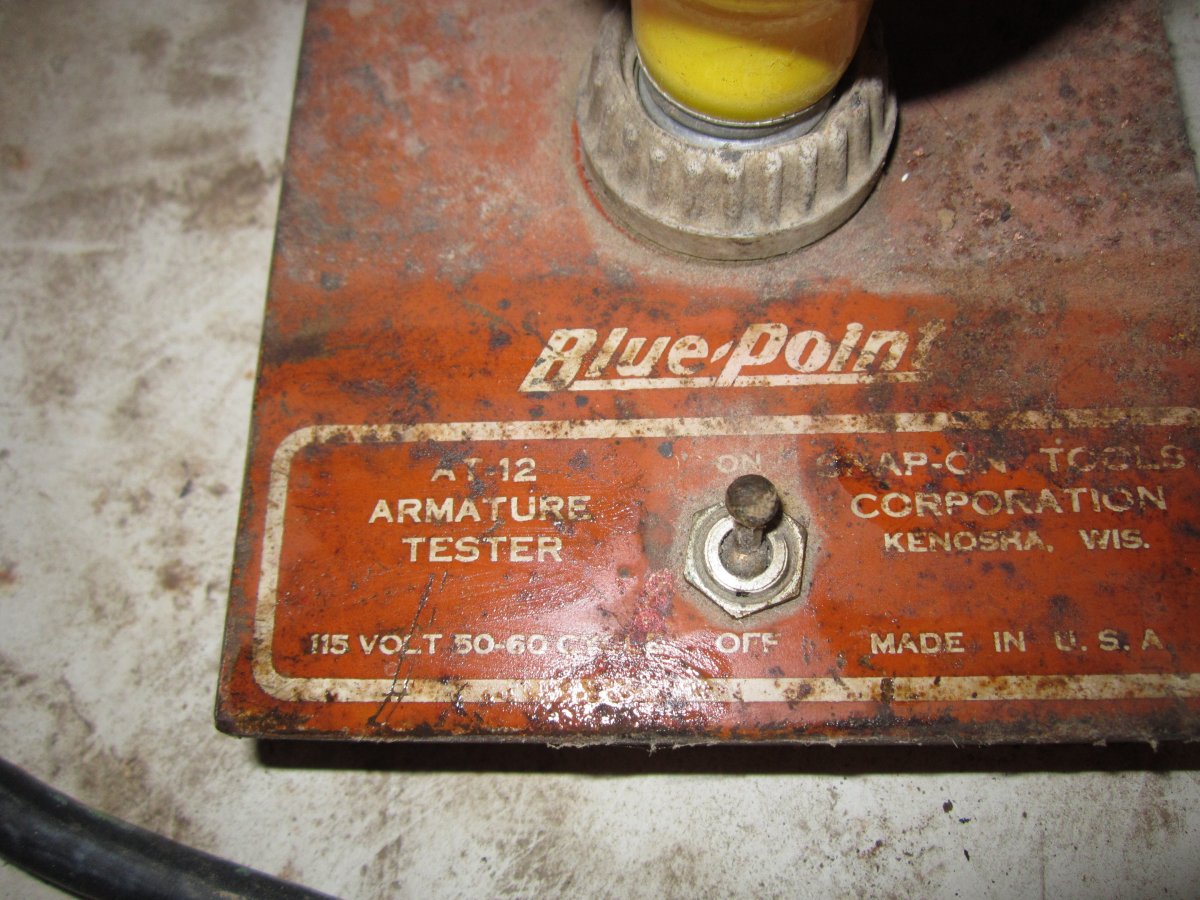

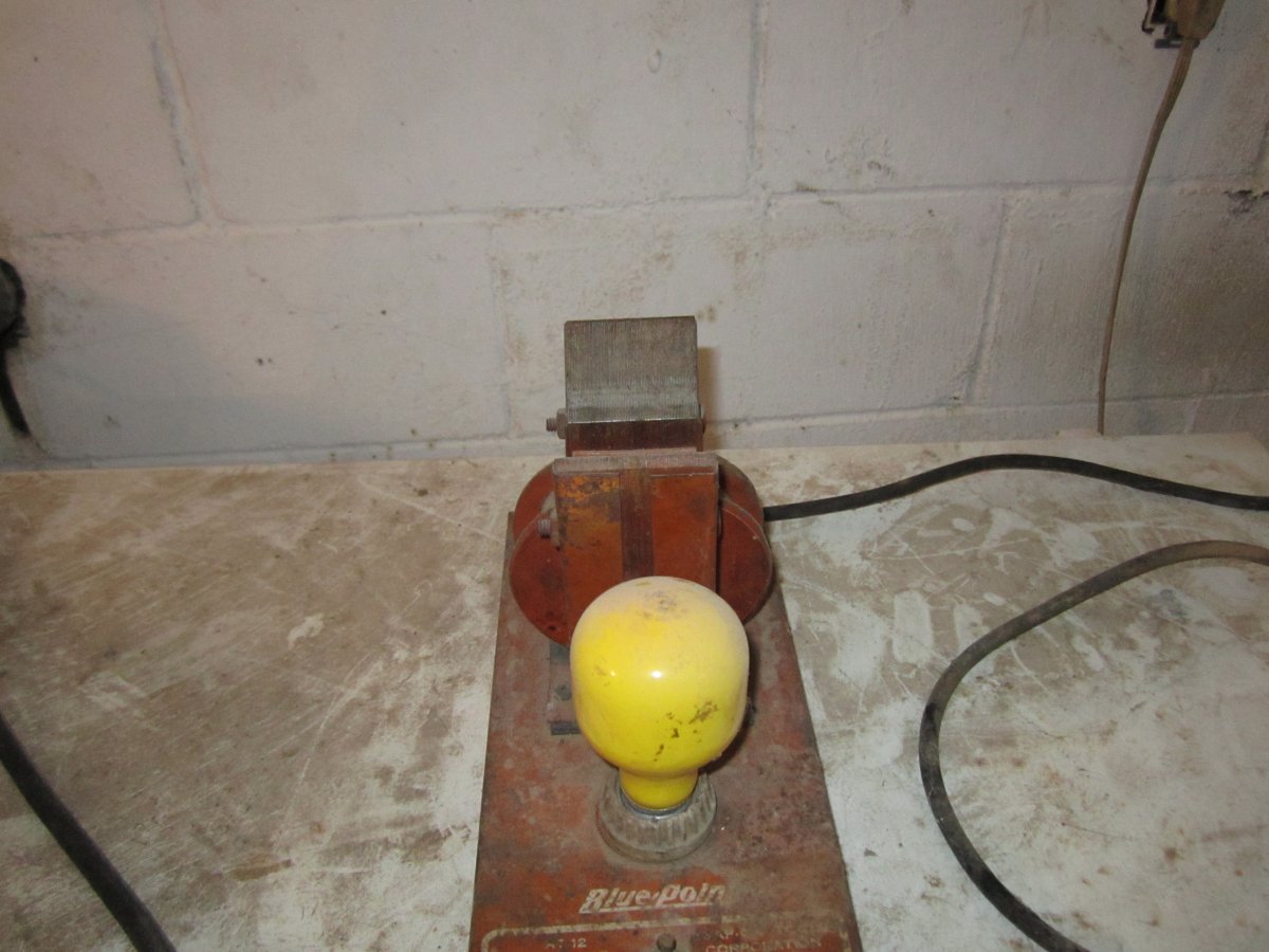

  15. I haven't ever bought a New or rebuilt starter ever. Ive got a armature tester. a huge number of old starters and a lot of bushings and brushes. I take junk starters apart. Test the armature on my old tester. test the field coils by hooking a battery to them. And field coils can be wound right or left so you need to pay attention. And I fix all of armature tester 001.JPG armature tester 002.JPG my own starters. Ive even made bushings from rigid copper tubing
