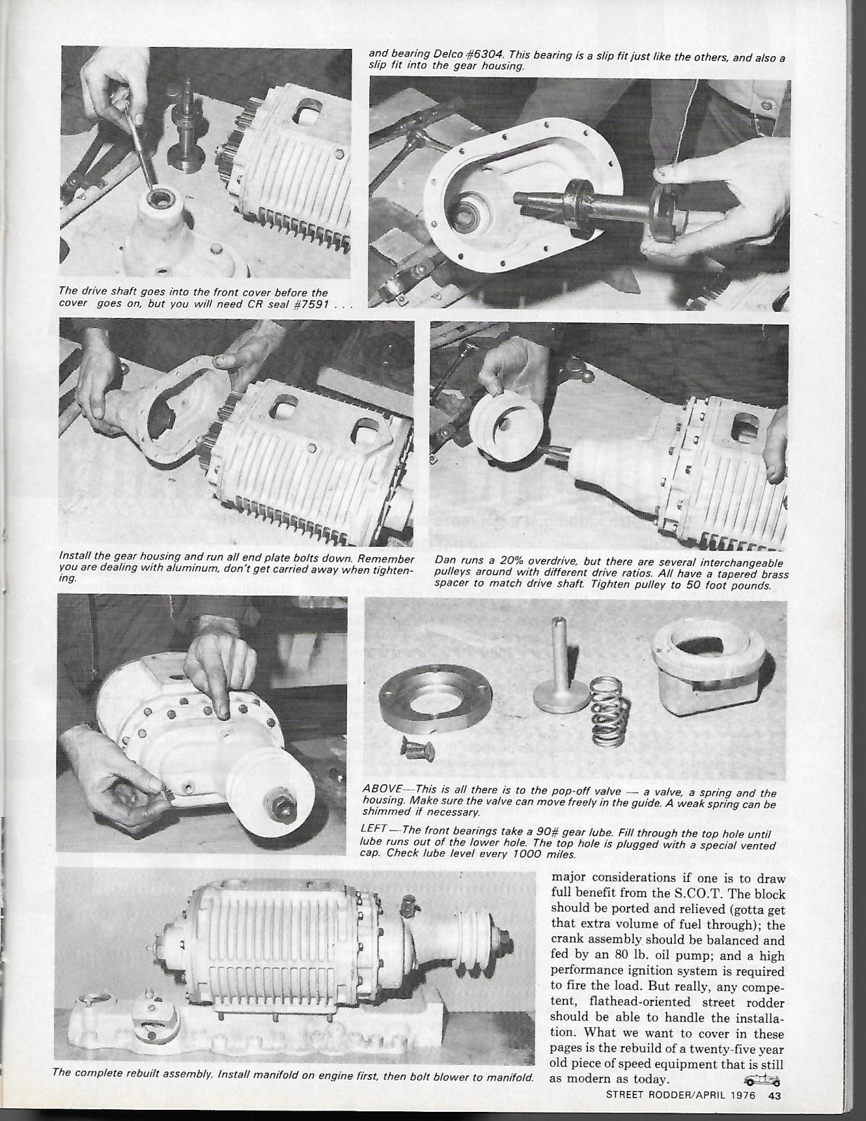

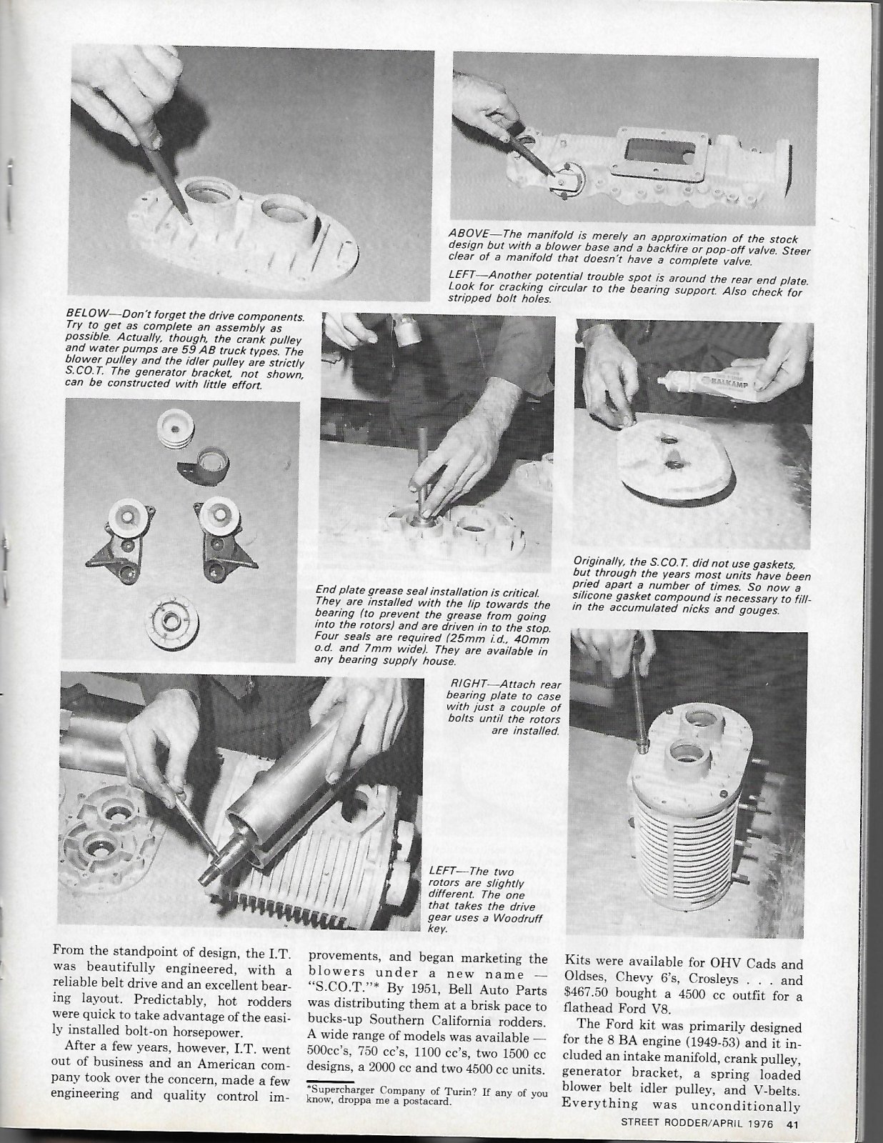

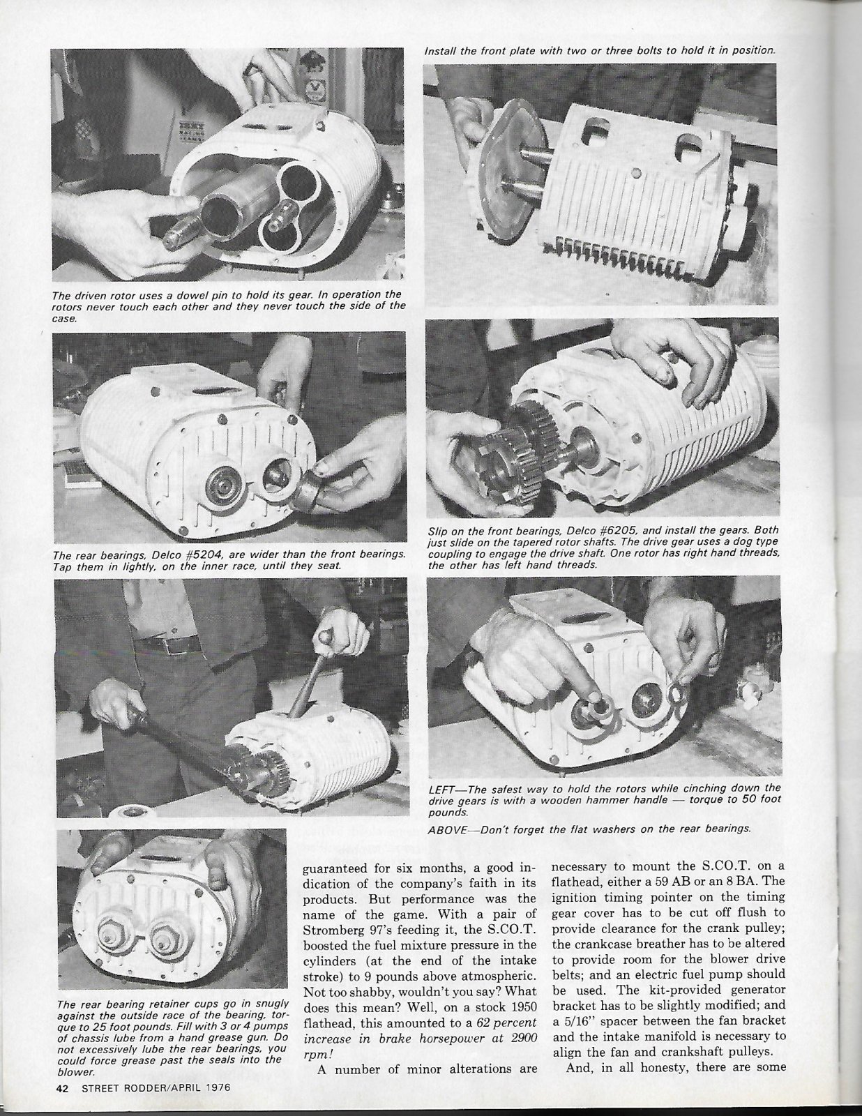

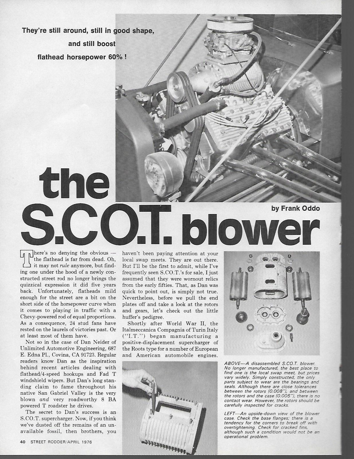

    It looks relatively easy to rebuild one, here's an article with part numbers and the necessary steps. Compared to a GMC blower with it's helical rotors the SCoT should be easy, there is no rotor timing to set. You can get new bearings and seals from any well stocked bearing supply house. This is assuming your case, rotors and gears are in good shape.
