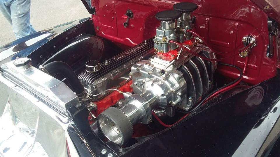

    6 w blower.jpg I have a little 235 in my. 51 five window.

    That's pretty. Tell us about the blower setup. 6:71? Underdrive/overdrive? cfm's?

    Looks to be 4-71. Nice job! Nice front snout. Is it hard to get the belts lined up correctly?
    Looks like an oil line is plumbed into it.

    Actually, looks like the fuel line going into a finned aluminum filter with the red plastic line coming out to the fuel block on the firewall. Always loved the red lines.

    The 4-71 is running a 35 top and 32 lower drive gear for a 8.6:1 under drive. The 94's feed about 400 CFM and the engine had the compression reduced to 7.5:1. Running a 5 speed with 373 gears in the rear. The whole thing makes for a comfortable highway run with the ability to cruise at 65-70 mph in 5th at 22-2400 rpm. When I need to pass 4th gear is right there. Haven't had it dyno'd yet because I'm still trying to sort out some of the inevitable little issues that come with any build.

    Great looking truck!

    Vary Sweet looking Ride.

    You reduced the 235's cr to 7.5? I thought that was a pretty standard ratio for those engines through most of their life.

    jimcin, Nice, well thought out plan.

    I think when I was researching it, the compression for a 60 truck 235 was 8.25 or 8.5

    Thanks for the info on the 235 cr. I never knew it went over 8:1. All stats I've ever seen say 7.5:1.

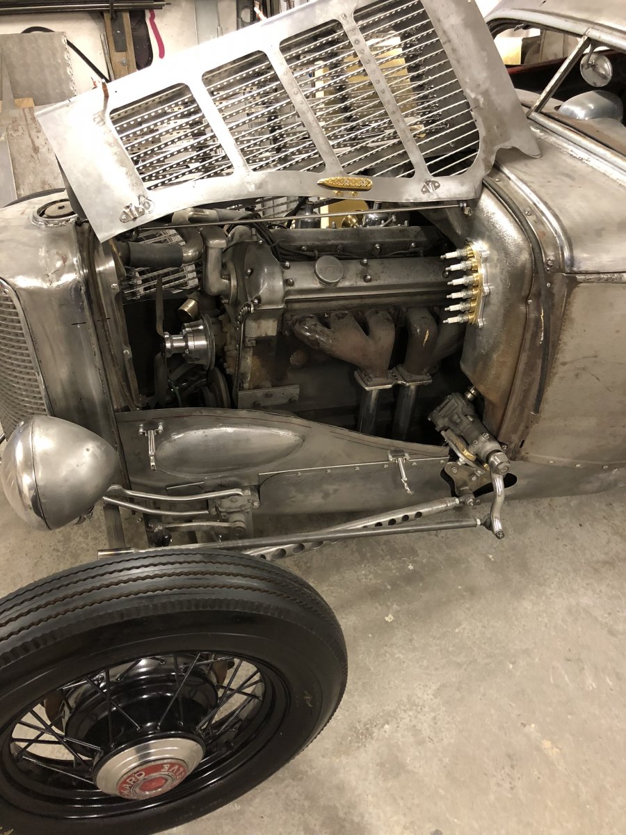

    I’ve got a 1952 jaguar engine in my model-a coupe

    Sweet rides, FrankenRodz and Hot Rod Punk. =)
