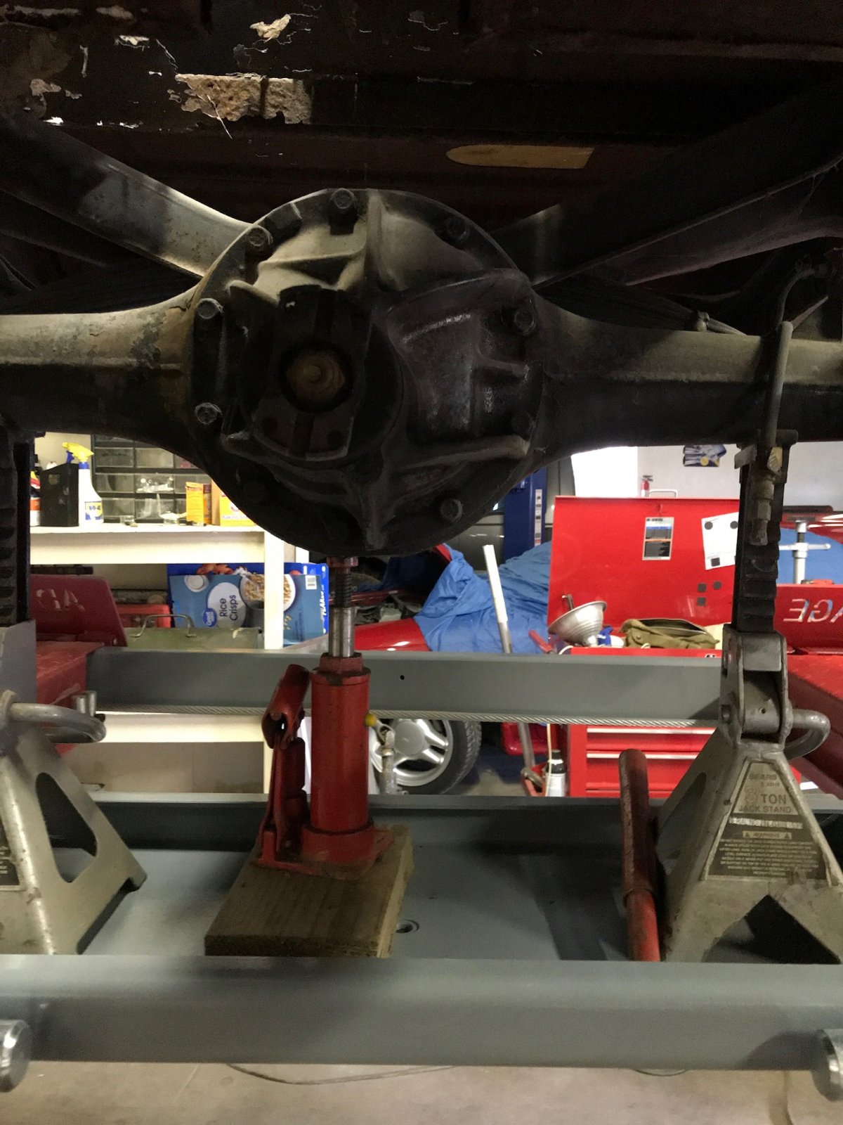

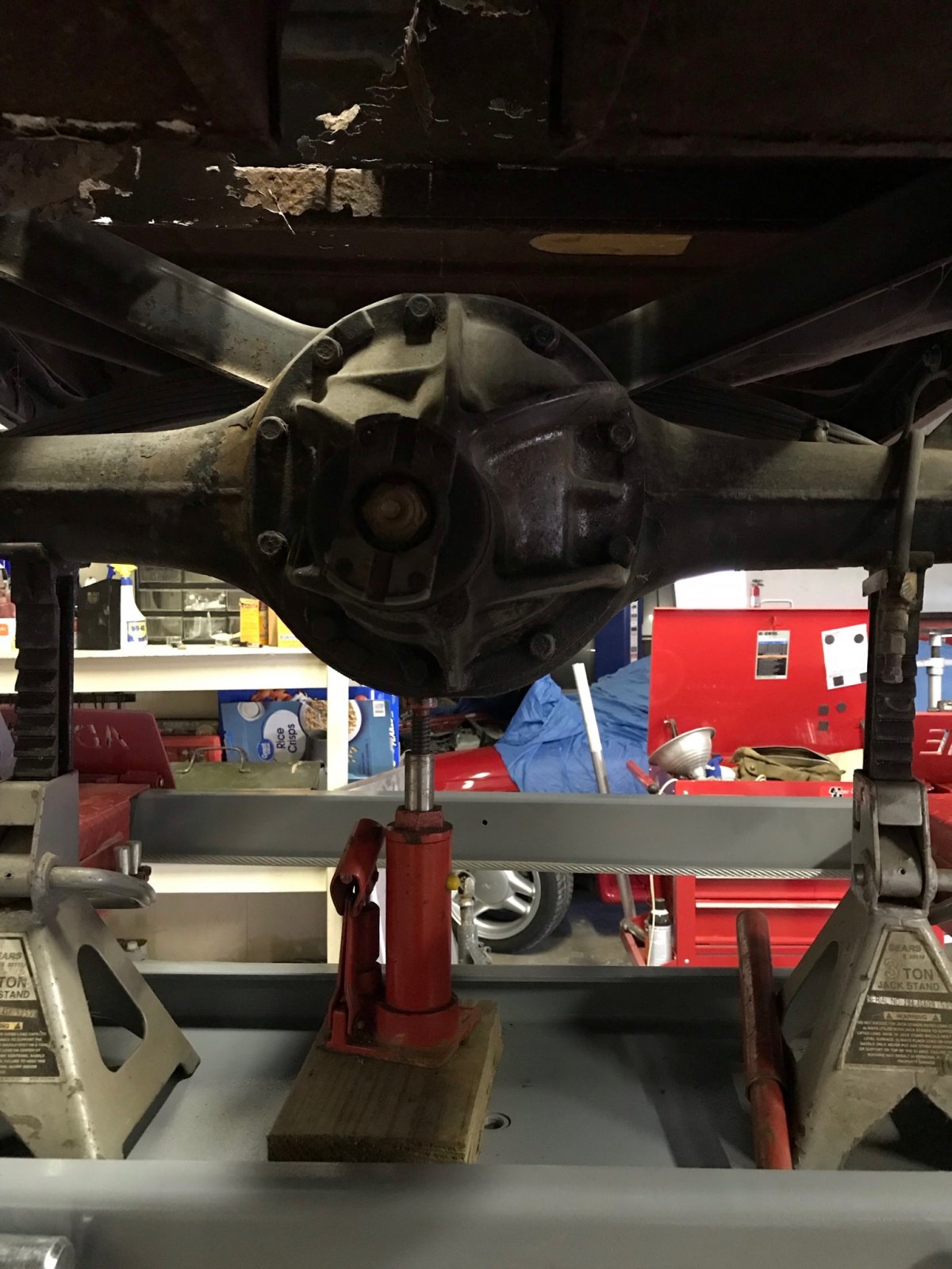

    Trying to figure a date on this diff, its olds/pontiac. Originally thought 57-58 because the carrier is round and not slightly oblong (at least by my eye) although the flat style yoke is 55 or 56 and older. Has sway bar mounts like olds...idk if the pontiacs had sway bar mounts as well? 20211112_135352.jpg 20211112_133704.jpg

    Definitely early like my 46 with that style pinion flange and centre, not a big Olds.

    Clean it up and look along the bottom between the bolts for some stamped letters and numbers. Some of them have final build info stamped in. That may only apply to the ‘57-‘64 units but it can’t hurt to look. Post photos of all cast in and stamped numbers that you find.
    They are all good strong rear ends but ratio choices are slim for the ‘54-56 rears and parts for all of them are getting harder to find.

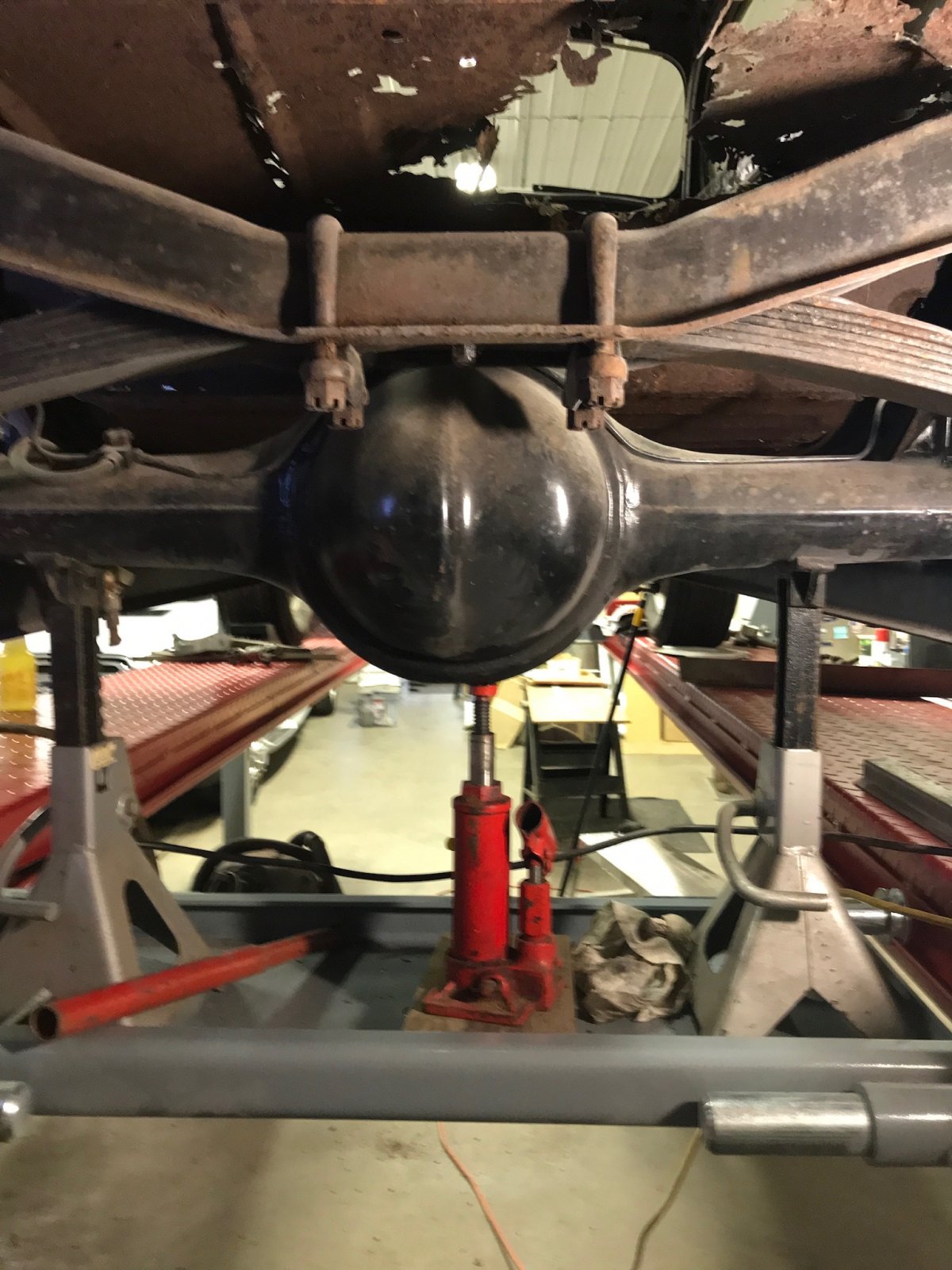

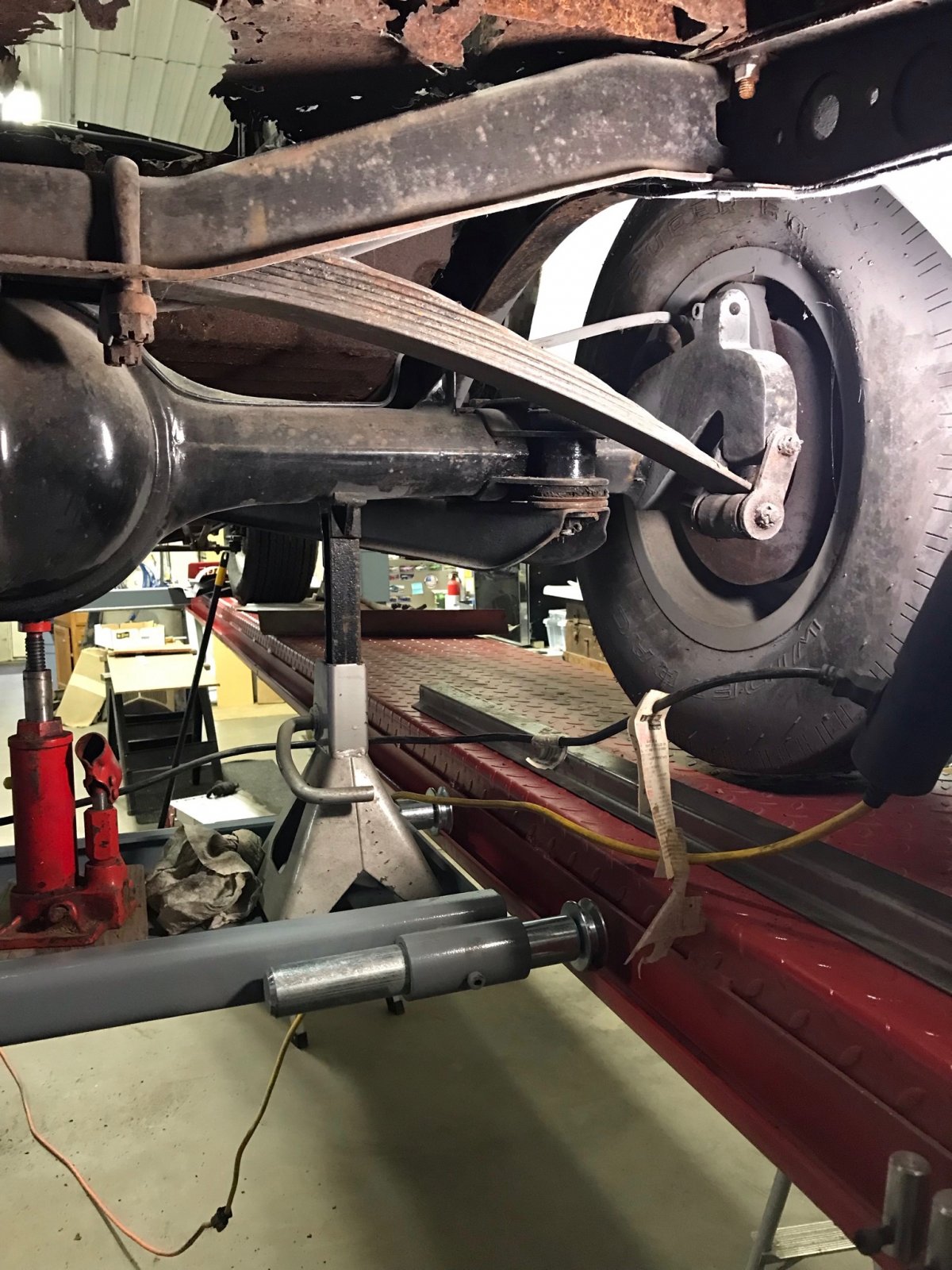

    That rear looks like mine. This one has a 5x5 bolt pattern, massive hangers to adapt it to the Ford buggy spring, and some sort of disc brake conversion.
    It’s about 59” flange to flange, so probably too wide for a 36.
    Also has trailing arms mounted to the axle . They have deteriorated rubber bushings.
    Any idea what this is from? No numbers that I could find.
    I will probably take the cheap way out and narrow an Explorer or Fox Mustang 8.8 if this thing isn’t fashionable...

    The car’s 2200 miles away, so I won’t be finding numbers until May. I did look previously, and didn’t see any, but you know how that goes.
    The car seems to be a late sixties or early seventies project that someone started and abandoned. I think that the Olds rear was more popular than the Ford 9” back then. The work was lone late enough that disc brakes were a thing. Brake lines were run on the axle, but not on the chassis, based on the long lengths of raw brake tubing that was laying inside tha car.
    This rear has trailing arms that are (from memory) about 40” long and shaped like an inverted U channel. They are mounted to what look like factory clamps welded to the axle and have a couple of rubber. isolation bushings. I suspect it was originally coil sprung in the as- manufactured configuration, but the arms are a lot shorter that the Chevy of the late fifties and sixties, and I don’t see signs of coil mounts. The arms aren’t homemade.
    I don’t have a good handle of when Olds and Pontiac switched to coils.
    Again, I think the rear is, to some extent, period correct (except the disc brakes). If parts aren’t available, though, or there’s no easy way to narrow it, the 8.8 is probably the next option.

    If you look closely at the third picture, you can see an upper and lower formed plate, each welded to the axle tube. There are rubber bushings between the upper and lower plates, and a couple of bolts holding the trailing arm .
    the trailing arms are stamped, tapered , inverted U shaped with a pivot on the front end.
    I am curious as to the original application.
