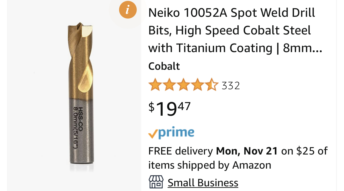

    I bought this kit earlier in the year and it works great. I have over 200 spot weld cuts on a single bit, and the kit comes with 3.
