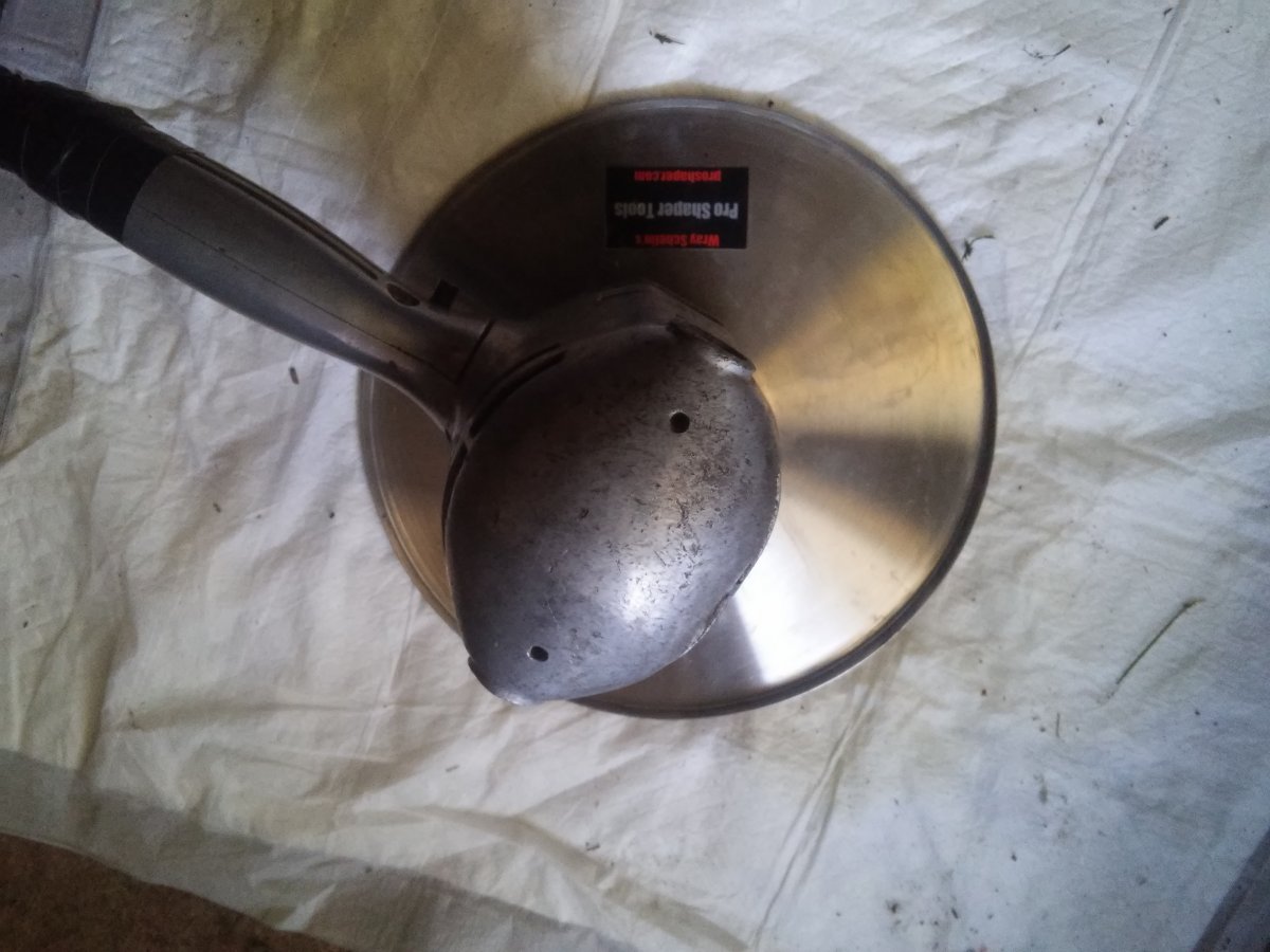

  12. Used my "pro shaper" disc last night
    Works great. As Dead flat as it is on both high and low crown panels. It's tricky on concave areas and you better be paying attention.
    It Depends on what the panel wants for the disc to work, a little heat and air moves moves the panel a bunch IF that's what the panel wants. Lots of heat and water with steam sometimes won't move it BECAUSE the panel wants something different.
