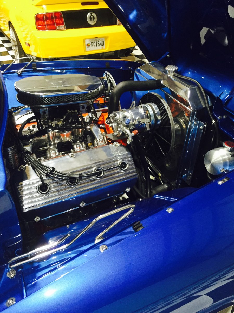

    I have put 425 Olds engines in two old F100, lots of room and torque to spare. If you can
    find a decent FE that would be first choice however.

    from Area 51
    From a practical stand point, any of Ford engines mentioned would be a good option. For appearance, a physicaly large Ford engine sure looks good in that big old engine bay.
