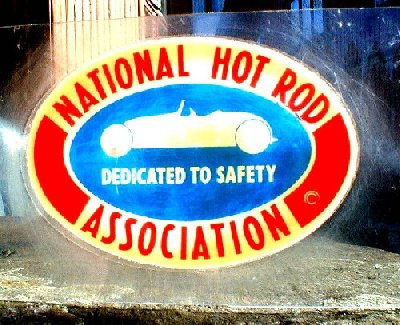

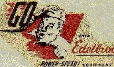

    Yep !! Make Yr own [​IMG] [​IMG]
  9. klazurfer
    Joined: Nov 21, 2001
    Posts: 1,596
    klazurfer
    next up [​IMG]
