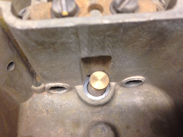

    The clearance prob is the obvious one...the other problem is that the sealing surface on late Holley PV is in the wrong place where it contacts carb. This area has to be remachined...some people have gotten a seal where the taperd surface intersects the gasket, but this is pretty chancy.

    the flat surface that it needs to seal on and the clearance issues in side the bowl
