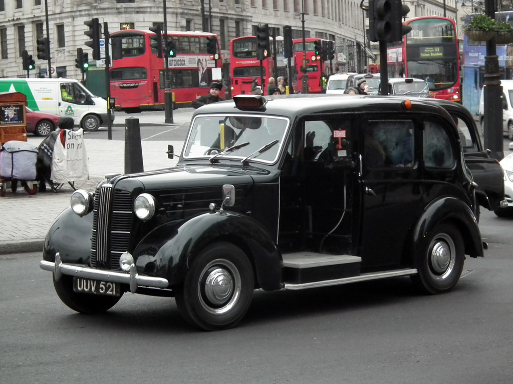

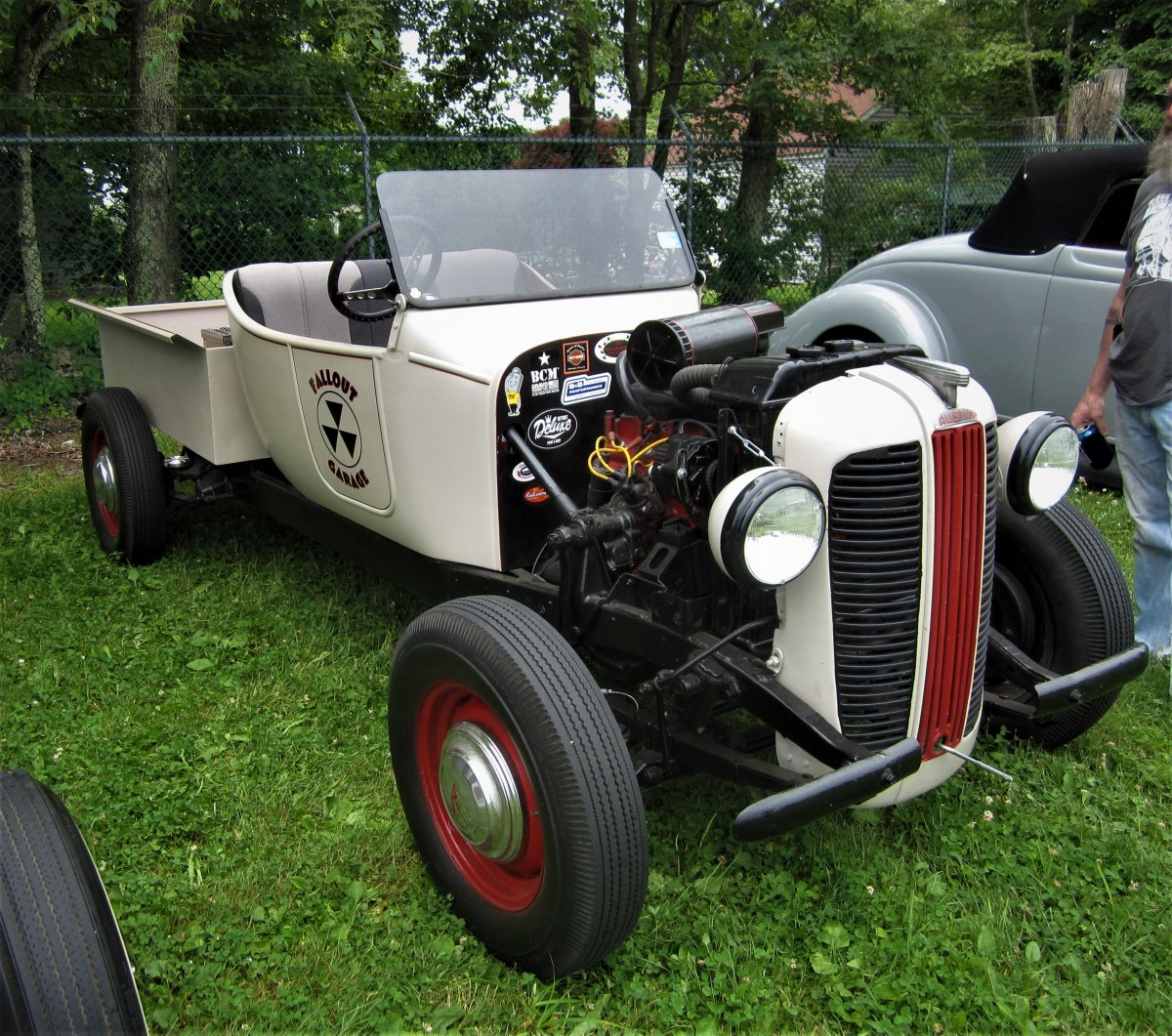

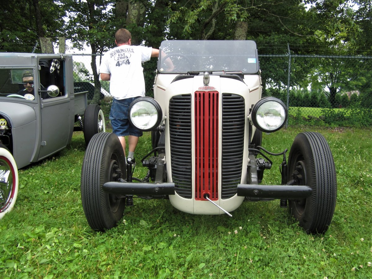

  7. Pretty sure the answer is in the rumble in the country #16 thread ct1932ford posted yesterday. He posted two pics of a little hotrod that looks like its made with lots of mid 1950s Austin FX3 taxi parts and late 1940 A40 parts. So just imagine the pic BigR posted with bumper overriders and then again without. Also helps that i have owned said Austins in the past. Austin hotrod..JPG Austin hotrod.JPG Austin FX3 taxi.jpg FX3 taxi.jpg 1958-Austin-FX3-London-Taxi-.jpg
    Discusion is still open.

  9. If that isn't the bumper it's real close. HRP

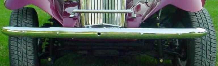

    Maybe MGTD rear bumper without the bumper guards?

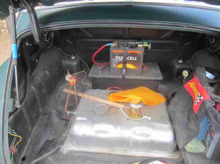

    BTW, I measured the front bumper and it looks to be about 60 inches. As you said, the rear fenders have been widened so that would make the rear bumper also about 60 inches also. Somebody did a lot of work to make those fenders wider, to fit the bigger meats. The body is not tubbed; if you look at the trunk area you can see the original sides. Notice what looks like an upside down gas tank, with the yardstick fuel level indicator, I assume. What's in the box under the battery? Why they went to the trouble of widening the fenders and then leave the old filler cap on the left side is a mystery to me.
    The more I look at the pics the more confused I get. I'll have to cruise the local cruise nights to see if I can locate this puppy again and ask some questions.

    If they are from a MGTD you could run the front one on the rear and the license plate would cover the crank hole and run the rear one on the front. When I had my TD I dealt with Moss Motors on Goleta, CA. I can't remember the guy in customer service I dealt with but he was very helpful. He was a car guy - looking for a early to mid '60's truck last time a spoke with him after I sold my MGTD and told him not to waste money on sending me more catalogues. You might give Moss a call and get some measurements from them BUT their parts aren't cheap. Good luck.

    Check this out: Magic Classic Motorparts has bumpers for replica kit car MGs. They have three different widths. 52 1/2", 55 1/2" and 60 3/8 inches. I measured my car and the widest one would fit on the front, and one of the others on the rear.
    No idea of this company's reputation or quality, just throwing it out. Moss Motors has stuff, too, kinda pricey.
