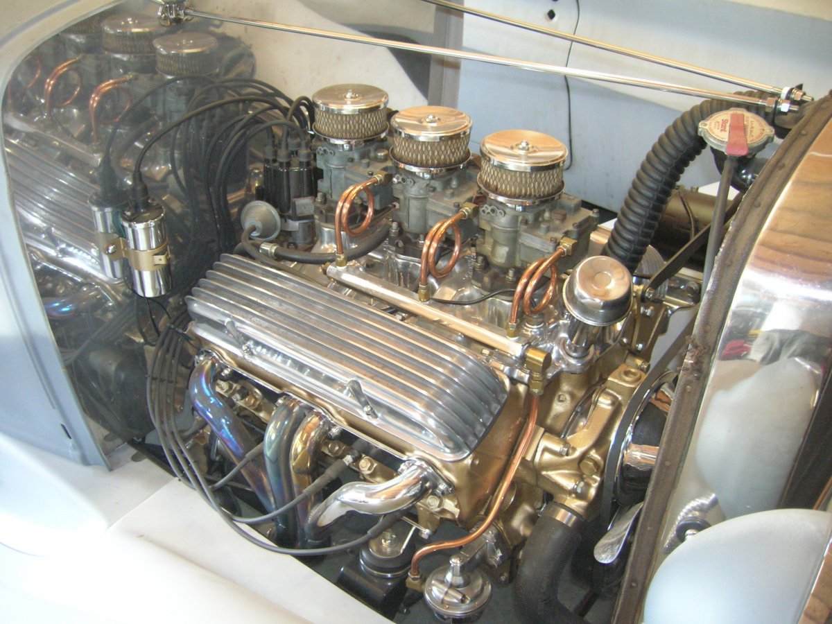

    Steffen, if you could get someone to loan you a set of old Hedman Tri-Ys, any good custom header guy/fabricator could duplicate them by building a simple fixture on a bench top. The head flanges were just 1/4" x 2" hot rolled steel with the ports drilled using a hole saw. The tubes were 1 1/2" OD and the outlets were 2". When I went to work for Hedman (many years ago) we were still making some of the 1950s part numbers.
    I built a slightly updated set for my Model A sedan because I always liked the design. (I used slightly more sophisticated flanges)

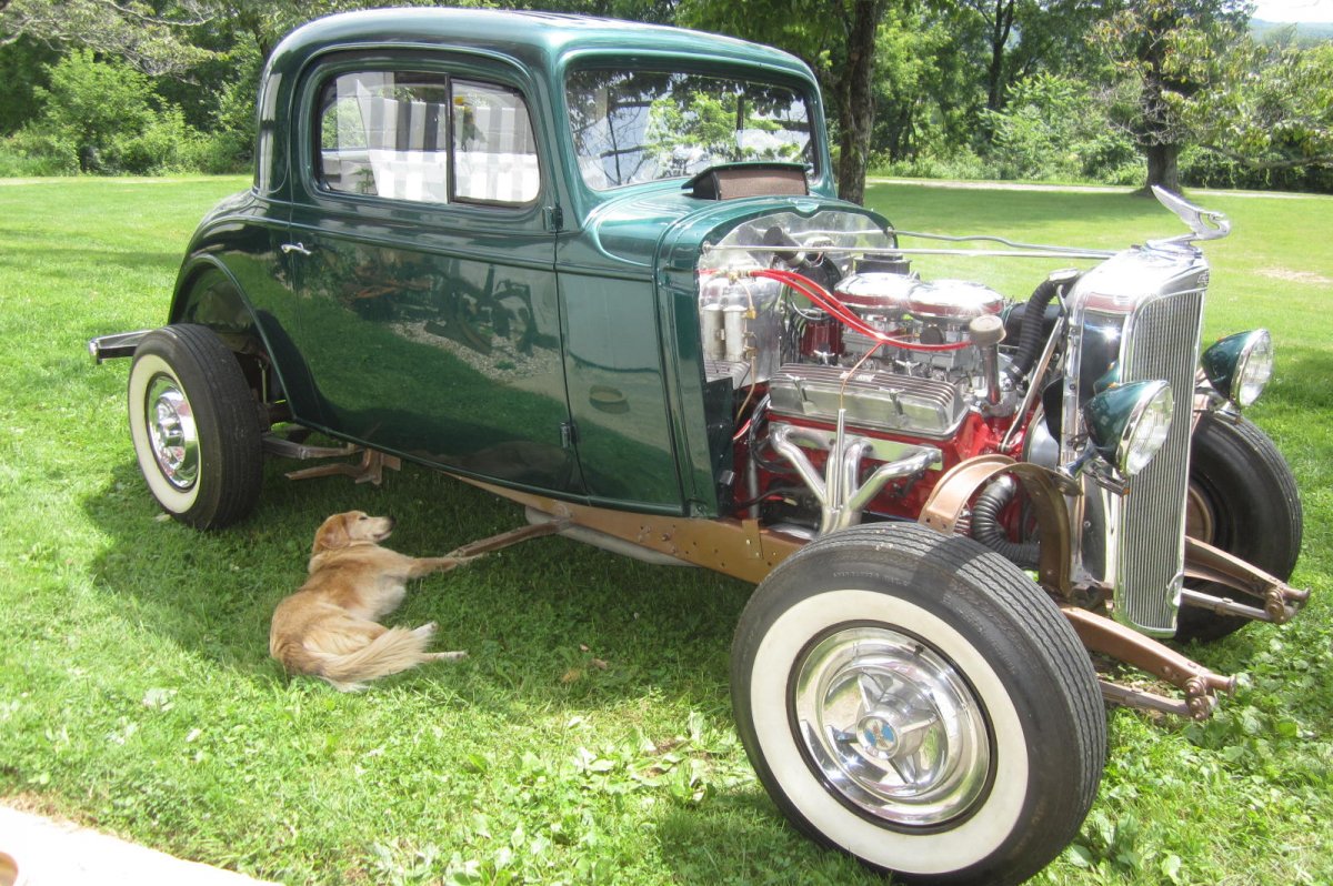

  23. my dad bought these in the late '50's. hedman headers for a sbc. before i cleaned them up. DSCF3809.JPG DSCF3810.JPG
  24. the driver side was modified to clear the steering box.
    turboroadster and Steffen Jobst like this.
  25. driver side: DSCF4203.JPG
    cactus1 and Steffen Jobst like this.

    Tb33anda3rd, someone did a bunch of modifying on those old Hedmans over the years, stacked generator brackets, a zig-zag and those bitchin' cut-outs. Great score. They look great on your coupe.

    Mr. Tb33anda3rd, is this a 3-window Chevy coupé?
    I like the 4-leaf-spring design. And it's always nice to see that someone is not changing over to Ford front ends.
