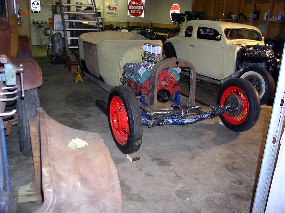

    don't know if it'll help but,
    here's a snap of Eric's (CGkidd) '19? Touring front half on the chassis and his spare cowl in the forground
    looks a lot like yours
