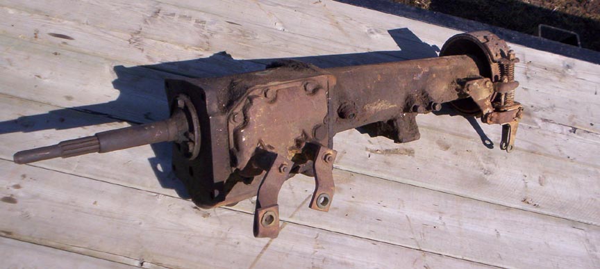

  1. This trans came with a pile of other stuff. I have no clue what it originally fit. With the rear parking brake band, I'm guessing pre-war car or a pickup. Any thoughts guys?

    Hard without a pic. Maybe Chrysler?

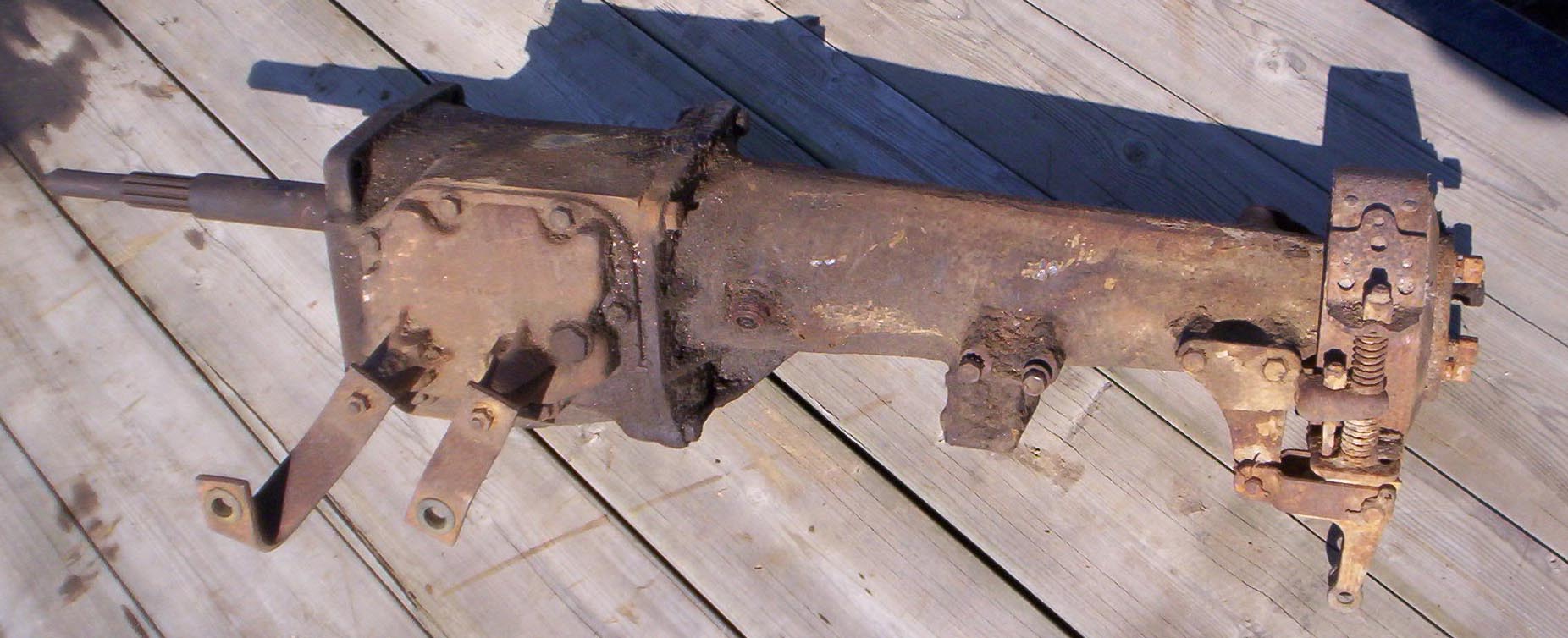

  4. Fixed it...pictures didn't attach for some reason the first time
  5. I would guess Prewar plymouth column shifted 3-speed
  6. Dodge/Plymouth

    Not necessarily that old, since Mopar was still using drum parking brakes on the back of transmissions well into the 60s
    Look for numbers...they can be helpful.

    Long input says "Fluid Drive" mopar to me.

    Yea, looks like early Mopar

    I'm thinking there was one with the long input shaft that is the hot ticket when you want to swap out a fluid drive. I want to say around 53/54 Dodge truck but I'm not sure.
  11. I don't know what it is, but I know it isn't a '54 Dodge truck...

    3 speed, non self shifting Dodge Fluid Drive from the forties - early fifties. Also used on a few DeSoto and Chrysler models, 1939 - early fifties.
