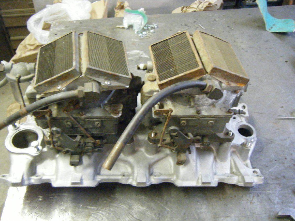

    This is why I'm a hoarder I always regret getting rid of things here the dual quad I traded off[​IMG]
    And here's a 3x2 I sold a couple years back. Never got to run eaither..
    I would kill to have eaither of these back right now..

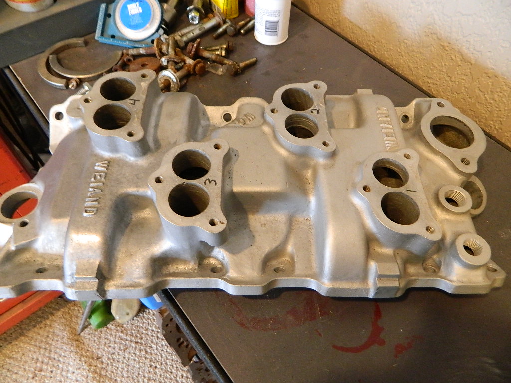

  9. The Weiand wc4d, 3 bolt carb bases.

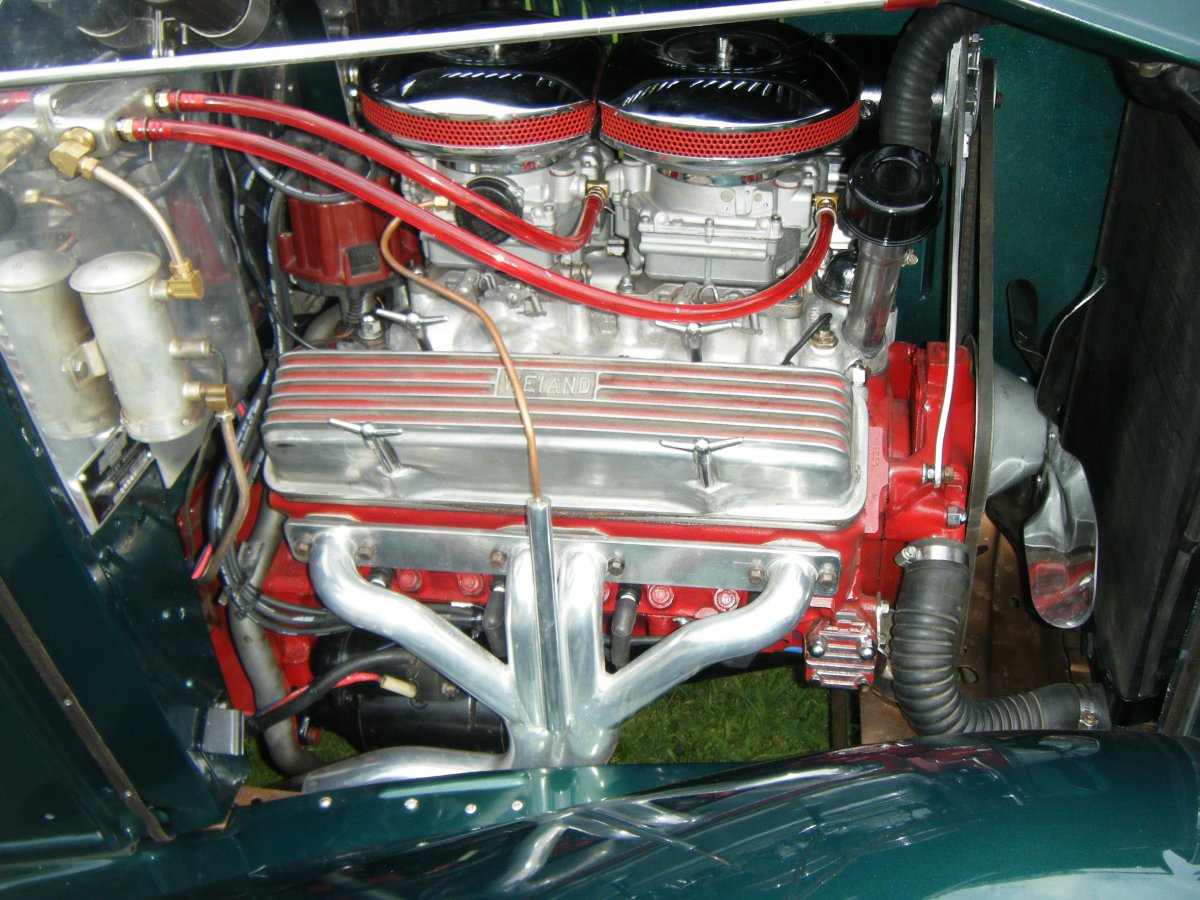

  13. Man-a-fre with 4 2bbls. The stuff dreams (and a few nightmares) are made of.
