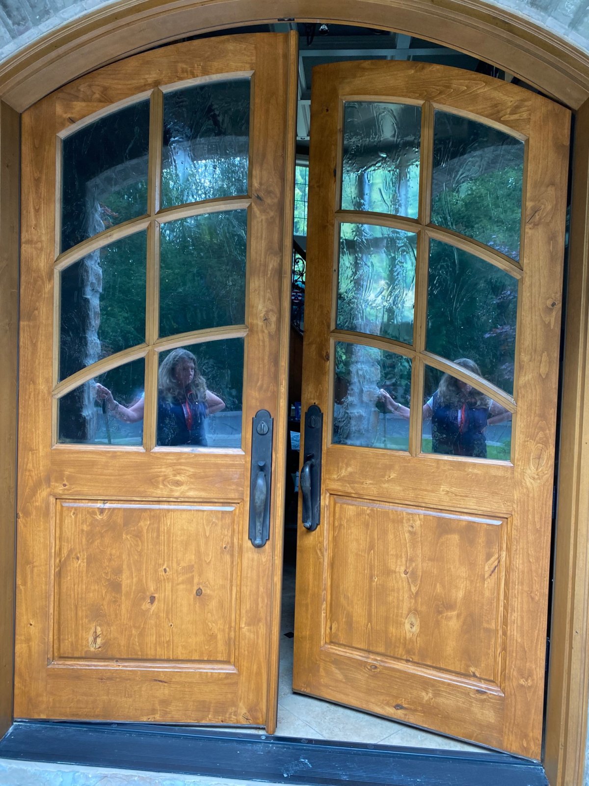

    When on come the rains I can feel the tell in my bones, this time of year we are on borrowed time and summer projects take precedence over the affairs of state...and car shows.
    My entry doors on the house are protected from the rain (unless it blows in sideways) but not the afternoon sun as the bottom halves evidence.
    I hate working with wood. It doesn't weld proper, shrinking discs just make it smell funny and it doesn't take body filler either. It is also tediously boring labor! I should have got to the doors last season, but life and cars got in the way.
    This is how they look after three days of sanding to remove the clear and the stain that was coming off. These doors cost a fortune, 17 years ago when I built the house and my wife doesn't want them painted. That would have been a lot easier and quicker and I know how to do paint. This is a lot like the bed wood in the PU. Next trick is to try to match the color as close as possible with stain.
    I thought I designed that entry deep enough to protect those solid knotty wood doors but you can see the sun lighting it up this afternoon exactly where they are peeling. And yes, I tried to remove them and lay them down flat on fender racks but after I knocked out the 4 hinge pins I realized the door outweighed me and I hung it back on the house.
    Do any of you have a suggestion for stain? I got a sample pamphlet from Corbet with colors in it, they have stain, and then clear, or a stain with UV clear already in it (one step). That sounds like the ticket but I have little experience with this stuff and I DO NOT WANT TO SAND THEM AGAIN!! Sorry, I need some advil and a drink.
    I plan to apply the finish by hand so I can match some surrounding areas with brushes/rags/ steel wool as opposed to spraying the everything. I'll take any advice...well not "any", it would be nice if the advice was helpful and polite.

    I grew up south of Seattle, and Dad always had a boat. The worst one was a 47ft Chris Craft with full mahogany decks and cabin. I still hate sanding.
    I’m out of date on modern wood finishes, and a lot of mine was indoor stuff. But for outside I’d be looking at deck finishes. More money, but more durable. Here’s a link on a woodworking site, that Corbet is pretty highly ranked, if it’s the same one. The other thought is trying the marine stores. “Marine” means they doubled the price, and there’s not so much wood around, but worth a look. I’ve also mixed oil stains to get color matches, but that is trial and error as you lay it down on the wood. Wood is wood, no two pieces the same. Good luck.
    https://www.woodsmith.com/review/best-deck-stain/

    You need to clean the door with Murphy's oil soap first, so that you can truly match the stain that is on them, then it might be wise to hire a professional to mix stain to match it and be sure to get extra stain mixed so you're prepared for the next time around!

    Color is not spot on but it's wood not a fender, still looks nice and it is protected from the weather this year.

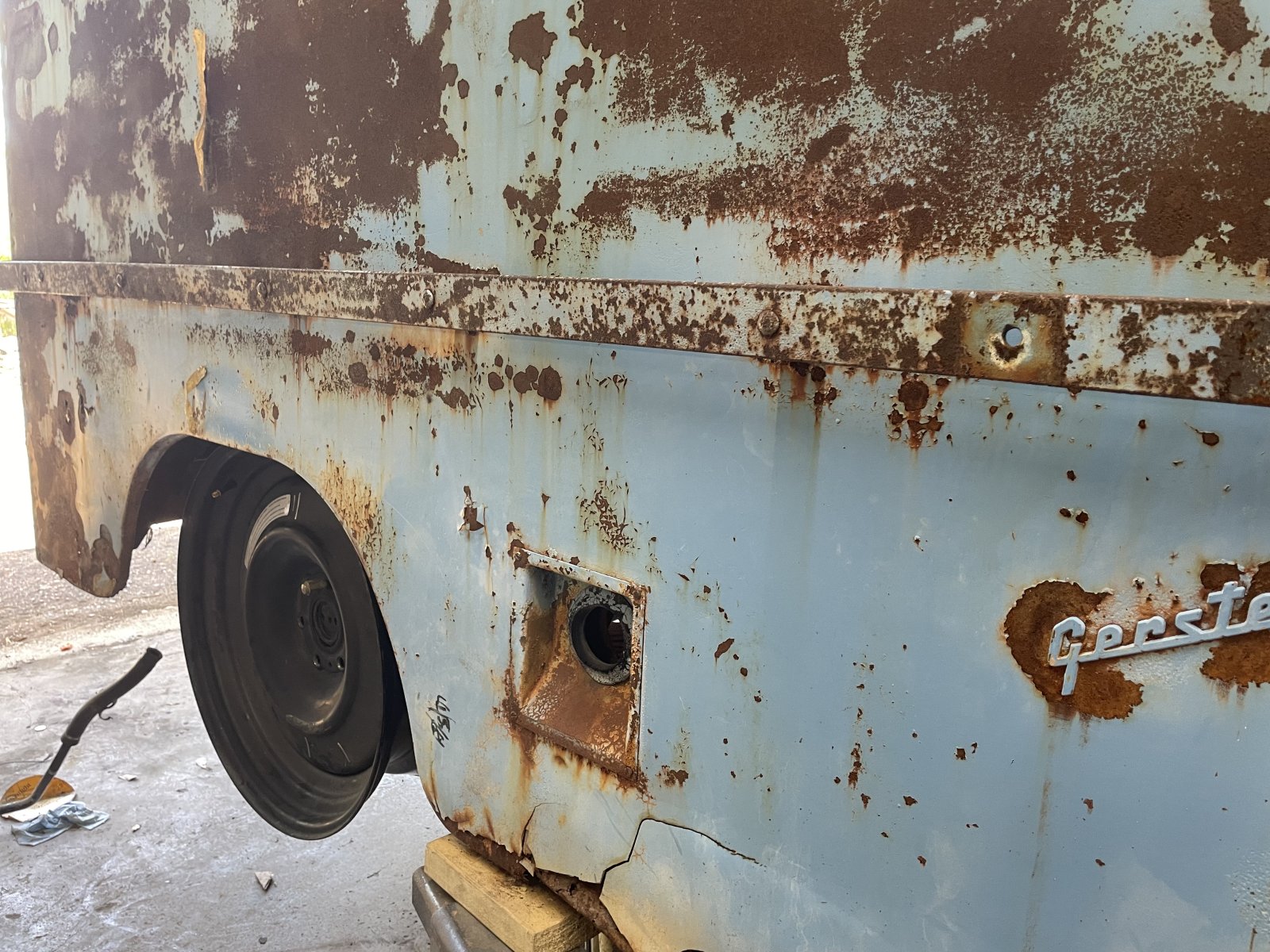

    This is another OT deal I work on regularly...was even on the local news a couple weeks ago...

    Ahhh ... a Gerstenslager .... my buddy Marvin's dad bought a '60s mail truck at PO auction - blown up 170 & Loadflite or Torkflite. Someone on his mail route gave him an Imperial to get it out of the yard. He had the 413 & TF in it in a weekend, hooked to the stock axle. He liked his Early Times, & liked giving rides ... I only took one.

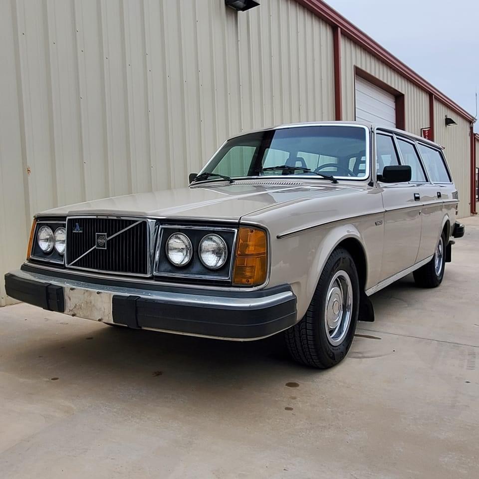

    went to the little swedish auto shop in Edmond and picked their brains on making power in the little 4cyl redblock in our 245… which we decided to keep all Volvo- but since it would
    just go from super duper slow to still slow- LS has been once again added to the menu ( that was the intention all along… ) really wanted that blueprint 4cyl but they wont make it- they just wanted to tease us all… oh well I do have a couple of angry LSXs on stands needing a car… IMG_6553.jpeg

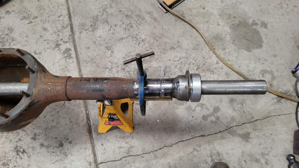

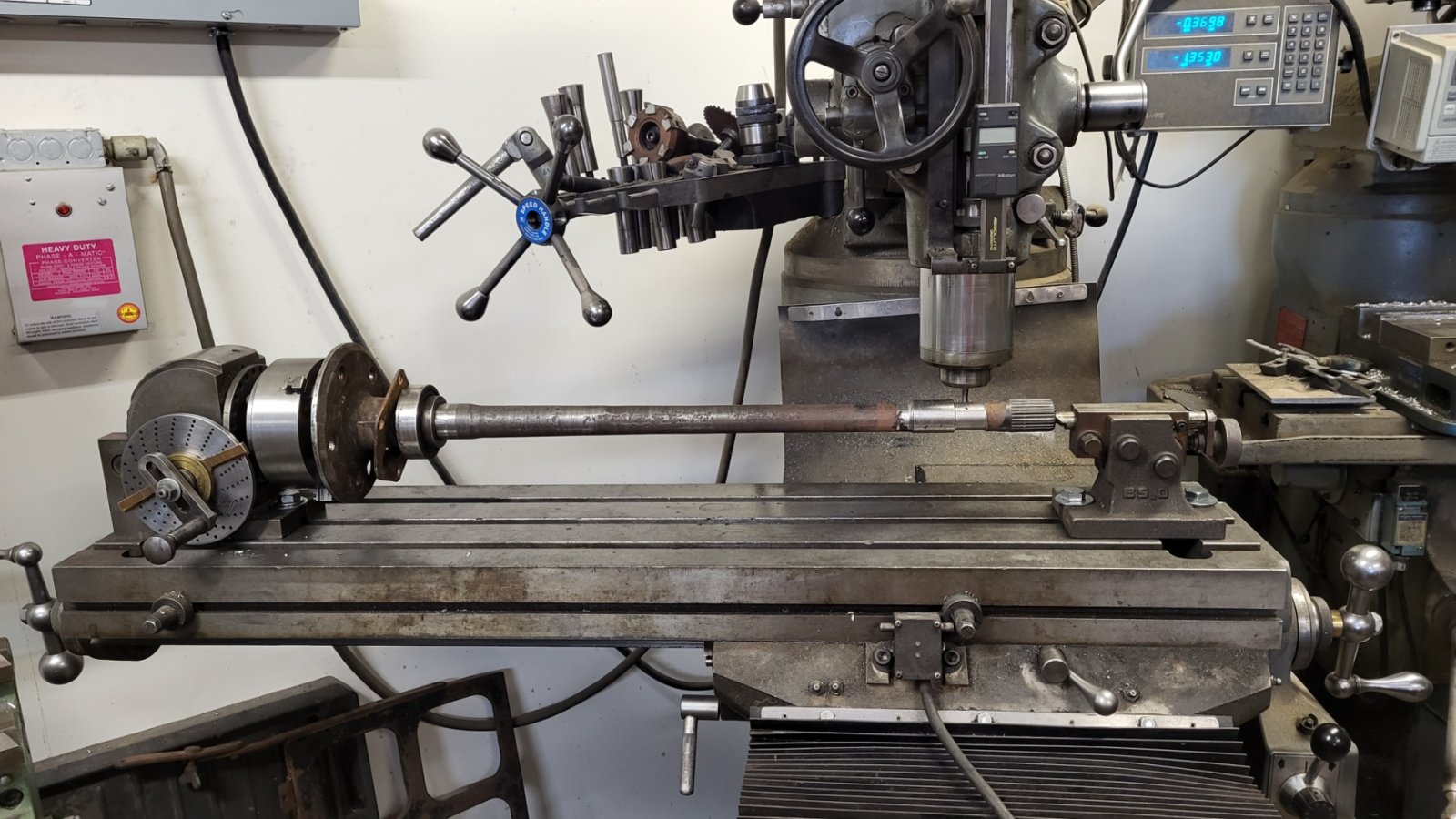

    I narrowed the Ford 8" rear end seven inches and then had to build up the axles to cut the splines. Resized_20240818_154750_1724450123488.jpeg

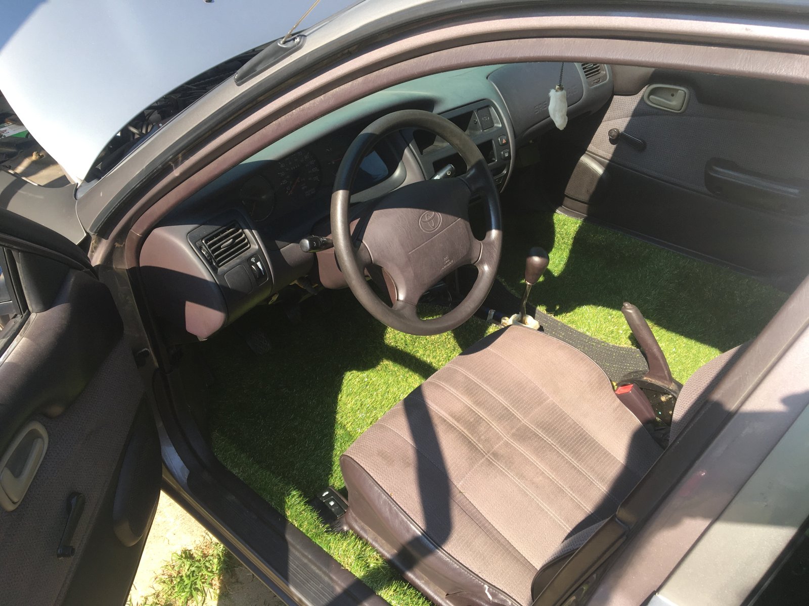

    Buddy wanted help on his beater. New suspension, steering, etc. He is one of those people with a unique? Vision on things. So we lifted his corolla a few inches this weekend, along with the other stuff. IMG_0575.JPG IMG_0579.JPG IMG_0580.JPG IMG_0581.JPG IMG_0582.JPG

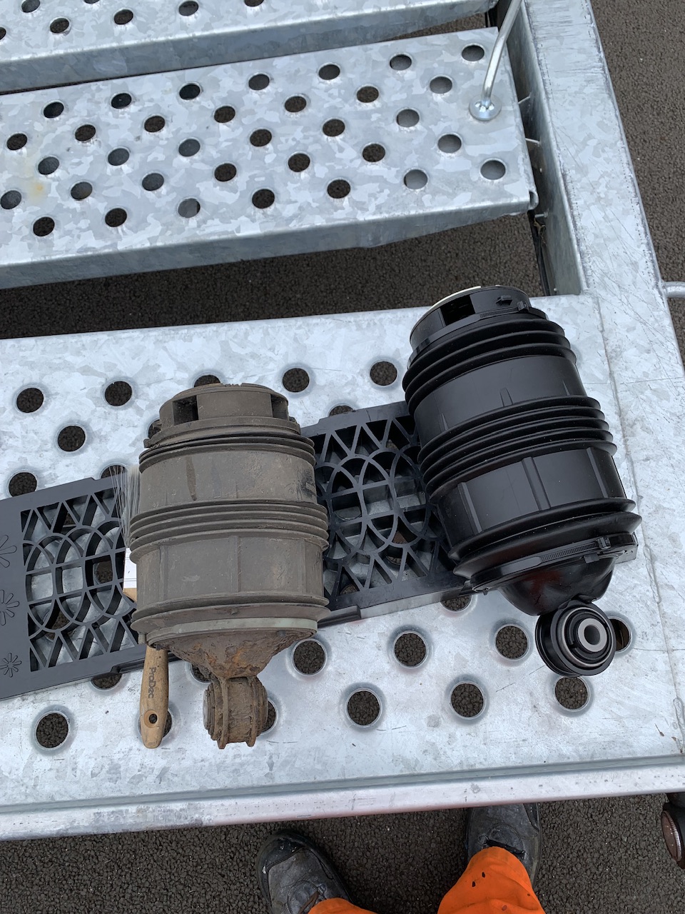

    Changing airbag on the daily Mercedes

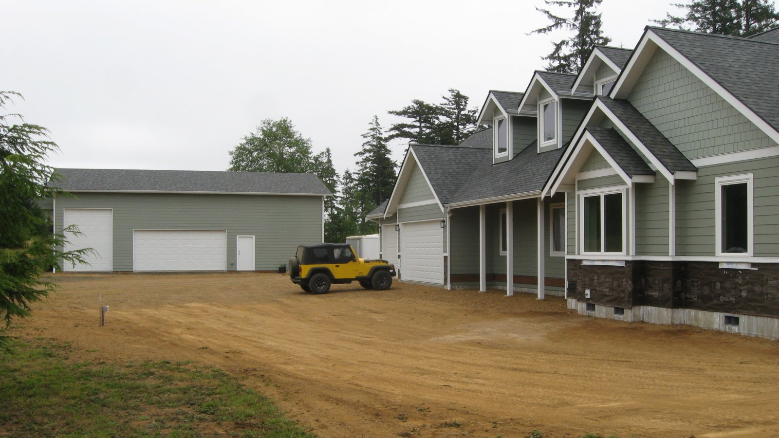

  30. Busy being the general contractor on our new house.
