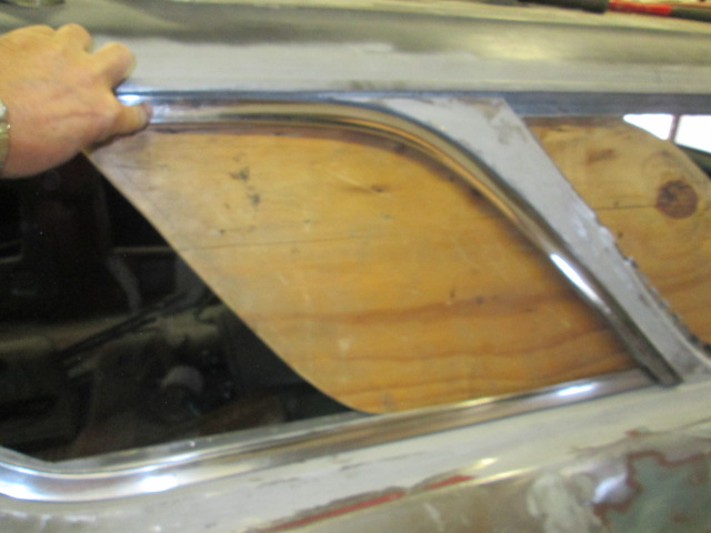

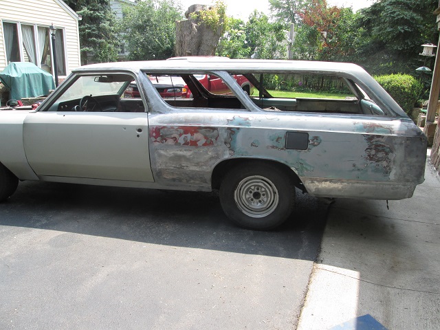

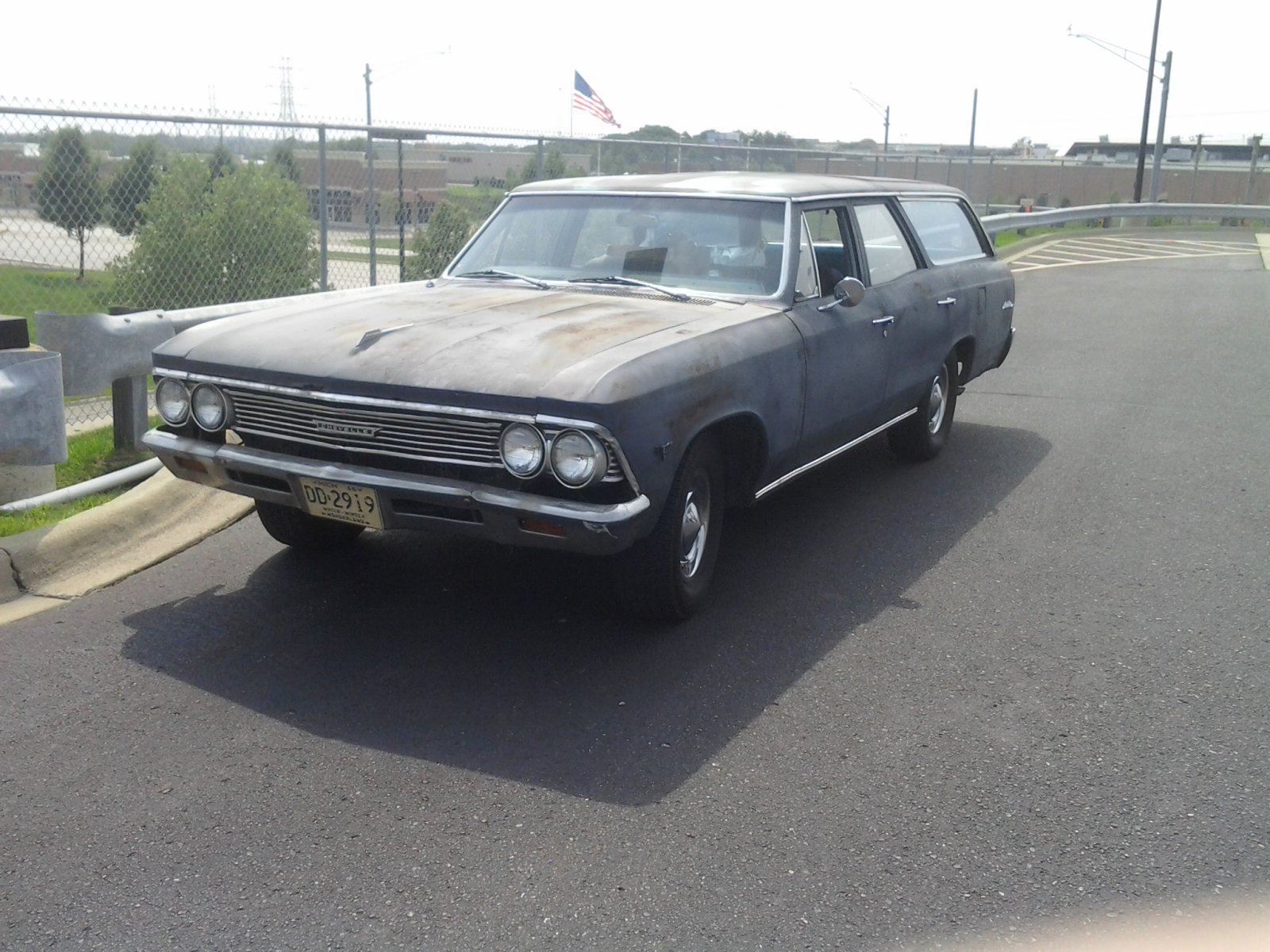

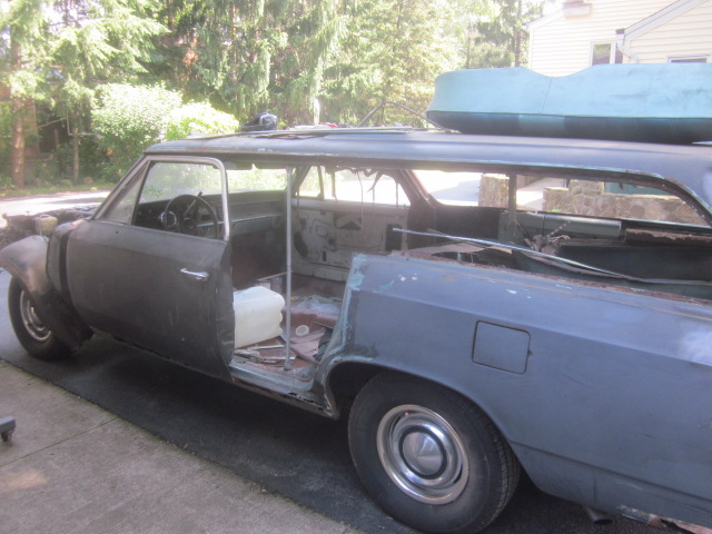

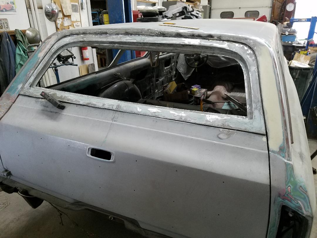

    Yes I did Billy, Next up is another favorite year car. I took a 66 Malibu 4door Wagon and am in the process of converting it into a 2door Nomad style build.

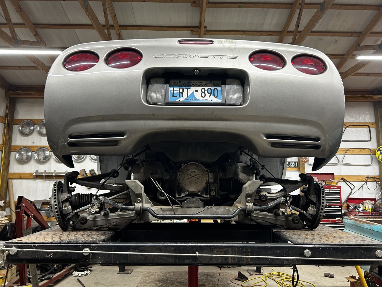

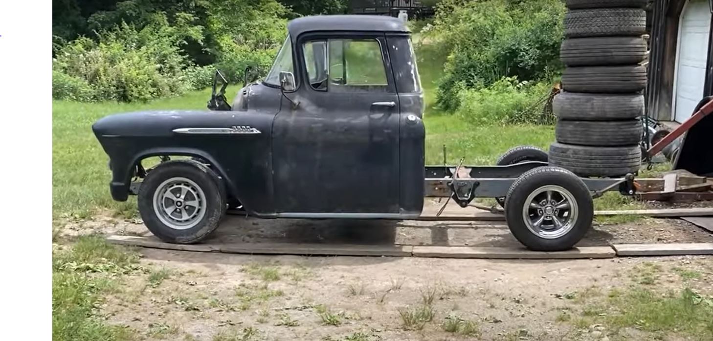

    Current low buck build, three trucks into one and ending up with a 1956 Chevy 1/2 ton short bed. Jaguar IFS, S10 rear and springs, ranger hangers, monte carlo driveshaft, 5.3/60e fuel injected, 4 wheel disc brakes, etc. $5000 budget for the full build. Tires on the back to simulate weight for suspension setup LOL.

    I didn’t even notice the leaning tower of tires until I read your comment. That is classic. :D
    That should be a real cool pickup on a budget. :cool:

    Thanks, should be a fun one, trying to use up parts I have around and keep the costs down.

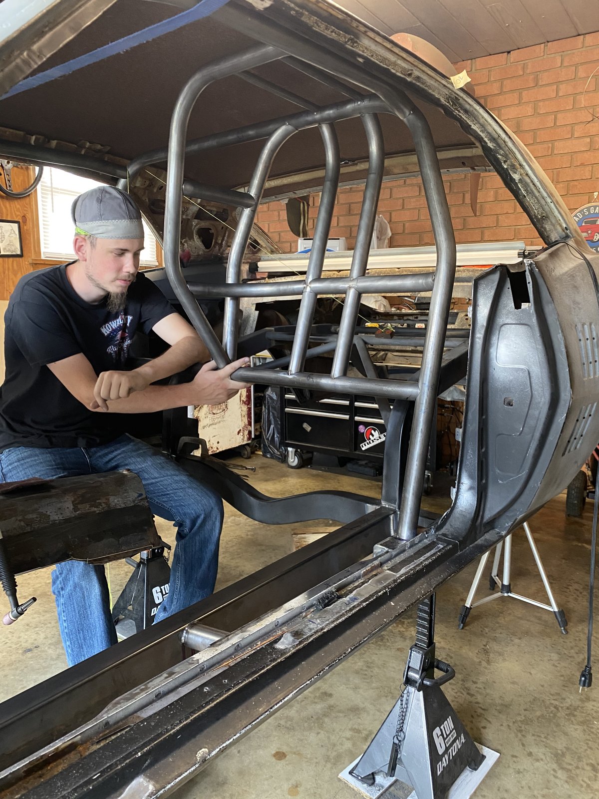

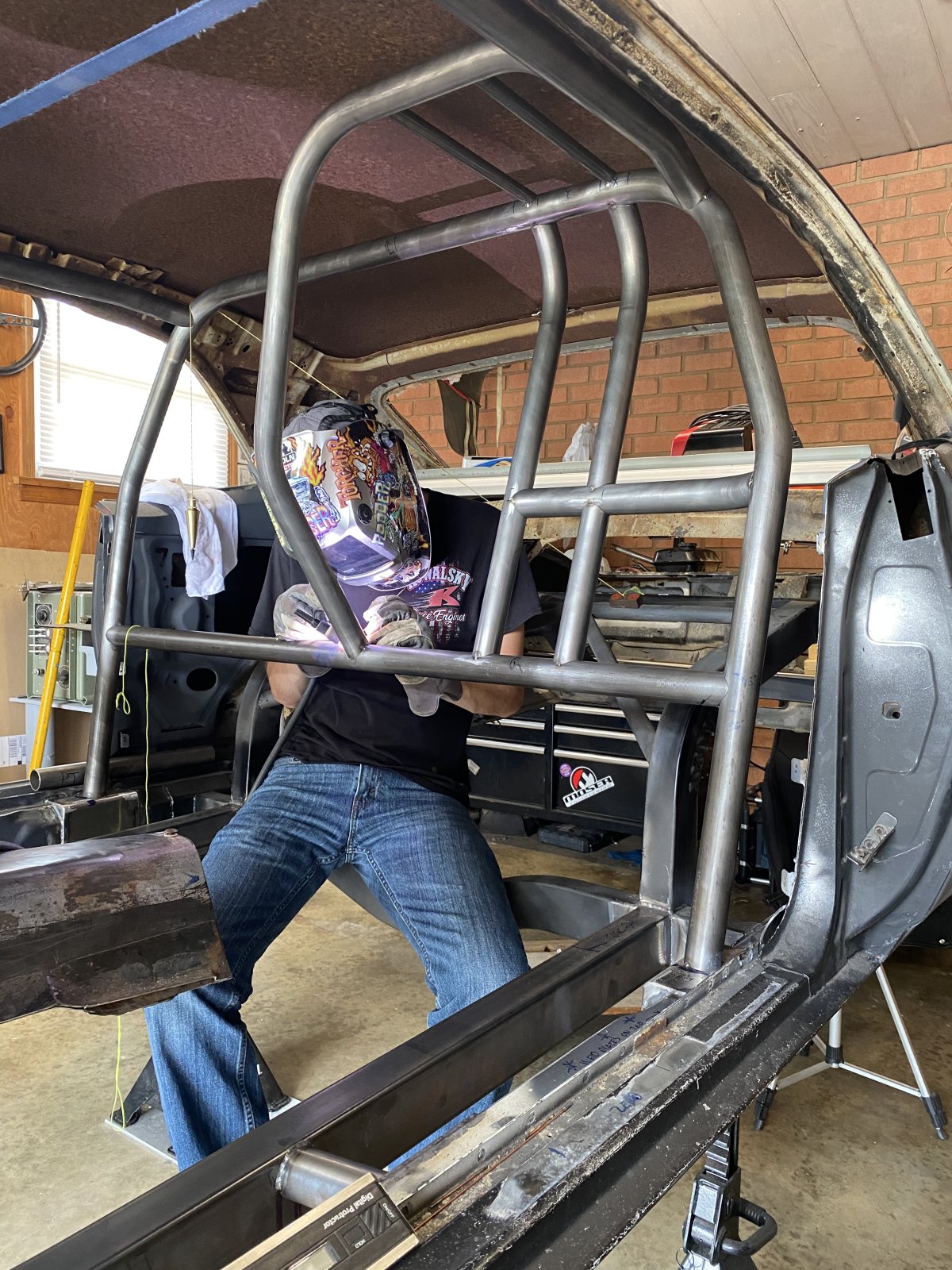

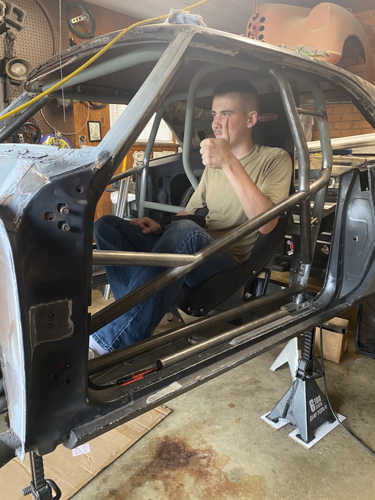

    Teaching the next generation how to make dreams come true while learning skills 4AE86ECF-2B42-4CEE-94EC-003181702EFF.jpeg 63CE1391-6B09-43B3-B2E1-D4814401B28D.jpeg

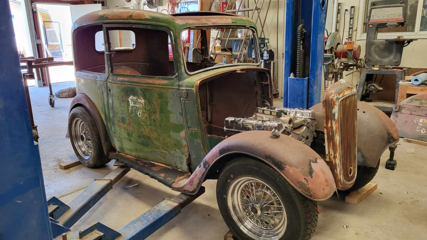

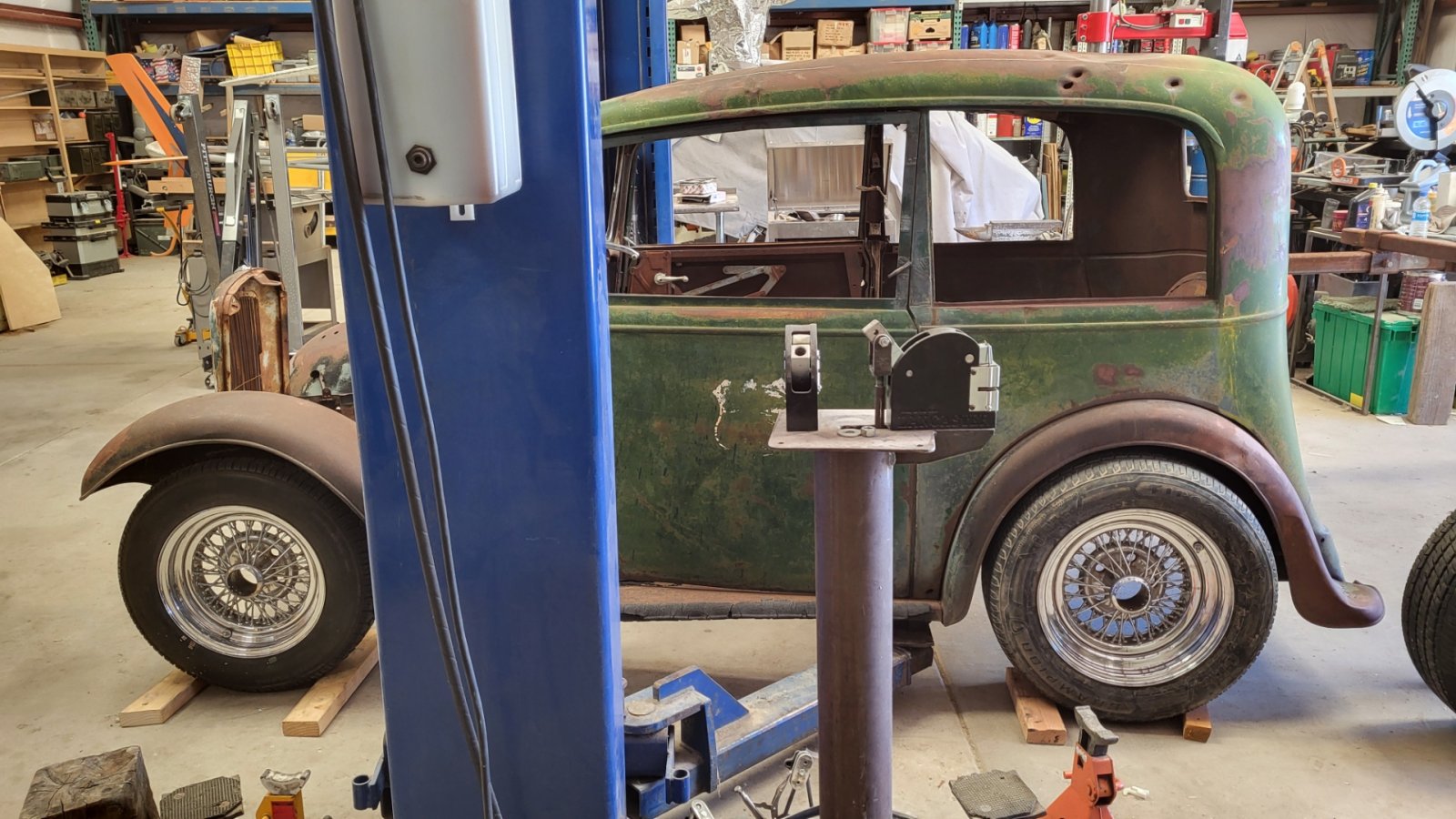

    I mounted some rollers on the wire wheels and mocked up the Ruby with the 215.

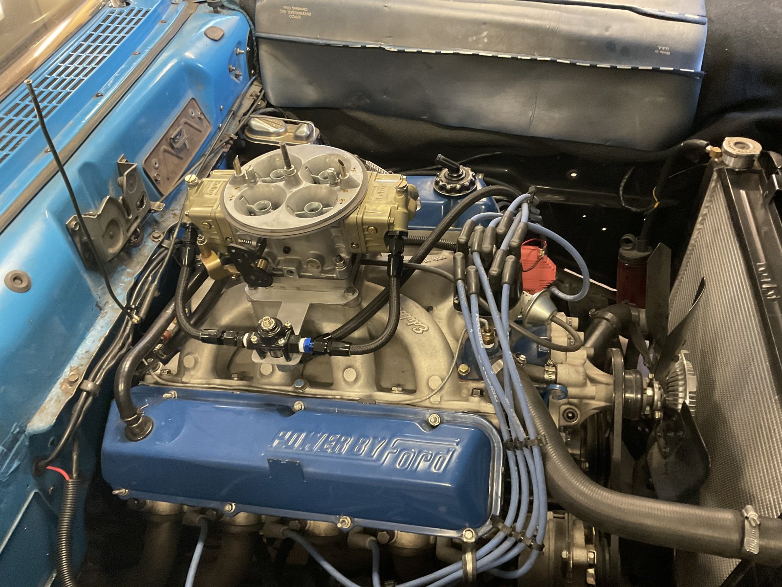

    New intake and a new carb to try out and all plumbed and ready for a test. I’ve tried a few different carbs and the bigger I go the faster it runs…..so an entry level 4500 series.

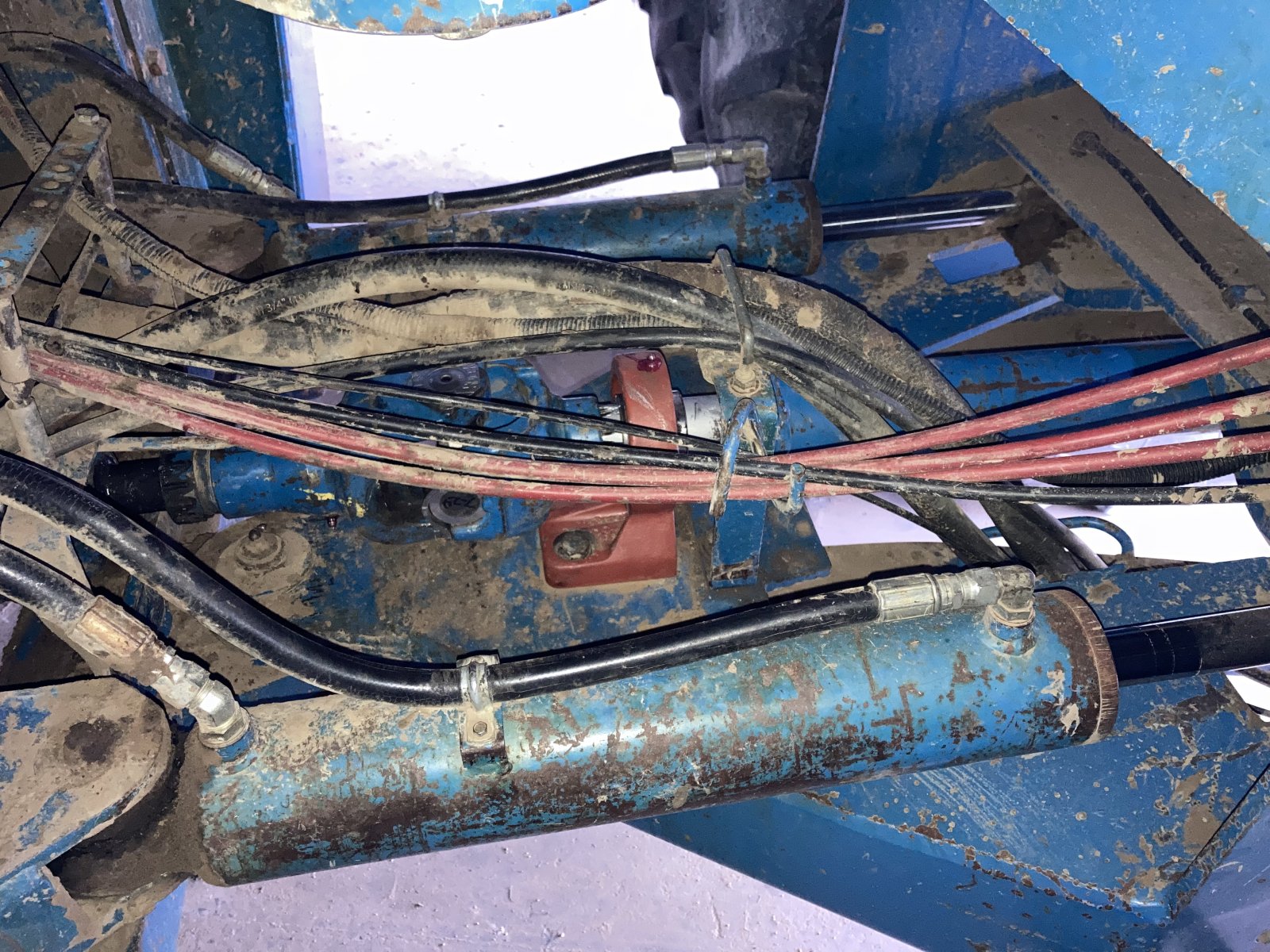

    IMG_9429.jpeg 3 u-joints and one carrier bearing in the 946 Versitile tractor

  17. Are you going to put the Jag rims on the rear too ?

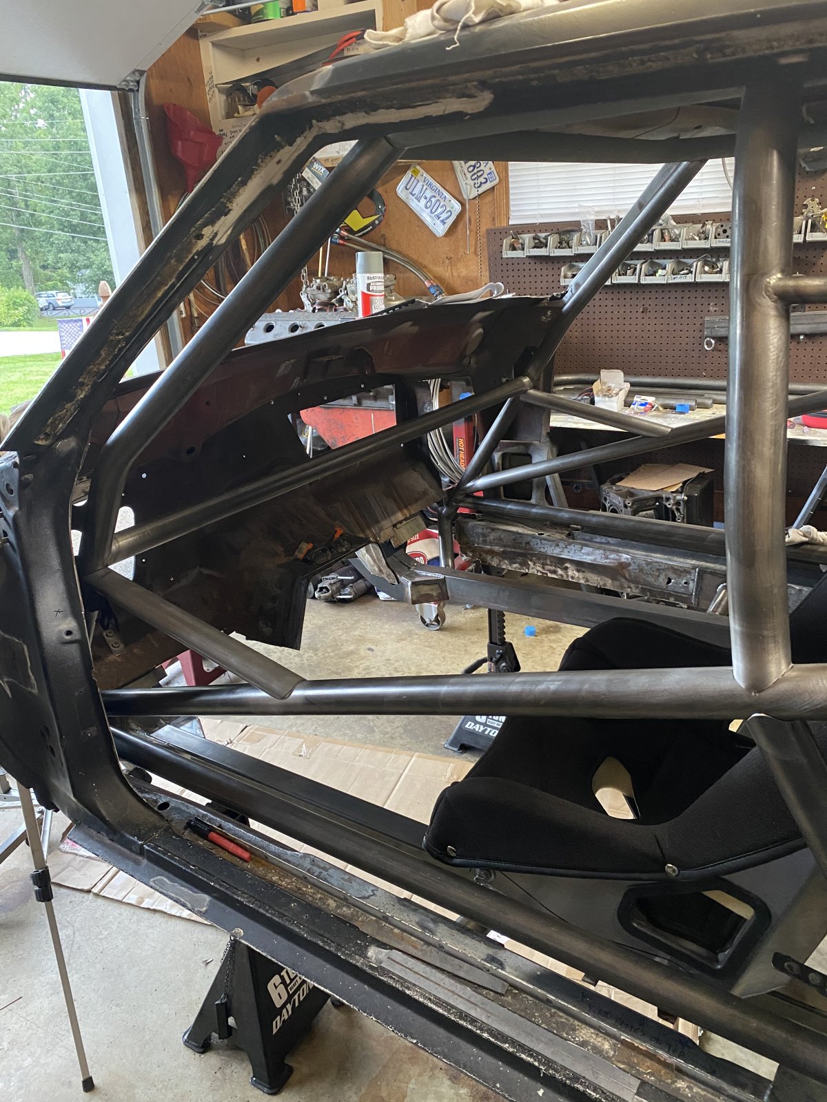

    4D0722E0-DF86-4090-86CB-8141C9453014.jpeg Youngster is learning 3AD36A6D-FEC0-4080-A8C8-538E1A5898CF.jpeg

    Aren't Jaguar same stud pattern as Chev?
    swade41 and enloe like this.
  20. Dick Stevens
    Joined: Aug 7, 2012
    Posts: 4,043
    Dick Stevens
    No, Jaguar is 5 x 4.25 and Chevrolet is 5 x 4.75
    enloe likes this.
  21. twenty8
    Joined: Apr 8, 2021
    Posts: 3,476
    twenty8
    Some are 5 x 4.25 (108mm).
    Some are 5 x 4.75 (120.65mm).
    None came with 5 x 4.5 (114.3mm).

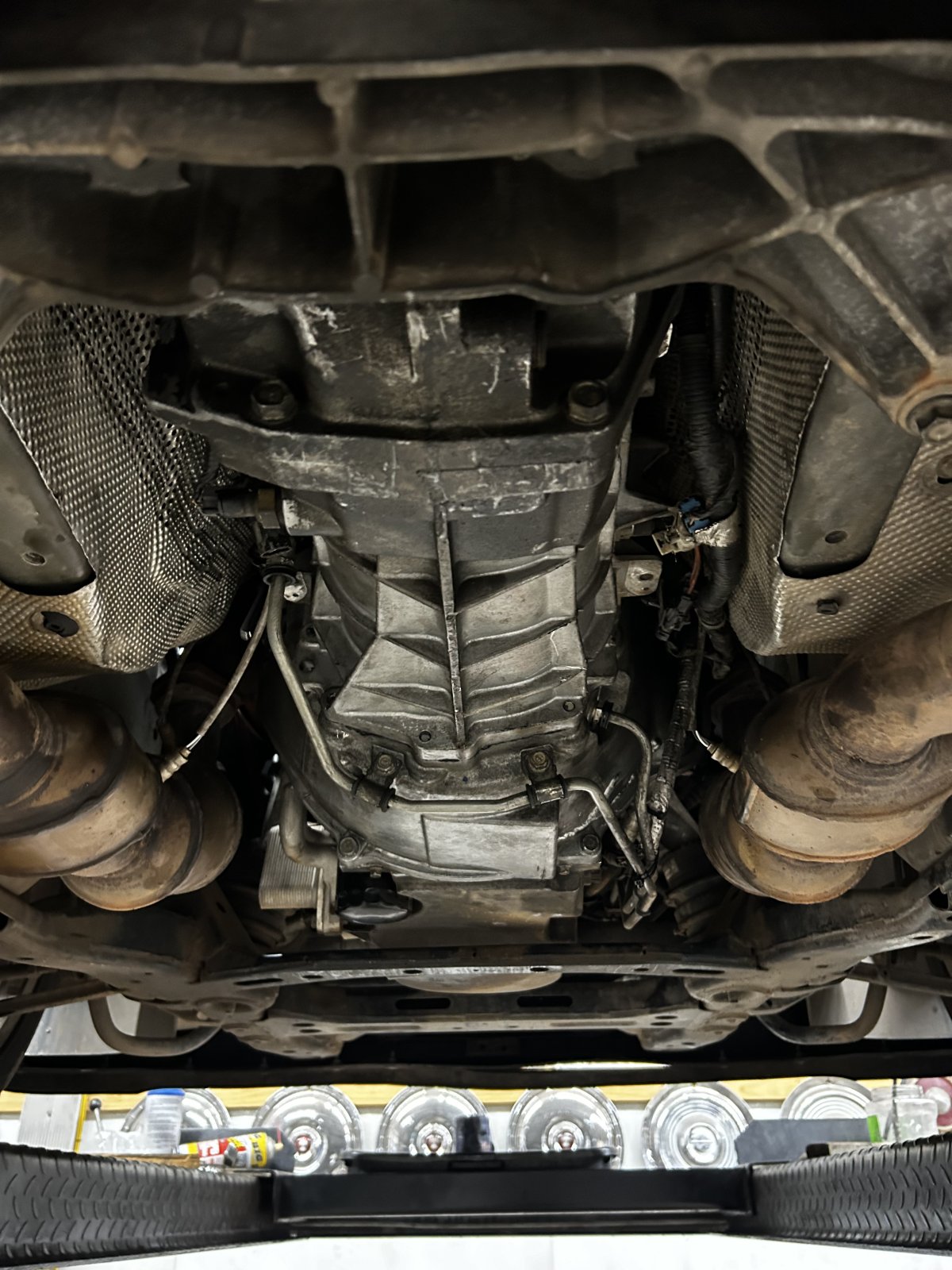

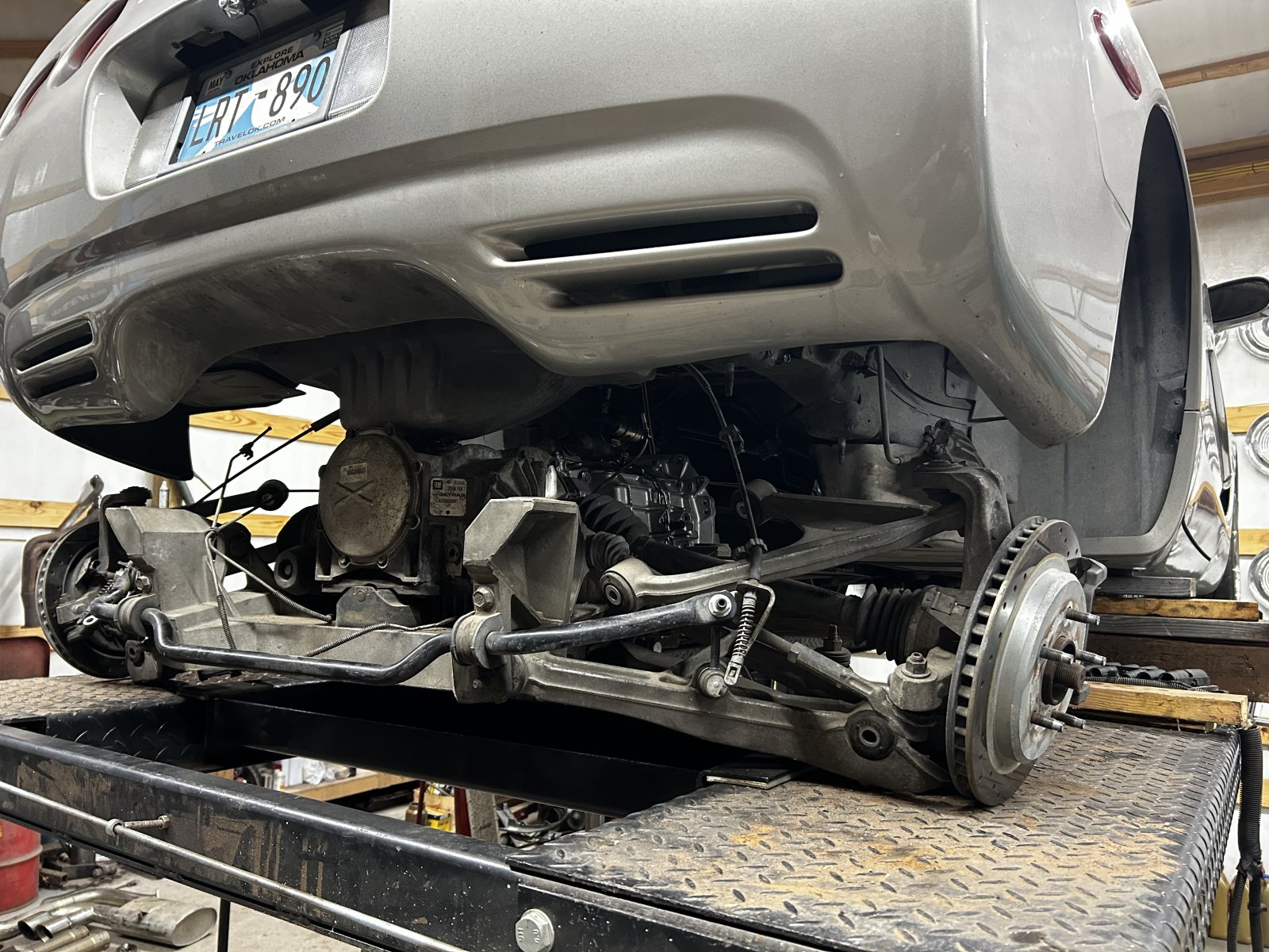

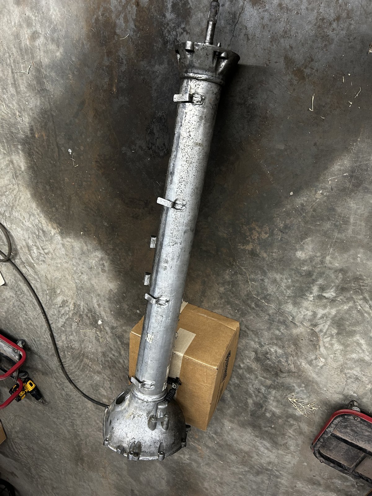

    More Ot crap. Fixing to learn how to rebuild a torque tube in this car owned by my youngest son. I sure like working on simple old stuff better…at least in my comfort zone. I think I am paying for getting my kids into cars.

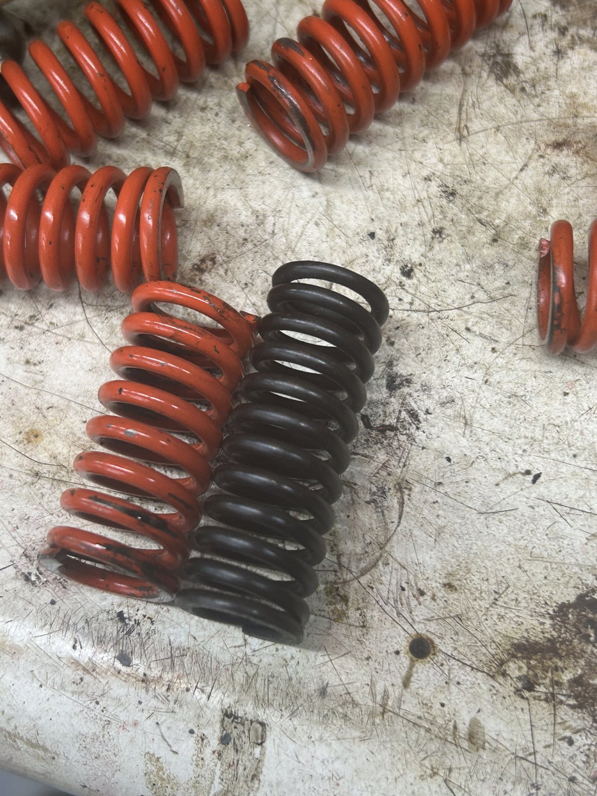

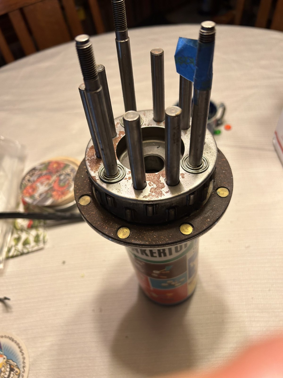

    DB728B4B-7F5E-4C55-8335-8C41A129796D.jpeg 2791434B-B93C-486D-BFEF-0B07889132FE.jpeg 2E42C040-B9BE-4B6E-B6EC-7FA2ADA0E39E.jpeg DD055FC4-920E-441E-AFFA-3D0532FAB54C.jpeg DB728B4B-7F5E-4C55-8335-8C41A129796D.jpeg Cleaned a clutch out of one of the Harleys , goin back together . Lesson well learned AGAIN , China racing clutch not near as good as HD OEM clutch . Silly me again

    Sometimes those prices are hard to pass up though.

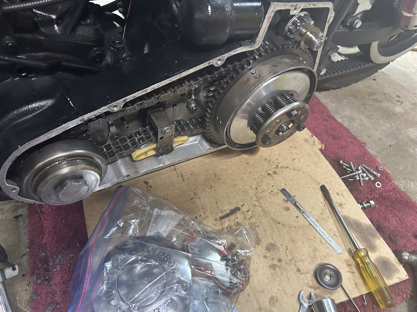

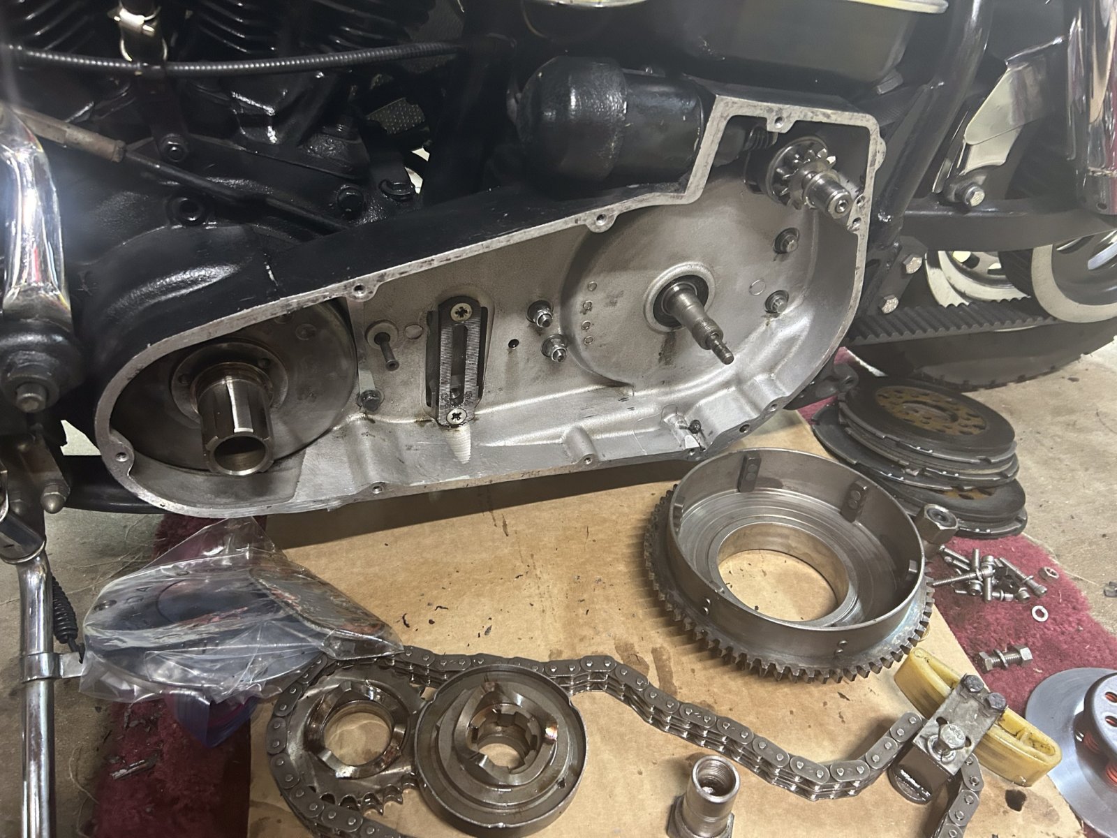

    Understood. I have only replaced one clutch in a Harley and I think I put a Barnett in it? That was about 25 years ago and I remember there was no letting the clutch out easy anymore. It was basically in or out. I even tore it apart during Sturgis to see if I had put something together wrong. :oops:
    Anyway, this is the other OT deal I am working on now as well. Started tearing my bike down yesterday to replace the tensioner on the timing chain. I’m at least hoping that is what is making the whining noise. My buddy that works on bikes regularly didn’t even have to think when I told him what it was doing and how many miles it has on it. Hoping to find out if he was right this week when I finish getting it apart.

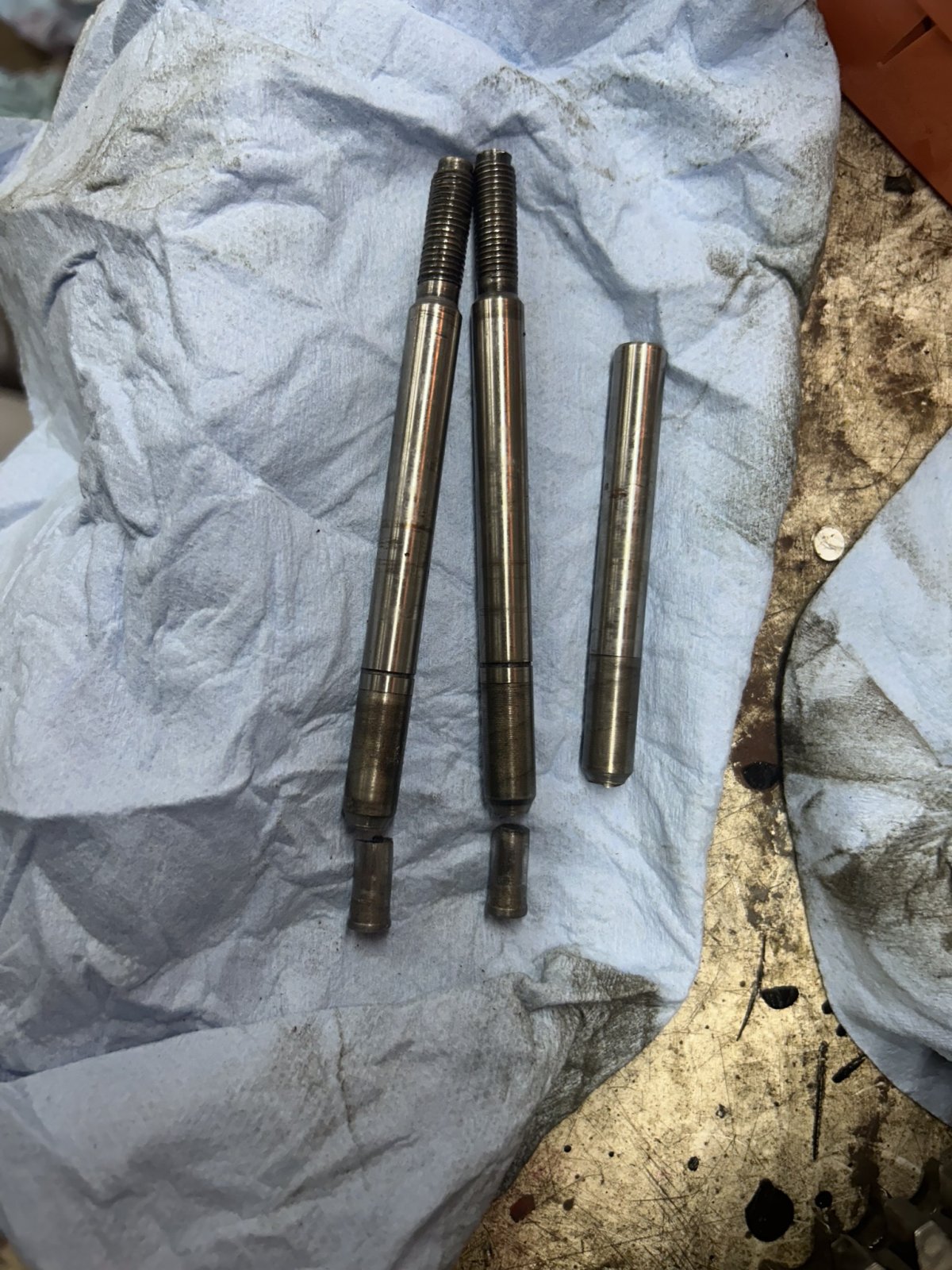

    D9C65EB1-BD88-4BFC-9BF0-8B19D576D5FE.jpeg Silly me , I had the OEM stuff on hand , wanted to try high performance clutch , totally junk . HP unit had 5 threaded studs , OEM 3 threaded studs design was great , manufacturing was total junk . Sheared off 3 of the 5 studs .

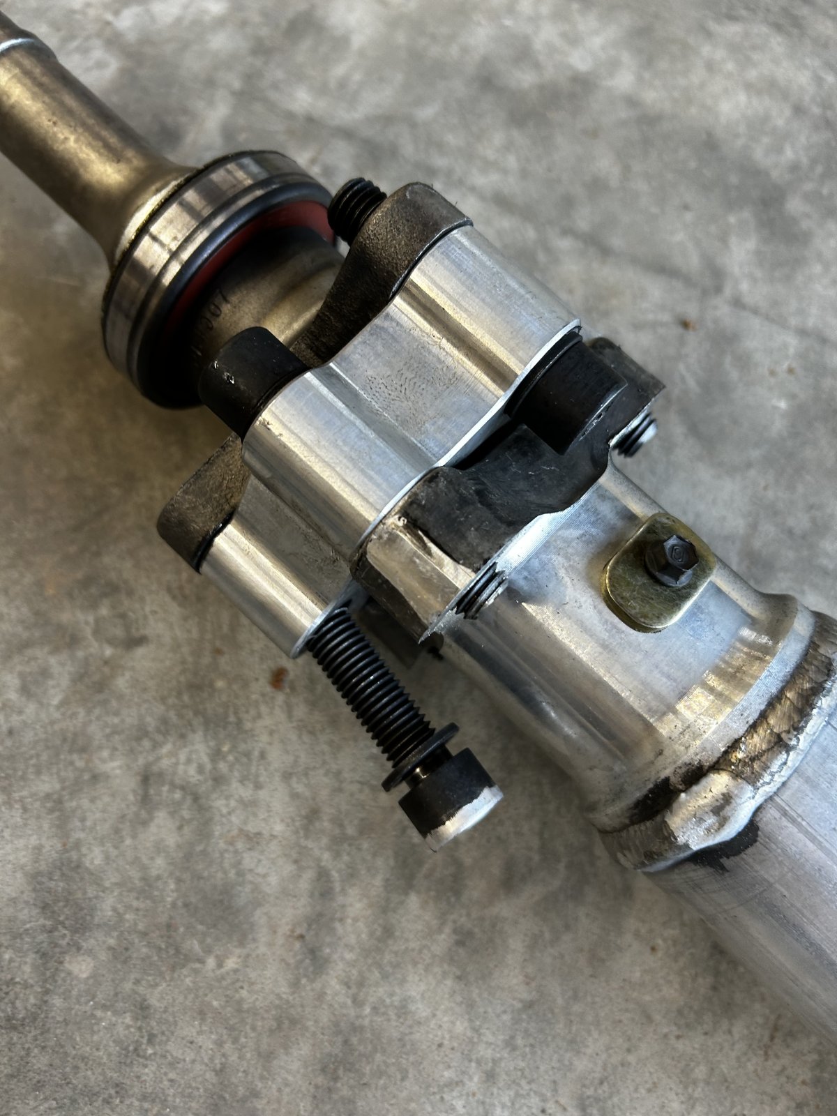

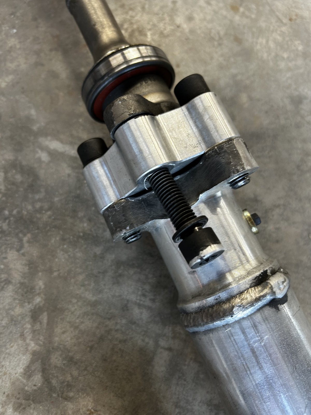

    I think I found the problem inside the torque tube… Seems someone either forgot to tighten one of the bolts or didn’t use Loctite. Whatever the case, they did replace the rubber couplers with aluminum. So, appears my kid is just out labor and not parts to fix this deal.
