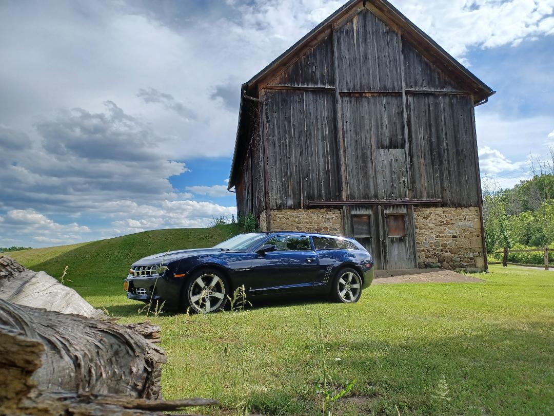

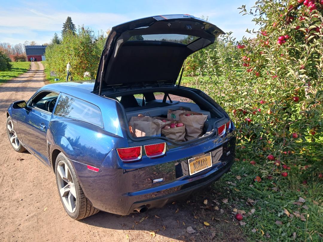

    Los Control, the hatch is fully functional. The design flow photographs better with the hatch closed. Once open, I can gain even more room by folding the rear seat down. I have hauled antiques, car parts and even apples last fall from my Brothers farm.

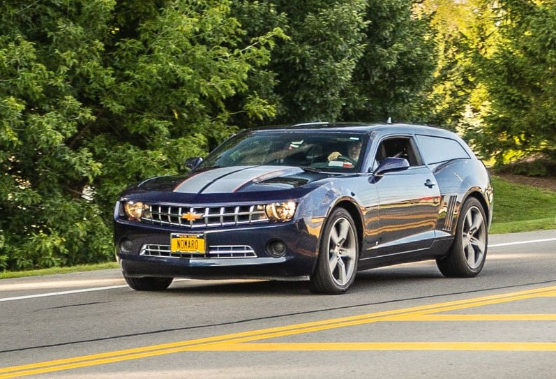

  2. That thing is cooler than the other side of the pillow!
    @raymay What other car did you use the roof section and hatch from or is it all custom built sheetmetal?

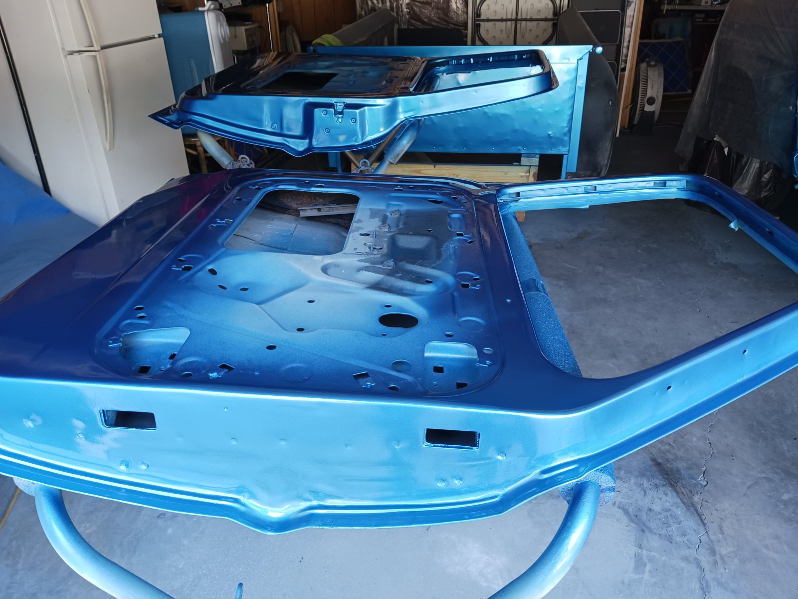

    Started painting my 70 F100. I did the interior stuff yesterday.

    That thing is even cooler than the Camaro it was built from!

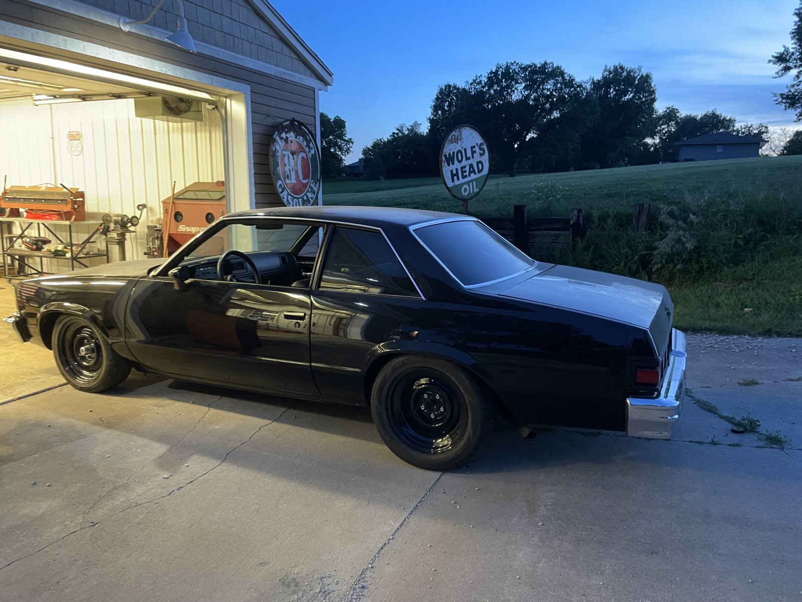

    I am almost finished up with this 79 Malibu. I had one of these as my first car back in ‘88 and have had a number of them over the years. This one has ls2 with a magnuson supercharger, 6 speed and a GN rear end. Big sway bars, tall ball joints, wilwood brakes. I’ve got nos dog dish caps for it and a radio delete plate. Trying to make it sleepersih.

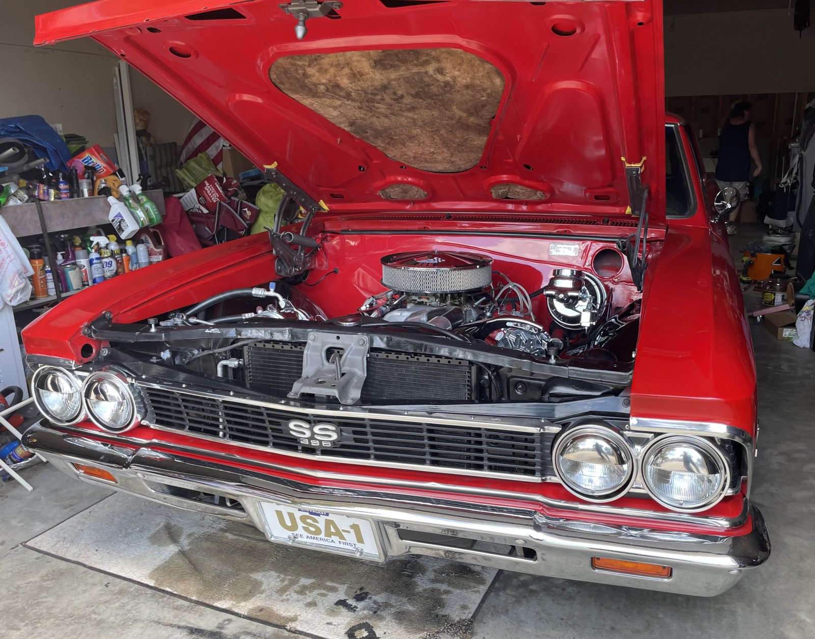

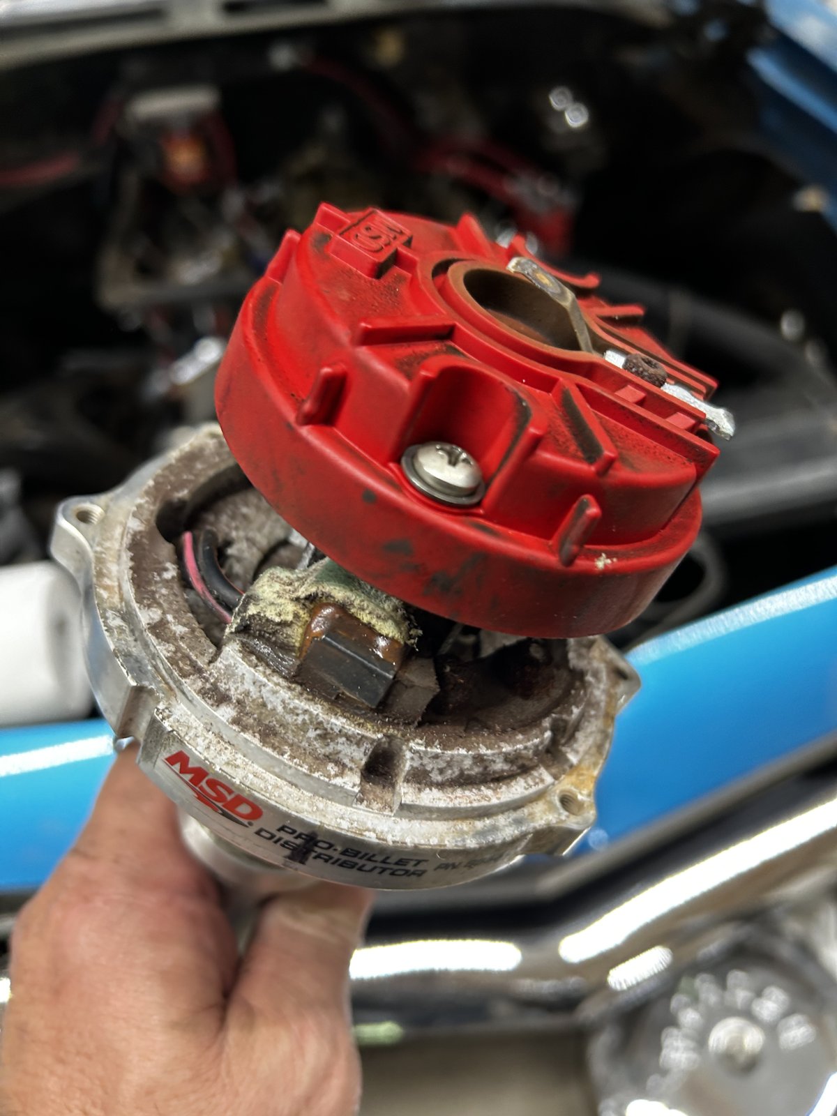

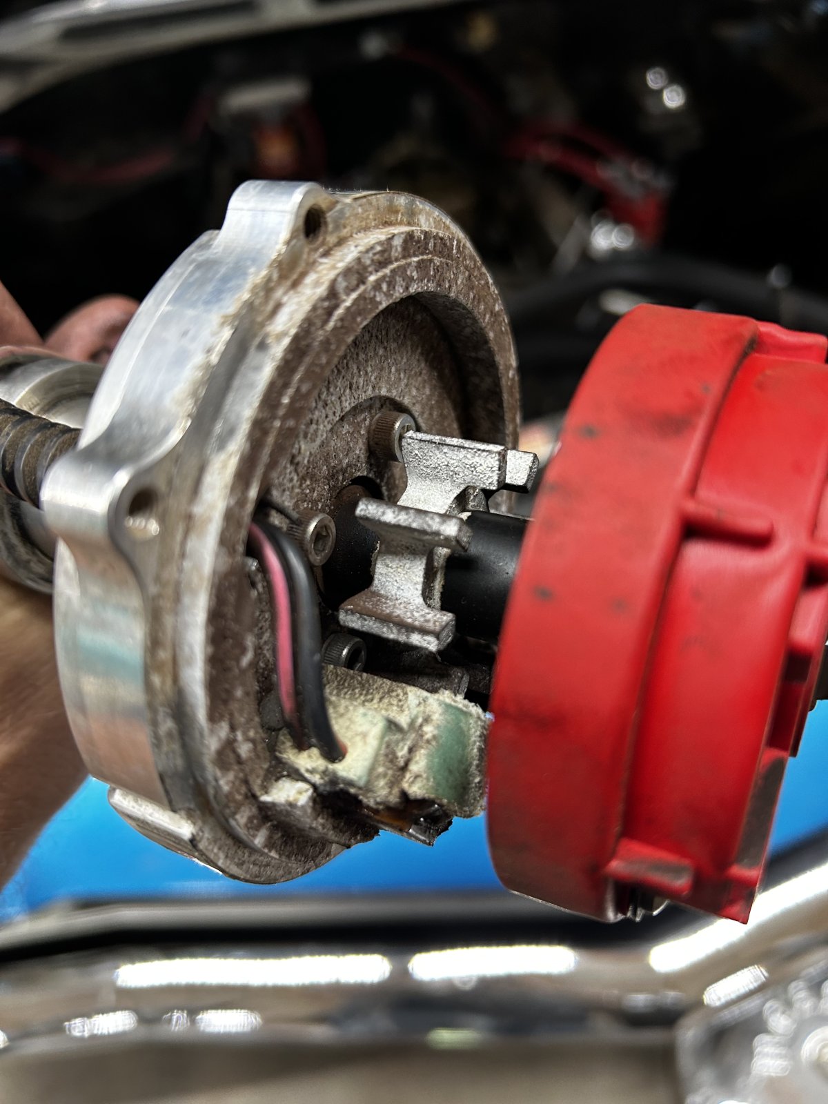

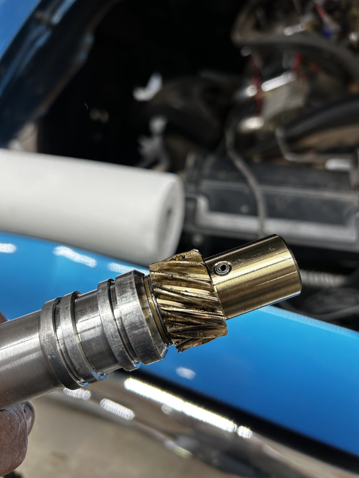

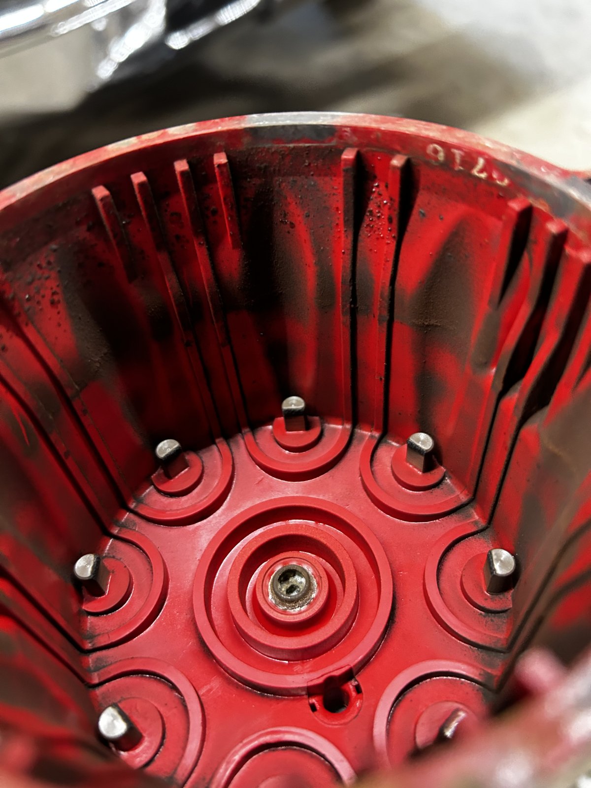

    Finally trying to figure out why my Chevelle started running like crap a couple weeks ago or so. First, I went to check the timing and was able to spin the distributor fairly freely. Then, I pulled the cap to find a ton of corrosion. Then, I decided to pull the distributor to find a worn gear on top of all that other stuff. I may have found the issue(s)… :rolleyes:

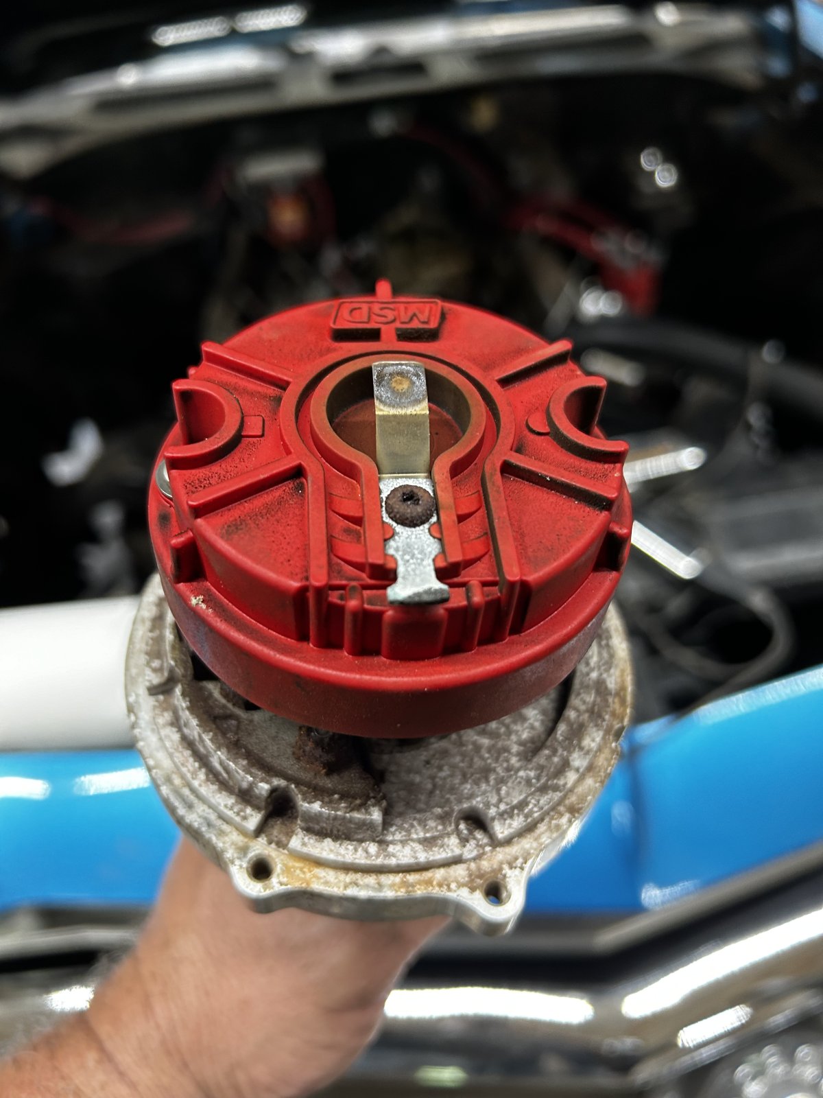

    The MSD in my race car (SBC) gets condensation in the distributor cap, I’ve never had it on any other distributor and can’t really work out why, it seems to be from the crankcase.

    From what I think I see...that little black cap on the top of the distributor cap may be a vent even? I haven't looked at it close yet, but couldn't come up with another reason for it.

    Makes you think they know it’s an issue.
