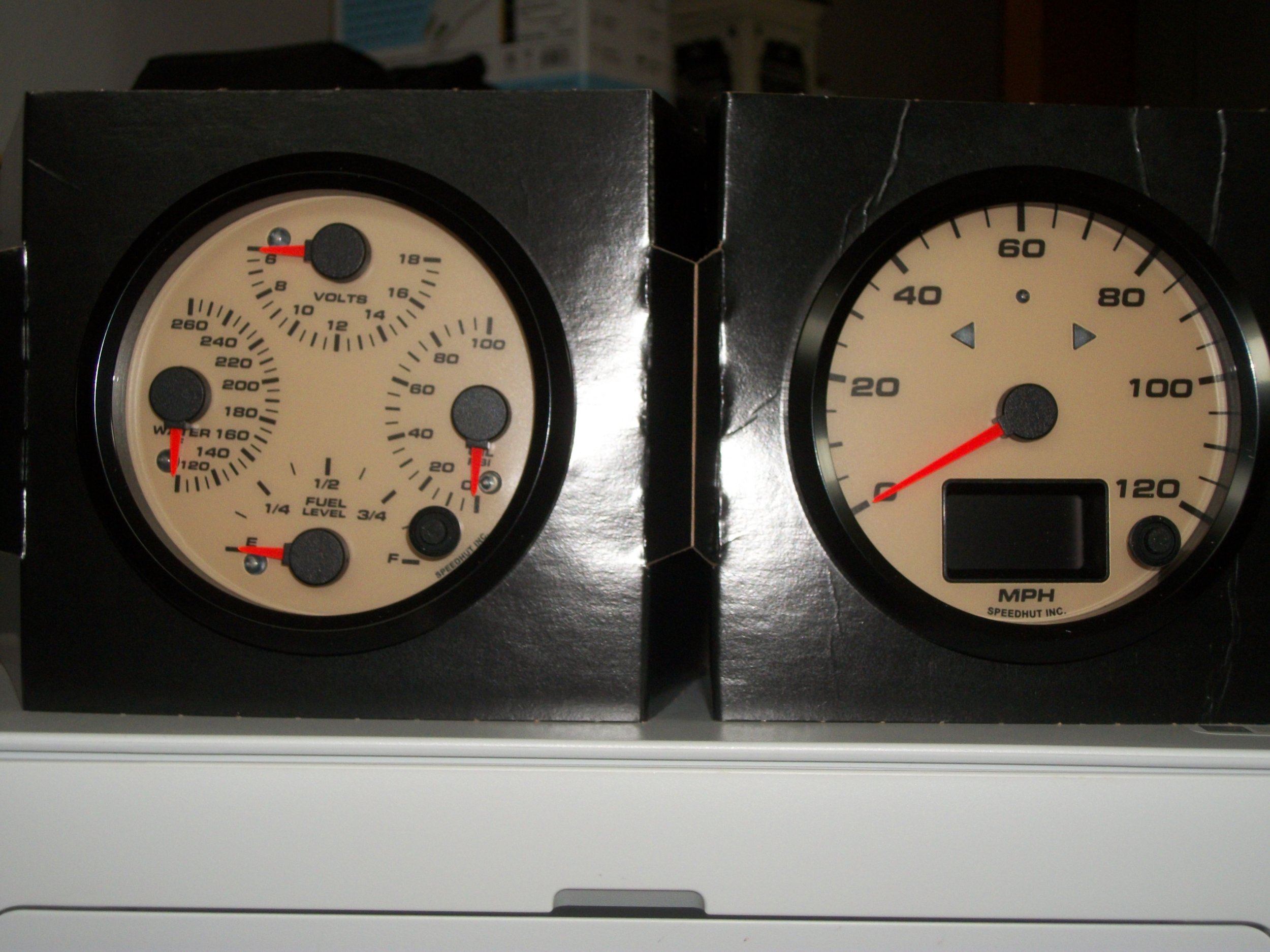

    I just wanted to post what FedEx dropped off at my house this afternoon.
    They were ordered from Speedhut on April 18 and custom built for me. They told me the gauges would ship from their facility in 15-20 days, but here they are, at my residence 12 days later.
    The month of May is going to be a crazy month at our place, so the process of rebuilding the dash so I can get them in, may take a while. Time will tell, maybe I'll get real ambitious.

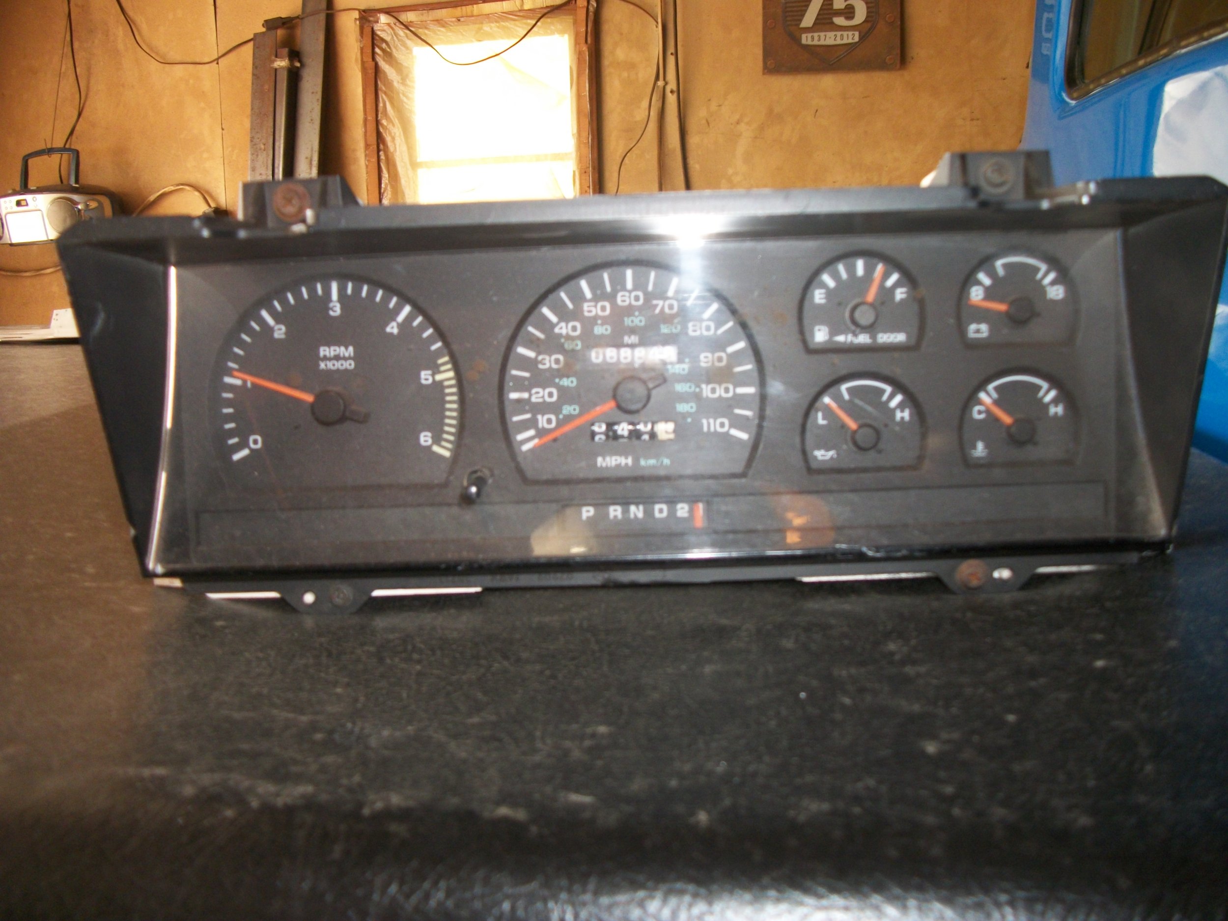

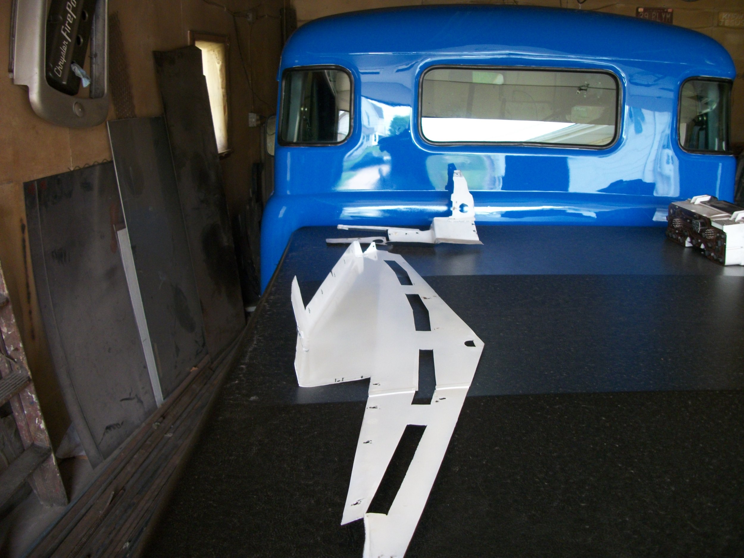

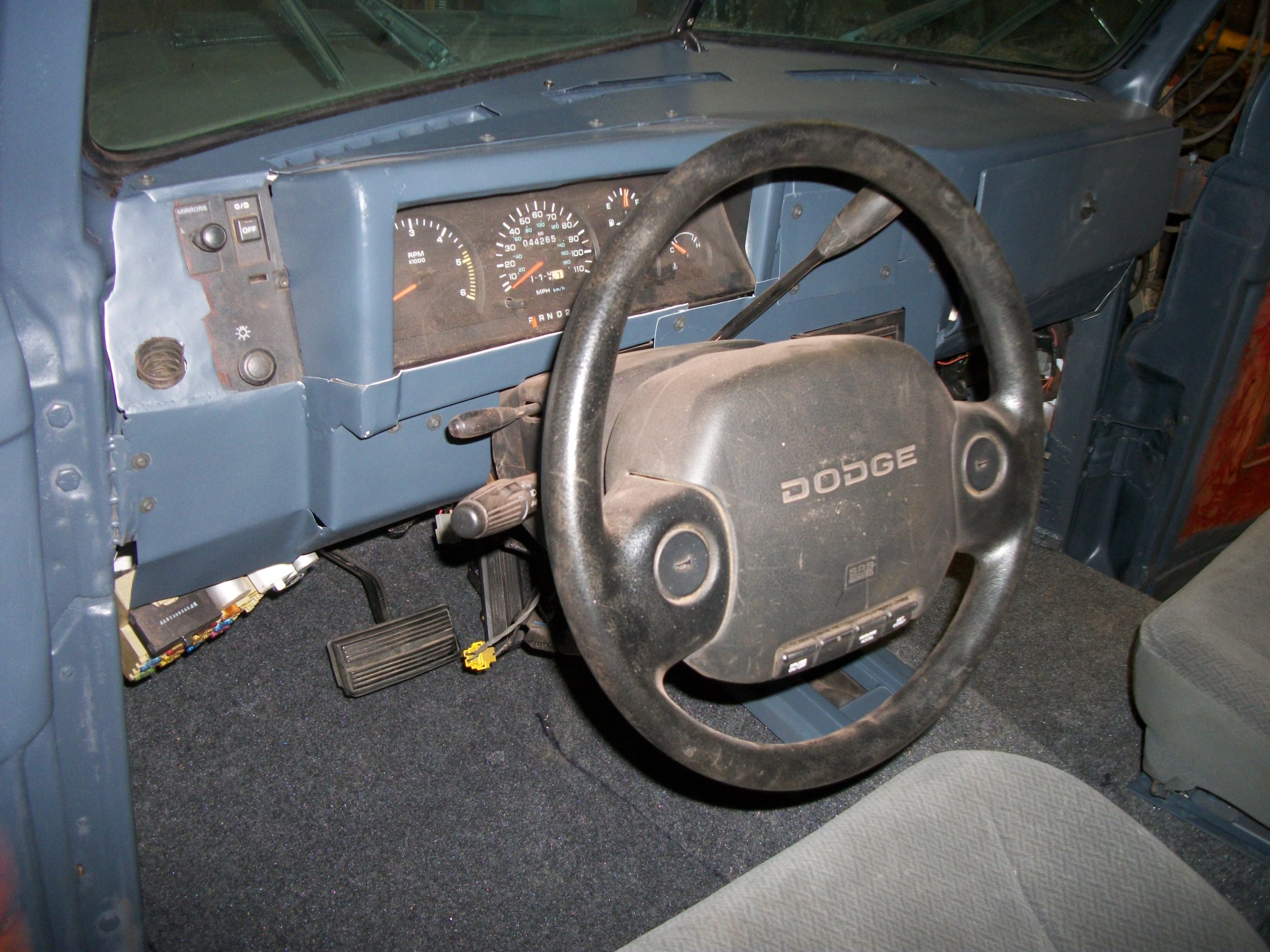

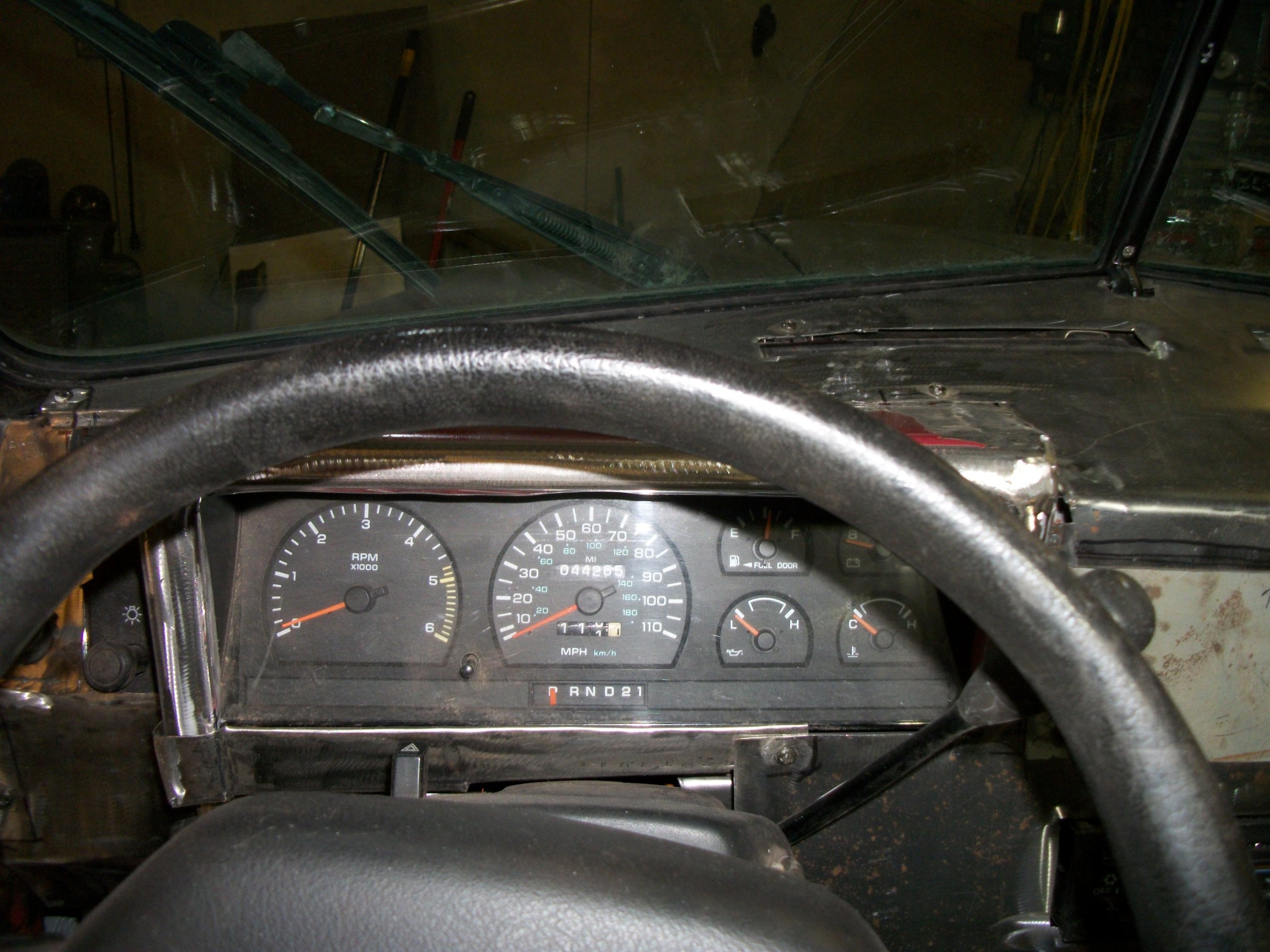

    I took the sheet metal off of the dash yesterday to do a bit of planning. 100_1150.JPG
    1) The back side of the dash cover pieces are all painted white. 100_1151.JPG
    4) The basic plan with card board testing. The details under the dash cover. 100_1154.JPG
    6) The tray of screws that held the dash covers together.
    I'll be putting it all back together tomorrow. Next weekend the truck is going on a 500 mile weekend trip, and on 5/31, my daughter is getting married, so you know what that week is going to look like.
    At this point, it looks like I'll be making an all new dash from scratch. The biggest challenge there is relocating the heat control, and the lever to open & close the cowl vent, both need to move towards the firewall a bit more then an inch, and both have things that are restricting their rear ward movement. I will also need to install the temp sending unit, and the oil pressure sending unit. Both are in really congested areas, and I may need to pull the hood (the center section of the hood is bolted to the nose piece and the firewall and does not move) before I can get to the oil pressure sender port on the 5.2 Mopar motor (its behind the intake manifold).
    I hope to begin the real work after the first weekend in June.

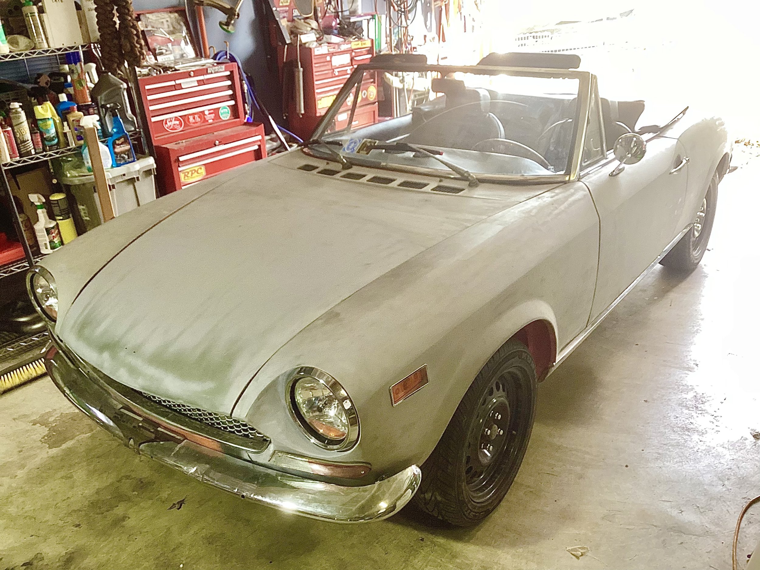

  19. 2987652E-07E6-45C9-B43D-E3E52AEBF9BC.jpeg Working on the brakes on my ‘72 Fiat Sport Spider. I really don’t like doing brakes. The previous owner says that he replaced the master cylinder, brake calipers and pads, rotors, lines. So essentially everything is new. His problem (I just recently bought the car) was that he couldn’t get them to bleed. I have tried a couple of times with my compressor bleeder, maybe got 3 tablespoons of brake fluid to come through. He thinks it’s because he didn’t “double flare” the brake lines, but that shouldn’t prevent brake fluid from getting through the system, and it’s not leaking any fluid. My next step will be to double flare the existing lines (that are new), or replace them. Big PIA, as I don’t have a lift, and have to do it laying on my back underneath. This sucks after two major back surgeries…

    Just so we are clear here, that Dakota instrument cluster is going away. Too many things are failing on it. I will be installing these Speedhut gauges shown in this picture. 100_1149.JPG

    I discovered years ago its cheaper to cut up cardboard then steel.
    Cut it too short or have an odd form? Tape or staple a couple pieces together. You can tape or staple the card board together to create a box or most other forms (even figure out the size and location of the bent flanges), or to modify the size or shape of things. You can bend cardboard on a straight line by marking the line with an ink pin and a straight edge, then folding it (I've used my sheet metal break to bend pieces of cardboard, it gives you a consistent bend line that it will maintain the full length of the bend line). The cardboard provides you with a hands on item you know will fit into the hole, or solve a problem. The cardboard item is ridged enough that you know if something unseen is going to be an issue. If you screw it up, or have finished using it, you can throw it away and start over (larger pieces I just keep, to modify into a different use, some days you don't need a very big piece of cardboard).
    For small stuff, I use the cardboard wrap that is around a 12 or 24 pack of beverage. The stuff I used here was the single layer cardboard that came wrapped around sheet steel when I bought a couple pieces of 48" x 96" light gauge sheet metal (20g, 18g & 16g). I usually got two pieces of 4' wide x 8' long thin cardboard, sometimes its nice just to have a larger piece. I stored it in a dry location and would drag another sheet of cardboard out when the last piece was almost used up. I haven't bought sheet steel since 2018, I'm on my last large saved pieces of cardboard now.

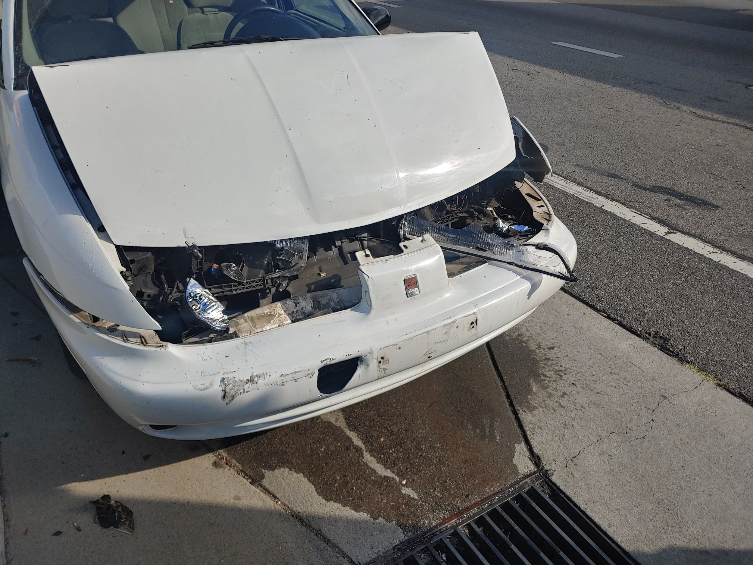

  24. For the last week or so I have been fixing my mistake from early last summer.
    The first picture is the oops that killed my econo car and the next few pictures are me repairing it... I am not finished with it yet hopefully in the next day or two it will be done I am waiting on the radiator (I already bought the radiator but somehow they gave me one for a PT cruiser and because it was almost a year ago I had to buy another radiator errr!).
    I took these pictures a couple of days ago since then I sprayed The front end of the car using a few turbo cans of that rustoleum... That paint comes way too fast out of the can it's even faster than they spray gun with a 1.6 or a 1.8 nozzle. I have no idea how big the nozzle is on the rustoleum turbo can but it would probably be good for a hood or the side of a van or maybe a building but I do not recommend it for more curved parts but that's another story... Anyways so I am waiting for the paint to get hard enough for me to give it a little sand and a recoat, I was going to repaint the entire car with Saturn white but I'm not spending $400 a gallon on a $3,000 car so instead I am going to buy some $60 a gallon gloss white tractor paint and then use some clear urethane that I have in my cabinet and I'm going to add a Gold Pearl to it and have a $150 paint job that should look pretty high end but that will probably happen in a few months and I will post pictures when I do that.
    Currently I don't have a picture of the fenders and the hood but they are junkyard specials except unlike mine that were on the car they are not broke. The car is a 1999 Saturn SW2 I bought it to be my little parts runner 4 or 5 years ago and needless to say when I ran it into the back of the van I felt like an idiot My very first car accident that was my fault... Lucky for me I only destroyed my own car The van I hit had a golf ball size Ding In the black steel bumper and he never even ended up reporting it. My bumper went underneath the bumper of the van and the van bumper went right into my headlights I was only doing probably 15 miles an hour... Plastic cars just disintegrate when you use the body for the brakes lol
    Those of you asking why because after all it is a late 1990s economy car and a Saturn on top of that but I will explain myself. I couldn't bring myself to scrap the car I had just put $400 worth of tires on it then spent another 150 to get it professionally aligned in the front and some special toe kit for the rear Not to mention put a radio in it and probably spent four or five days thoroughly cleaning the interior and putting that adhesive sticky tar sound under in it So needless to say I think I'm married to the car.
    Anyways my next post will be more vague I will post the completion pictures in a few days when I get it done. 0524241718_HDR.jpg 0421251952_HDR.jpg 0502251753.jpg

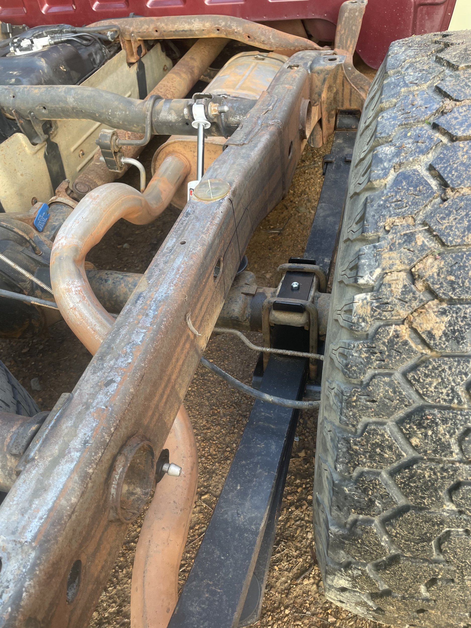

  26. Axle flip complete.
    c-notch next
