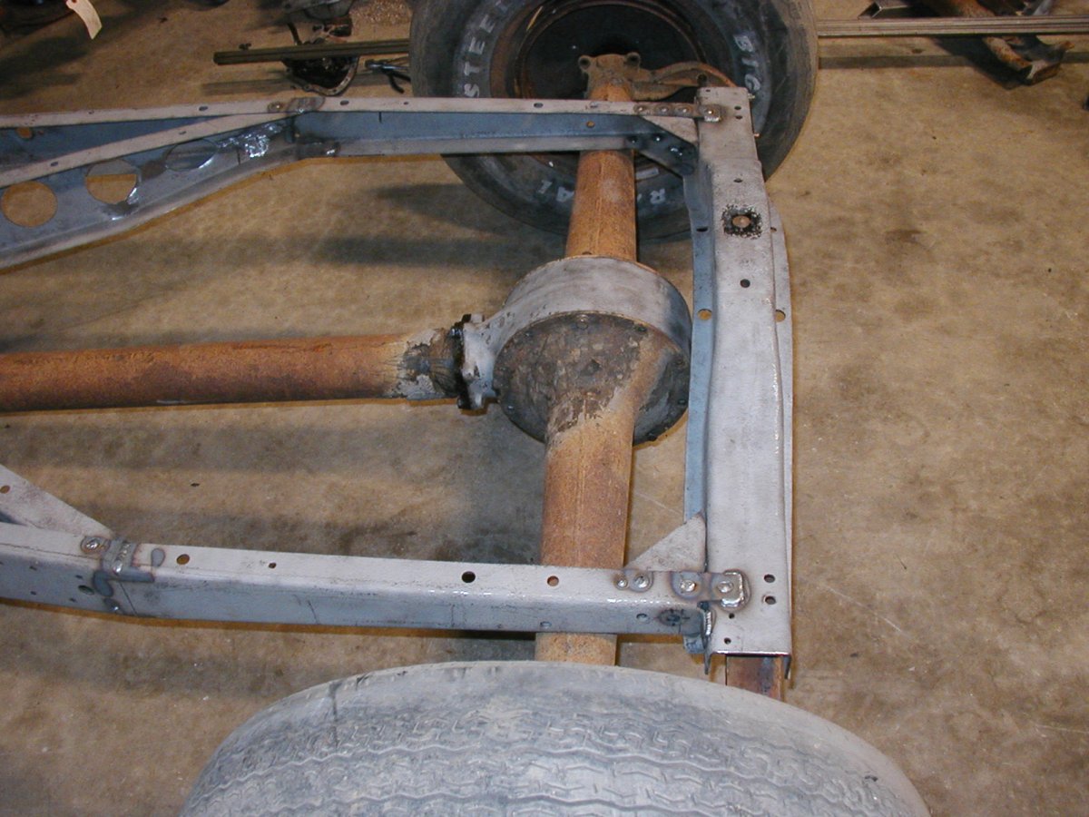

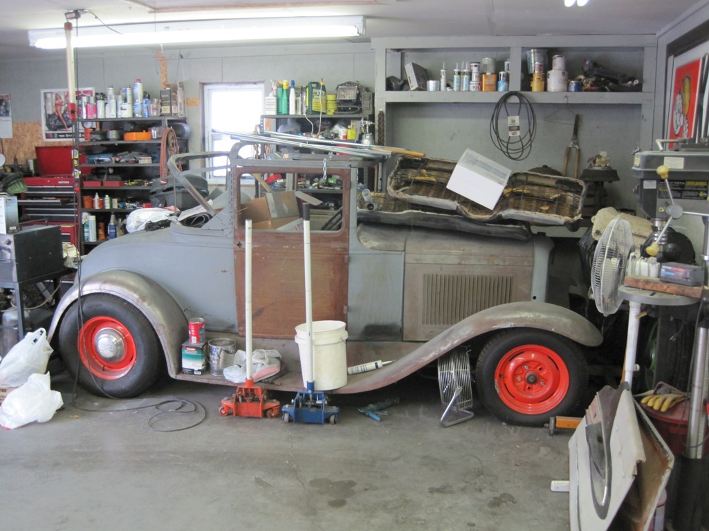

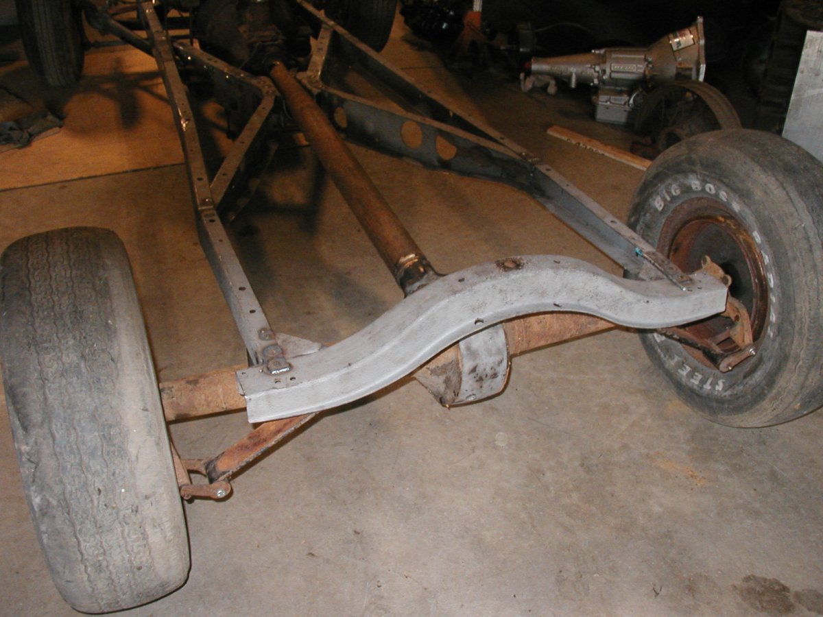

  19. You said you want the most trunk space you can get. Don't Z the frame! Nothing to it like said above. Hang the spring behind then build the spring pack as needed. I found you don't need a reversed eye spring at all. My floor pan is flat from firewall to taillights. I'm still using the Model A spring.
    The Wizzard
    02-15-12 001.jpg Basic chassis welding done 12-30-11 002.jpg 20151023_094028.jpg
    slim38 and Tim like this.

  21. Do yourself a favor before you brake into your Wallet and drag out the Torches. Don't just pick out a number per hearsay. Get the actual rear tires your going to run and do a little Mock up and Math. This is not a one size fit's all kind of thing.
    The Wizzard
    INVISIBLEKID and Tim like this.

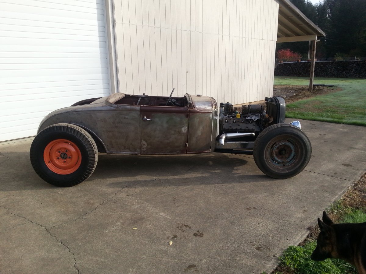

  22. WTF really
    Joined: Jul 9, 2017
    Posts: 1,322
    WTF really
    I was thinking this was a good idea but after seeing yours it looks extremely low.
    48fordnut likes this.
  23. Your right, it is. Look close at the Firewall to Frame relation. I'm also Channeled. All the more reason Not to Z the frame.
    The Wizzard
    WTF really likes this.

  26. Well, believe it or not my Roadster will be full fendered when done and sit low. That's the best of both worlds.
    The Wizzard

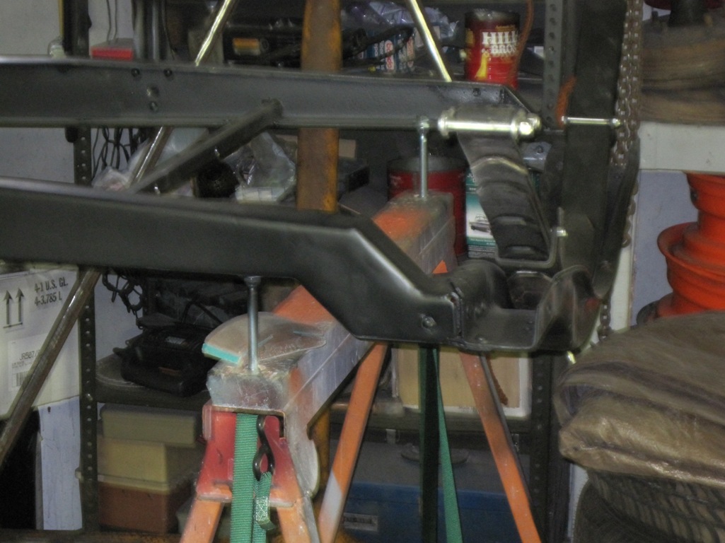

  28. Brandon; I'm an Old silver back. I type with 2 fingers. I did this chassis some 4 or 5 (maybe longer) years ago. It's been well documented right here several times. Please use the search menu and bring it back up. If you still have questions I'll be glad to go back over what I did for the umpteenth time. Here's a Photo to start you off. Please understand I don't think like others and I don't follow directions very well. I really don't care how the Book tells ya hoe to do things. There is no one way fits all.
    Nov 2011 x 3 005.jpg Also, absolutely YES the wheel base is stock Model A. Not longer or shorter. Many here don't exactly believe that but it's true.
