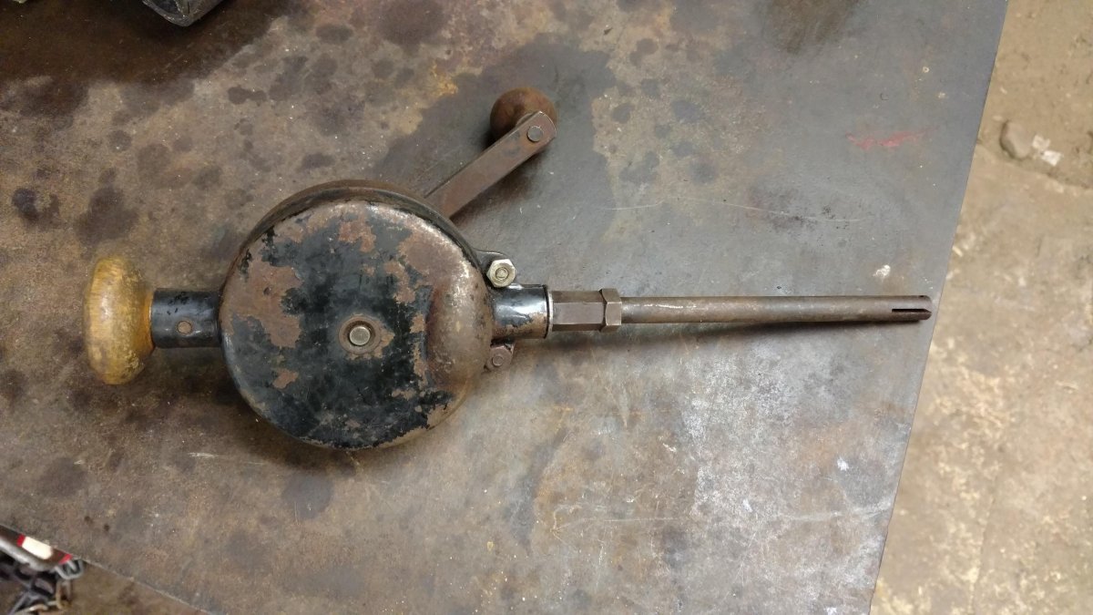

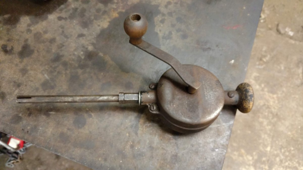

    Can anyone identify what this tool is and IMG_20191008_181345008.jpg IMG_20191008_181337908.jpg used for? When you turn the handle the shaft goes back and forth and there's a clicking sound inside the housing.
  2. This is a valve grinding tool for refacing Model T valves! Use with valve grinding compound...

    Really! That would make sense since it came with a bunch of old valve spring compression tools and other model a parts. Thank you for letting me know.

    Valve lapping tool. Used with lapping compound to make valves mate better with the valve seat.

  5. My pleasure, should have had either an end that looked like a two prong fork to fit two indents in the top of the valve or a suction cup to be a little more universal!

    It is better than a stick! As you turn the crank the suction cup rotates and precesses at the same time. That is to say, it rotates the valve a fixed amount, then back in the other direction but not quite as many degrees, then does it again. That means the valve will gradually spin around on the seat a full 360 degrees over several reversals as the crank is turned. This motion is hard to replicate with the stick and will remove any "waviness" from the valve-to-seat relationship. Mark the shaft and crank it several turns and the mark will gradually rotate through 360 degrees.
