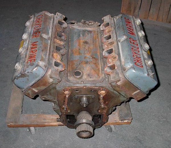

    CC
      76.9 KB
      261

    I have the same one on my old Dragster 354 cu in. Chrysler, I do not think it will fit a 392.

    As far as I know you cannot run a water pump with this it is for Drag only. But yes it will fit a 331.

    As I understand it, this piece will fit a 331 or a 354, but not a 392. Right?
    There's some corrosion on the inside of the mounting flange between the water pump mounting bolt holes, so it may have been used on a drag boat.

    331-354 only I hope that helped.

  13. Dave. That looks like a marine application for a early hemi in my humble opinion. Water outlets being the giveaway. I may be wrong. I have one of those without the water outlets that looks just like that for my 354. Should fit 392 as well. They can be used with spacers to adapt a big block chevy water pump.
  14. I doubt its a marine part, they almost always run a water pump because unlike drag racing, they tend to run for a longer length of time. I'm going to say its just a plain old 51-54 331 hemi passenger car water cover. David

    51-53 has the single bolt @ 12 o'clock, but it looks like it could be drilled @ 11 & 1 oclock to fit the later blocks. Good score!:D
