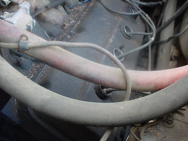

  1. Kinda sad; it was in a lot better shape 47 years ago when I first looked at it. Least he gave me the engine out of an old school bus/camper some hunters left up there long ago. Kinda surprised when I looked under the hood one day.

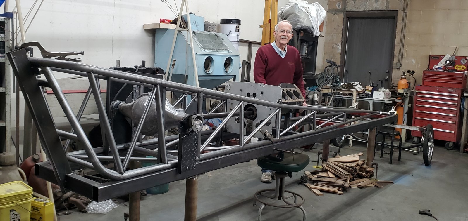

    Thanks for the compliment! As far as certifying it, I don't really have plans to do that, or feel that I'll need to. I just plan to bracket race it at local "outlaw" 1/8 Mi. tracks. Last year, at one of the tracks, I asked at the pit gate if I could speak with their tech person and was told they didn't have one. Well, that seemed to settle that. :rolleyes:
    That said, I can't see any reason it wouldn't certify though, although I don't have any plans for it to be fast enough to even require certification. I built it by plans (with very minor changes, mostly to the shape of the rear) from S&W Race Cars, following their tube layout, so I think I'm good there. I was having problems finding all of the tubing sizes needed to build from 4130 chrome moly, so per rules I found I used .120 wall DOM tubing which is an option (minimum .118" required).
    The plan is for a pretty mild SBC with full-length Powerglide and it has a Mopar 8 3/4" rearend that I narrowed. According to a calculator someone directed me to, it should run about 7.00 seconds and 100-ish MPH in the 1/8th mile. Fast enough to have some fun. Challenge will be getting consistent. Even if it's a complete disappointment at the track it should make for some neat "garage art". :eek:
    Thanks again!
    Lynn

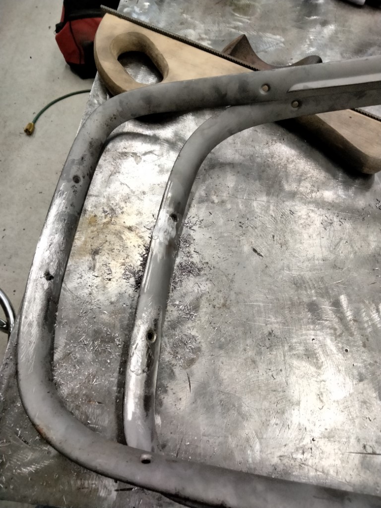

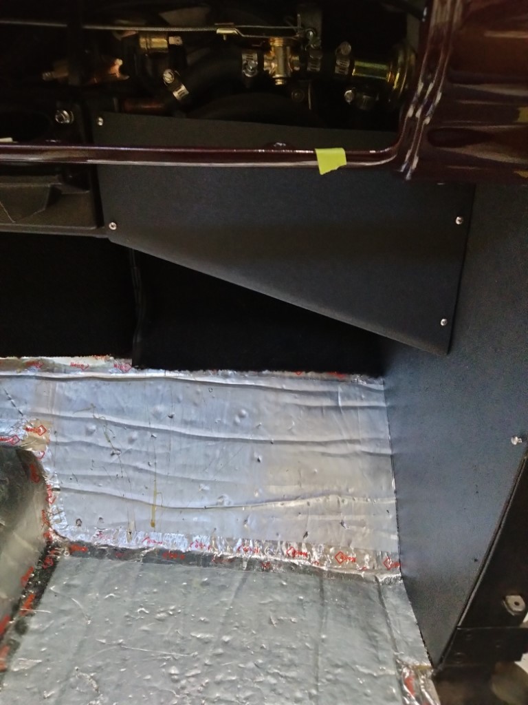

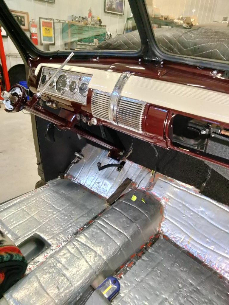

  17. Installed the air vent box in the dash followed by the speaker grille and trim. Finished the ABS hose cover for under the dash. Leaded the chopped windshield garnishes and started to file them; but ran out of time.
    1 2022-01-20 14.43.17 (Medium).jpg 2 2022-01-20 14.42.53 (Medium).jpg 3 2022-01-20 15.37.49 (Medium).jpg

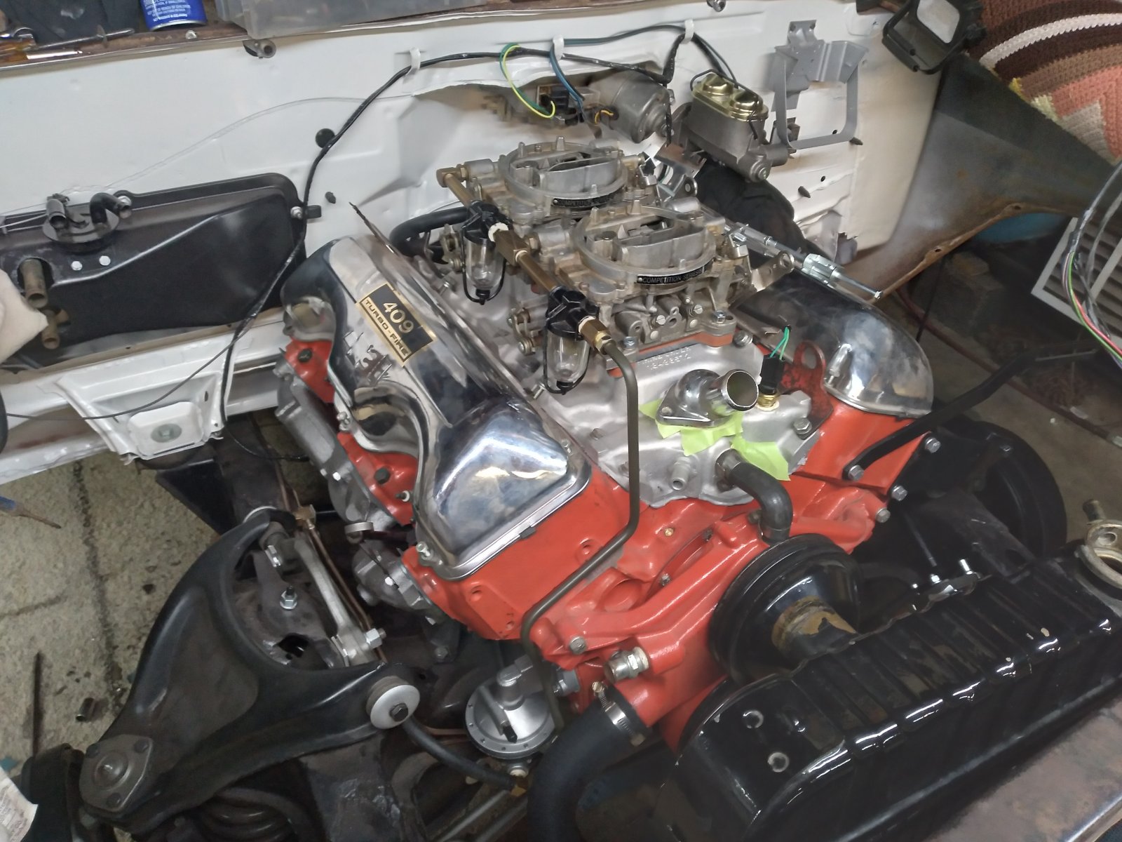

  21. Damn that is nice James. Hard to beat the visual impact of a well dressed W engine.;)
  22. saltflats
    Joined: Aug 14, 2007
    Posts: 12,602
    saltflats
    from Missouri
    Thanks Mikey, seems to be the theme over here.
