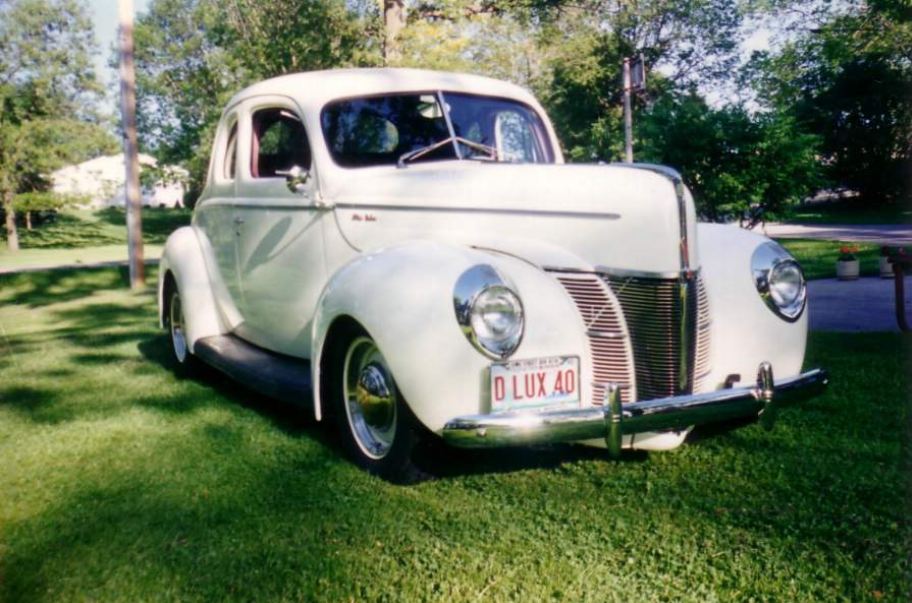

  29. Tnomoldw
    Joined: Dec 5, 2012
    Posts: 1,563
    Tnomoldw
    White hides ugly, but is ugly itself :p YUP ! White is an ugly color but it sure make these sleds look good , called VANILLA SHAKE:eek::cool::D It would look great on your lark. ;)
