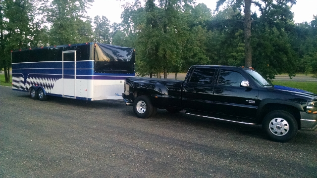

    We have had several different trailers. Our best enclosed trailer was an H&H with more standard height than others, no rivets on the sheeting, torsion axles, LED lights (when they first came out) and an adjustable height tongue. I would also suggest the 10,000# trailer. Axles, tires, wheels and brakes are all better and usually require a better hitch and bigger ball. Be sure to check the trailer empty weight when shopping, there are huge differences there between manufacturers. We found some 10,000#ers that could only haul 3500# because the trailer was so heavy! You aren't going to be pushing the GVWR hauling a '32 but you may need to rescue something else that will. I would also suggest going with a 24' instead of 20'. Not that much difference in purchase price or towing but a huge difference when you decide to sell it. Our dirt late models or modifieds are right at 17' long. With a 4 wheeler backed in in front of the race car they were nose to nose with about a foot to spare. Most racers looking for a trailer wouldn't consider a 20' trailer so that kills a big future market. We added air lines, lights, power to the back door, a winch, work bench, tire rack and rampovers with storage under them. When we sold it after 9 years of steady use we got more out of it than we had invested in it. Sold it in 2012 and that buyer sold it 3 or 4 years later and said he made money. I still see it occasionally at the races earning it's keep.
    SPark
