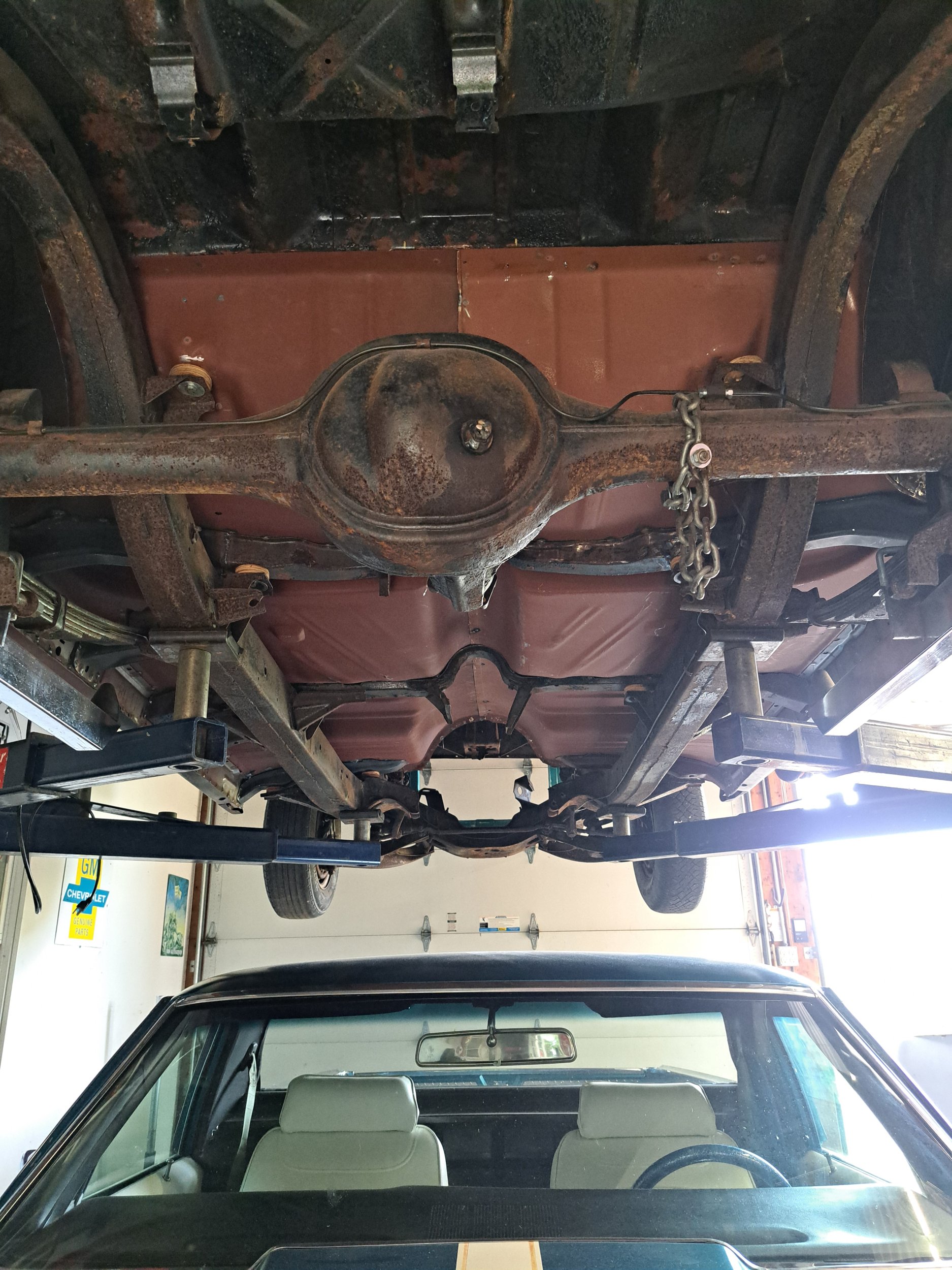

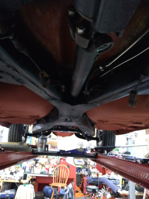

    Spent a few hours on the Biscayne this afternoon. Took care of a few loose ends.
    Today was driveshaft, starter, oil filter, park brake cable and fuel pump.
    Had to change the yoke on the driveshaft to the course spline to fit the early T10.
    Also put gear oil in the transmission and the rear end.

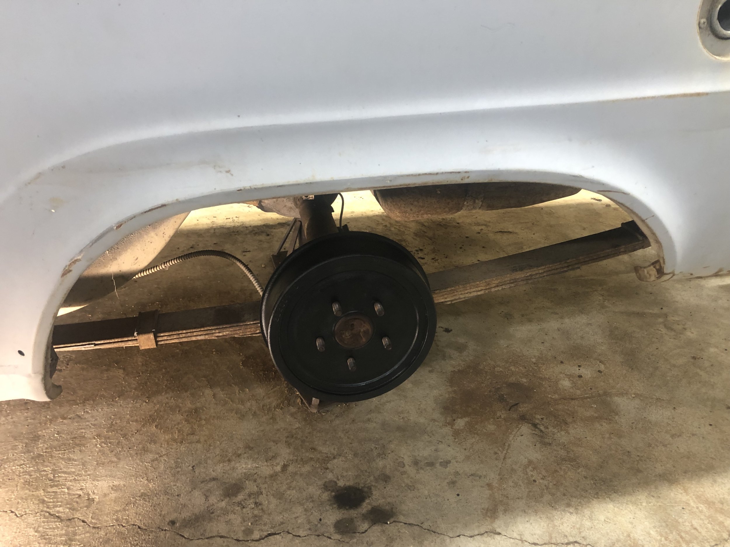

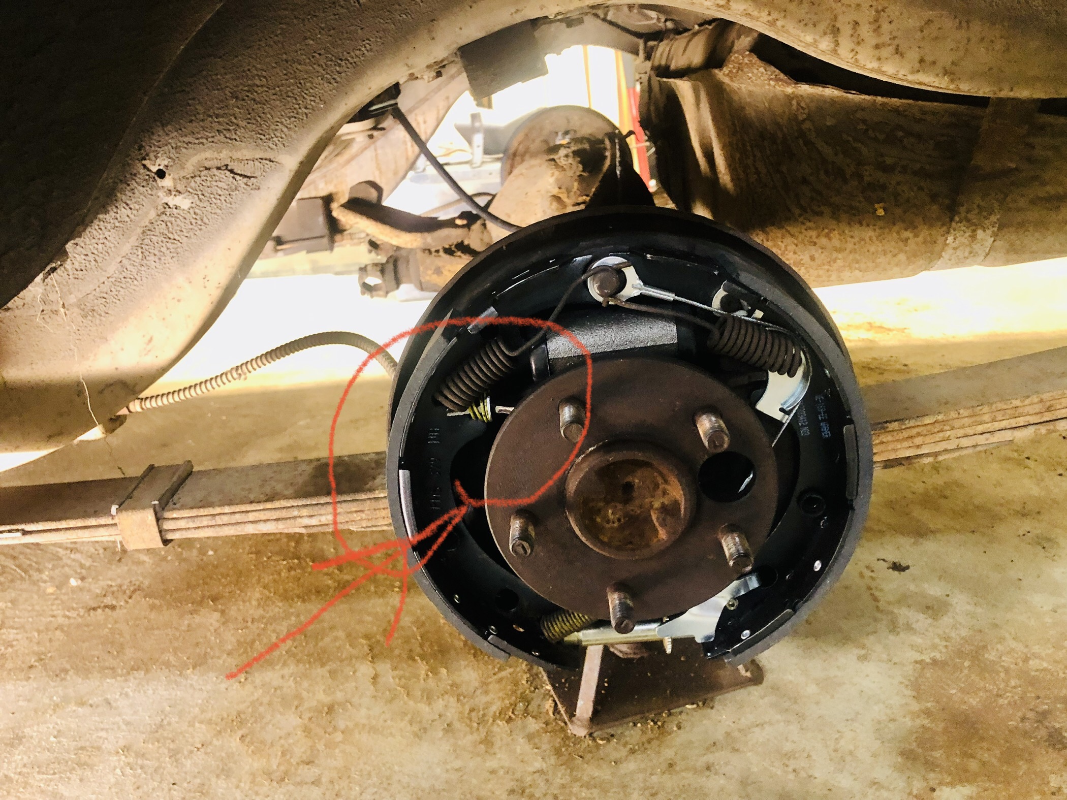

    IMG_3263.jpeg IMG_3264.jpeg Working on the Dart brakes, new MC, wheel cylinders, lines, shoes and hardware. I could purchase everything except the parking brake strut springs.
    A question for BRAKE experts , is the strut spring absolutely necessary?
    Upon disassembly one side was missing the spring the other was broke in two. With the help of the NAPA counter man we found some springs that were close in size. I reshaped to fit, they seem to function OK - no binding.
    This rear differential is temporary, maybe a year, I’ll be installing an 8.8 down the road, but I want the brakes to work correctly.
    Next up gas tank removal , cleaning and paint.

    I was under the thought that that spring was to keep that bar from rattling nothing more.

    Thanks that’s what I thought but was/am unsure. I can’t find one for my application, I think what I made up will work and appears to function properly.

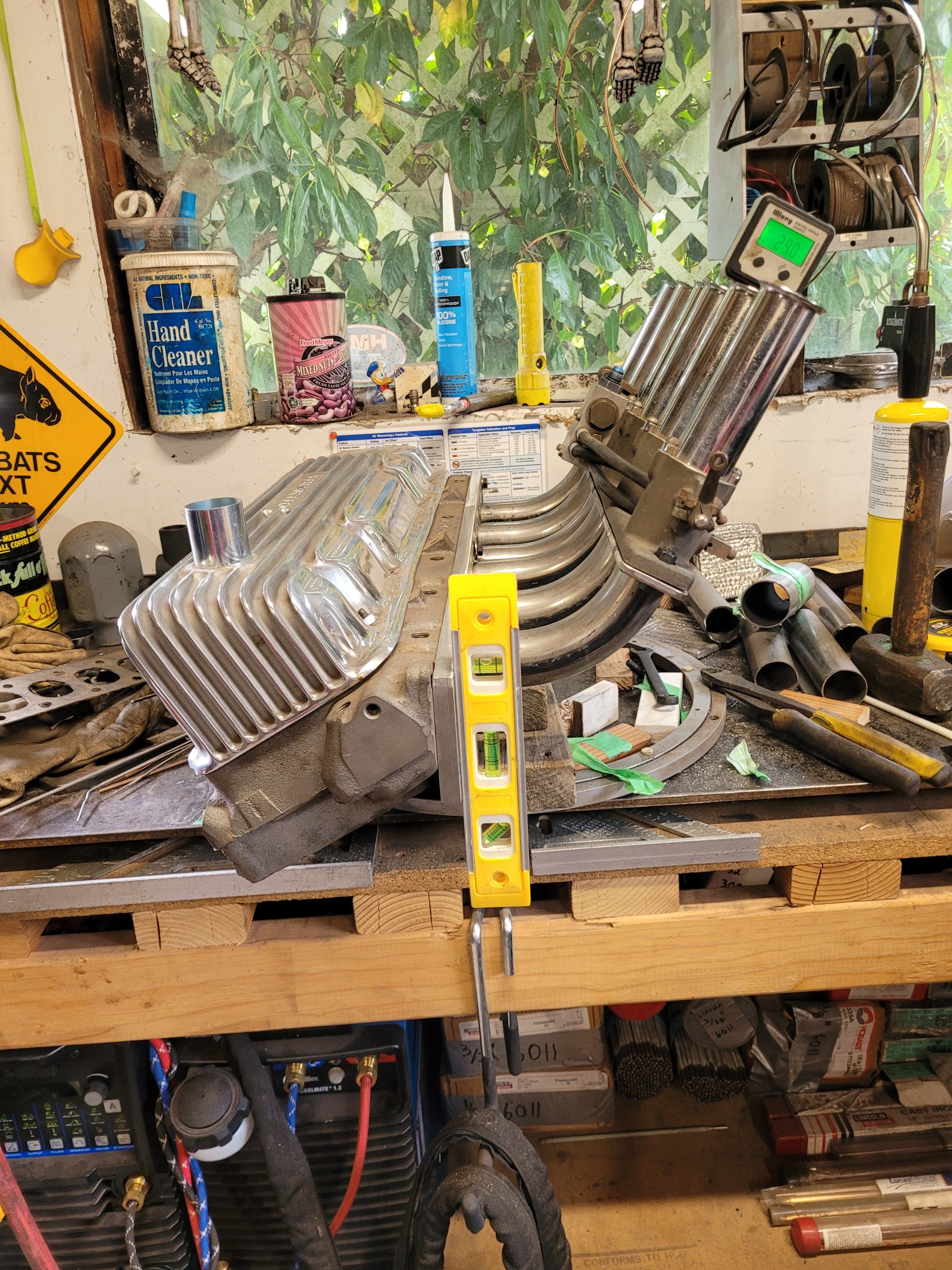

    Bouncing between fabbing the intake/exhaust adapter for the Hilborn unit for the Dragmaster Dart Six project and bringing the 53 F-100 back to life after its 15 year nap.

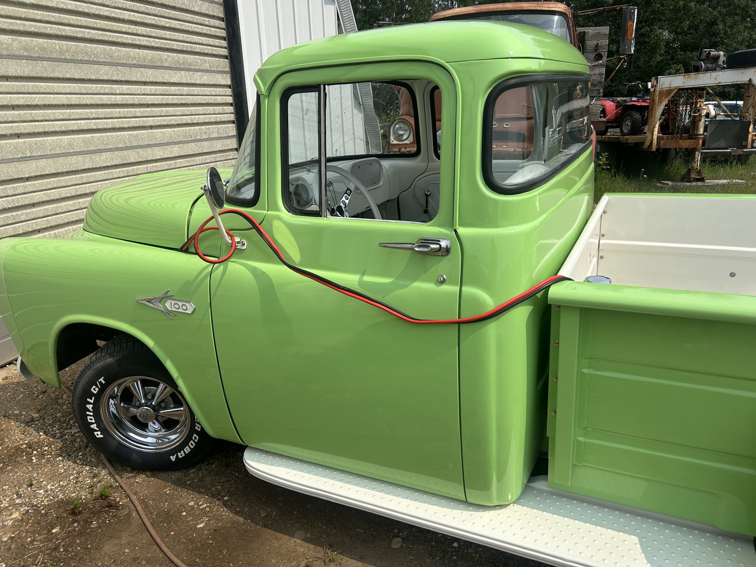

    Voltage regulator quit on the Fargo, found out when it wouldn’t start outside my kids school this morning, it’s a half hour home so my wife brought booster cables, I stopped and bought a battery and drove home like this. The battery is under the floor, the cables are on the starter post.

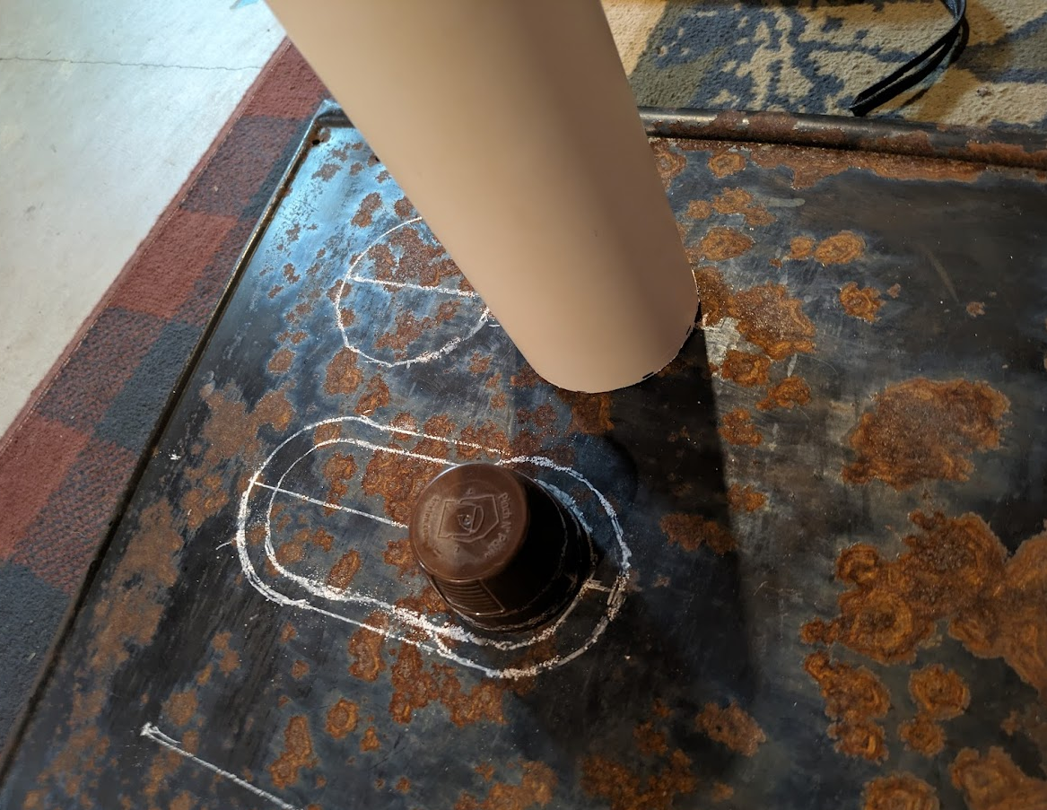

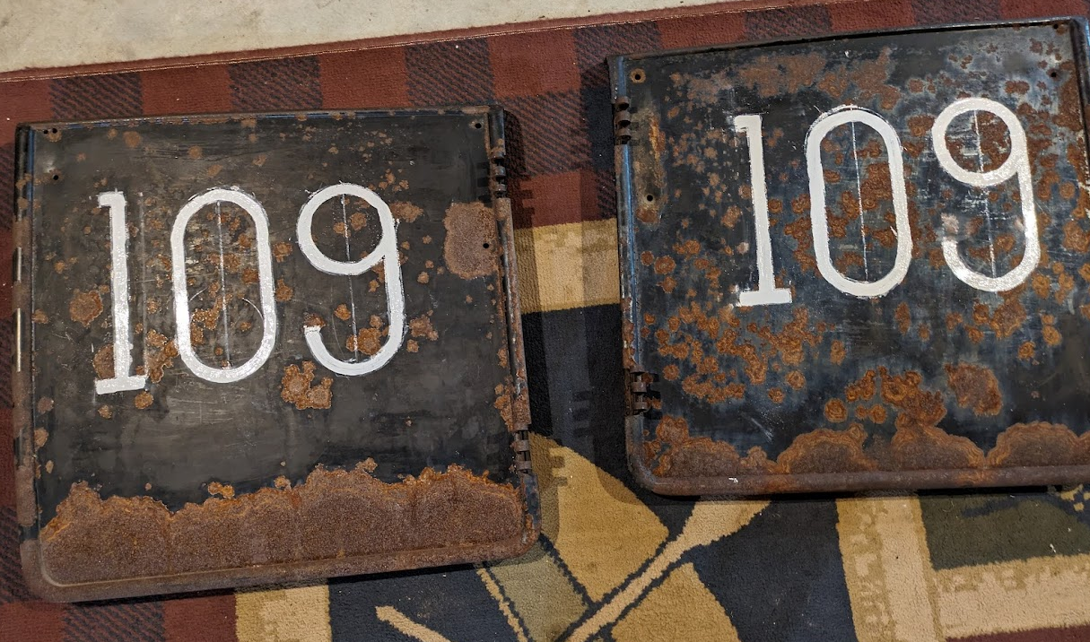

    Drew out some numbers for a friend's T/A banger racer project.
    PVC pipe & a spray bomb cap for radius. Radii? The round parts.
    Finished lay out in chalk. Look close, you can see where I moved the 1 closer to the 0 from my first attempt.
    Had the wife hand paint them, as her hand is probably a little steadier. Used some old white urethane that probably should have been thrown out. Added a little enamel reducer to thin it. Waiting for it to dry to wipe off the chalk and see if it needs any touch up, but I'm sure it's good enough.
    I did the hand painted skinny numbers thinking it would look more era correct than taped off lines & fatter numbers. The owner (friend) & builder (brother) seem happy with it.

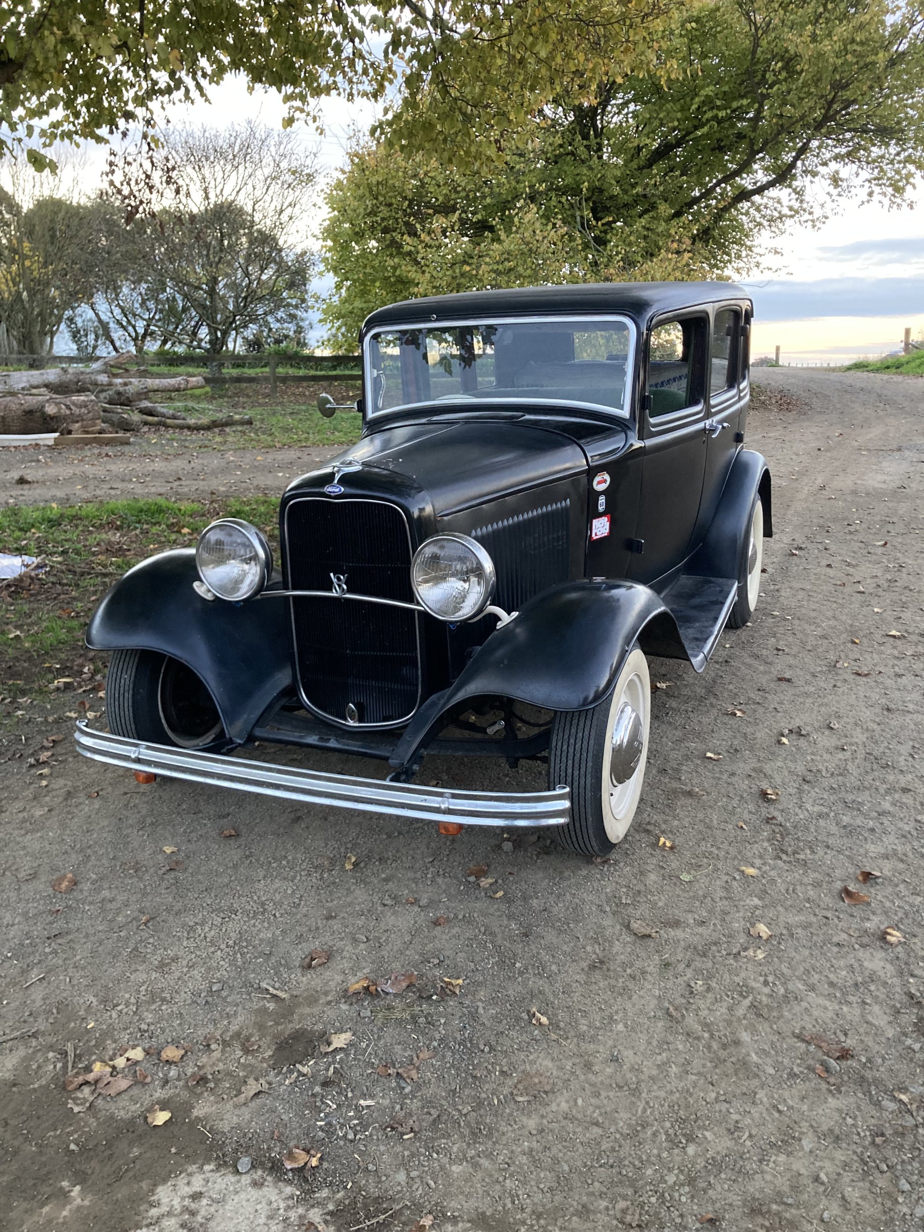

    Got the new windscreen frame and new glass in some time ago, but only just started to drive it again.
    Needs a few more things tidied up…….

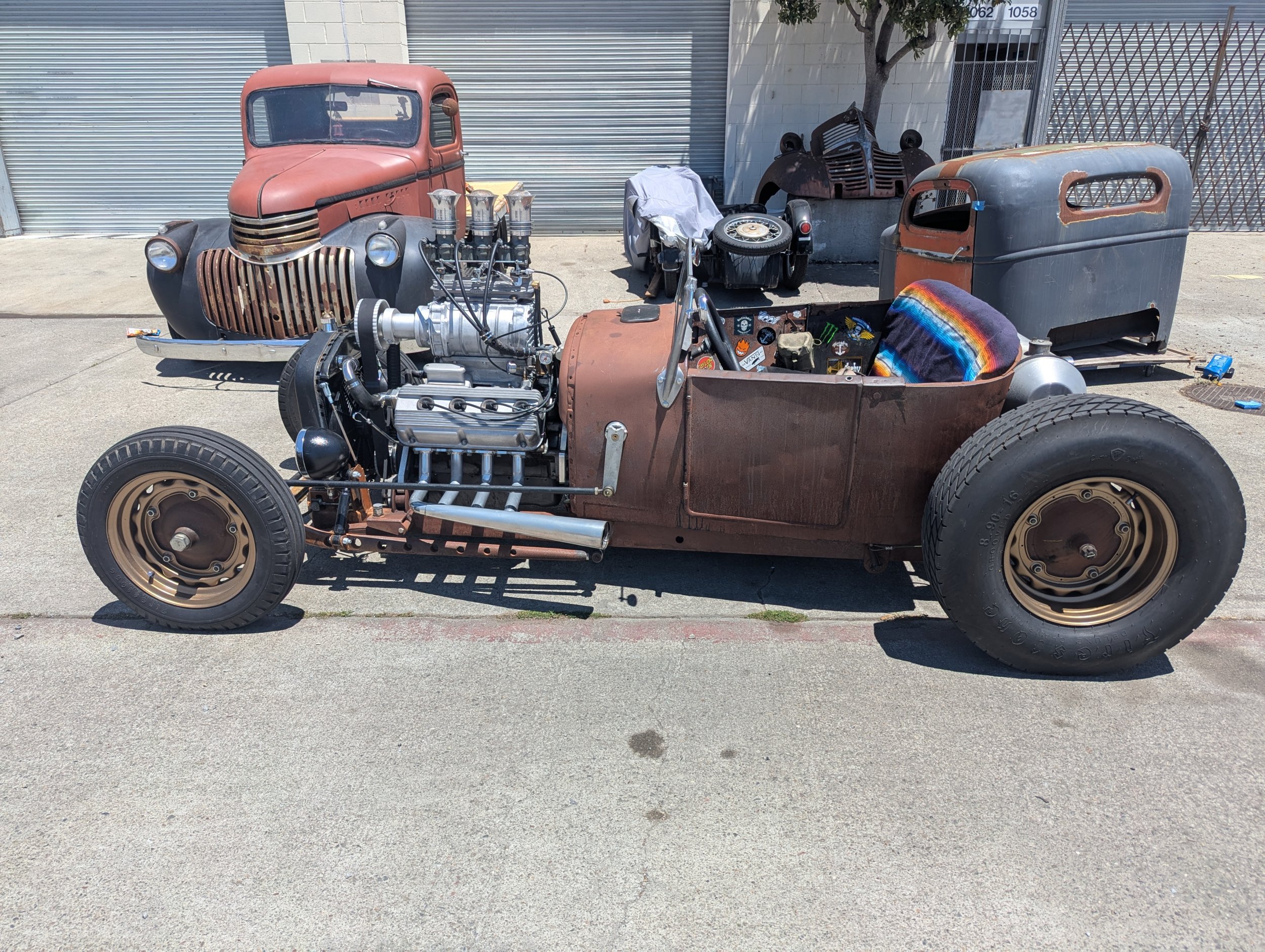

    I just finished tuning this.
    I intentionally took it over all the hills, and in heavy stop-and-go city traffic.

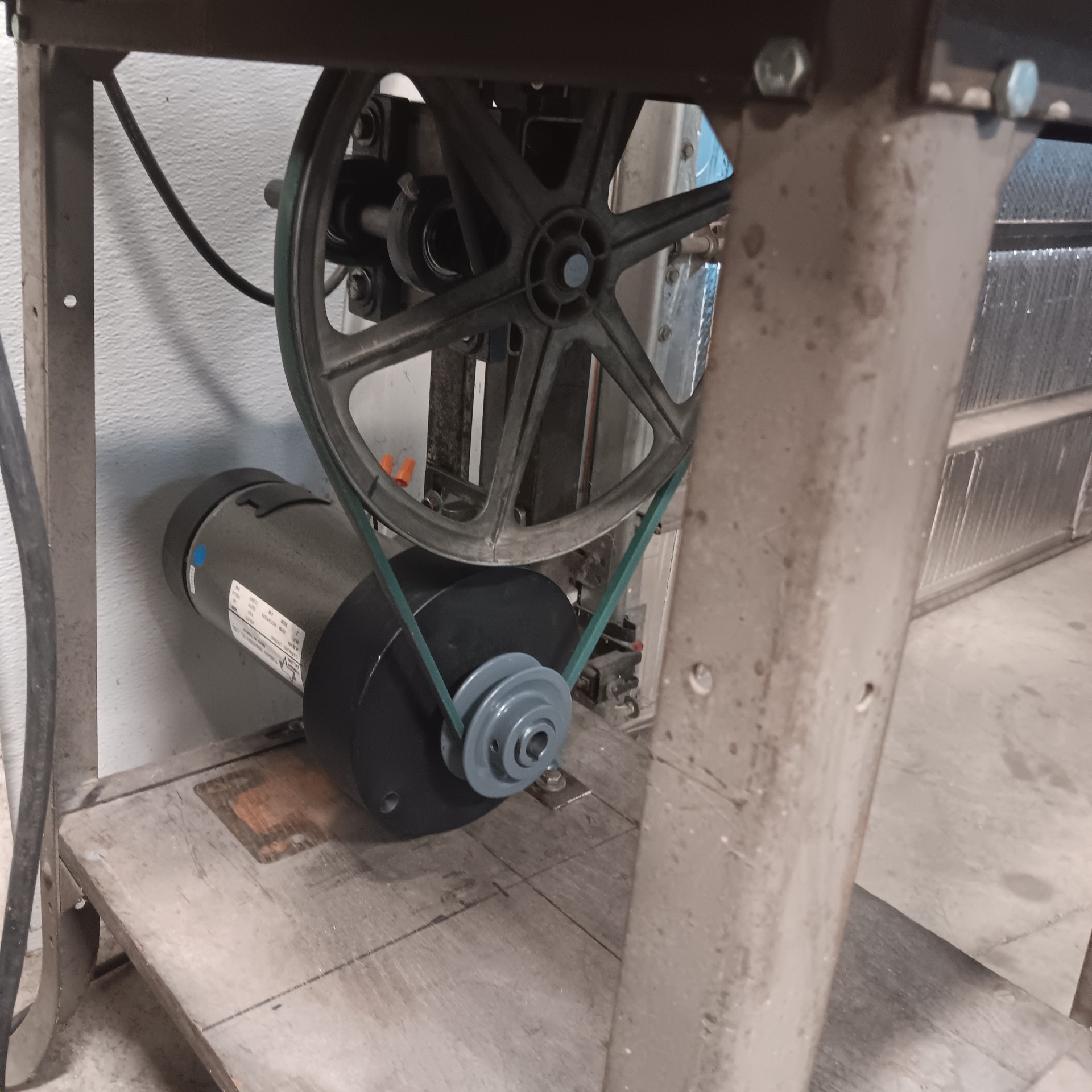

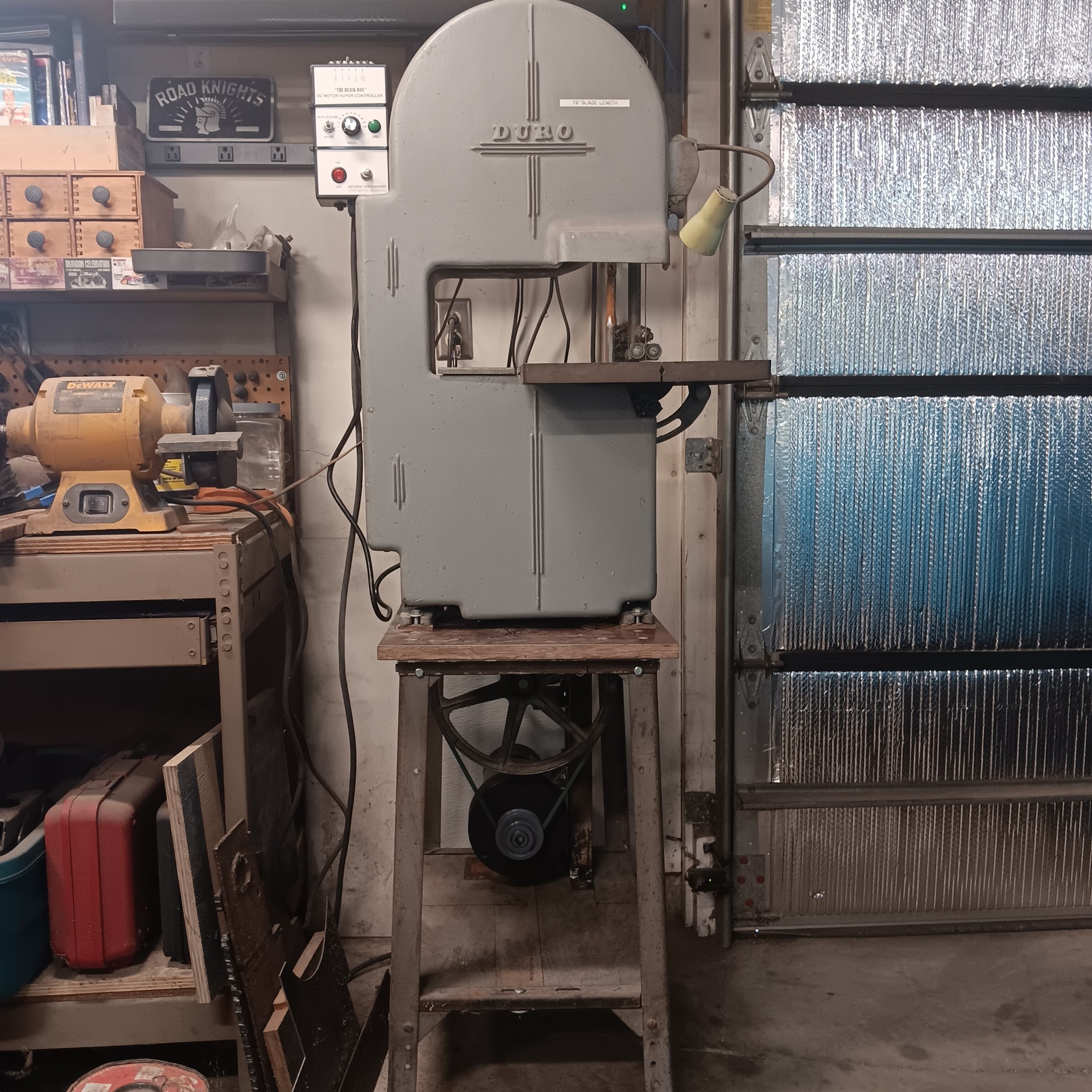

    I built this bandsaw about 30 yrs ago to cut metal by using two 1/4 hp furnace blower motors, one down below as the main driver and one above as a jackshaft to slow it down enough. It has worked well and I've cut thousands of inches of steel with it from sheet metal to 3/8" cold rolled. I could roll the bottom belt off and drive with the upper motor for cutting wood, but it ran too fast and had a lot of vibration.
    My son, who works on and sets up gym equipment, gave me a treadmill motor and I just got done refitting it on the saw with the motor, a variable speed drive and a pillow block jackshaft. It should work better. So far I've only cut the piece of 1/8" to make the bracket for the drive, but I think it works better.

    Thanks! The customer is over the moon!
