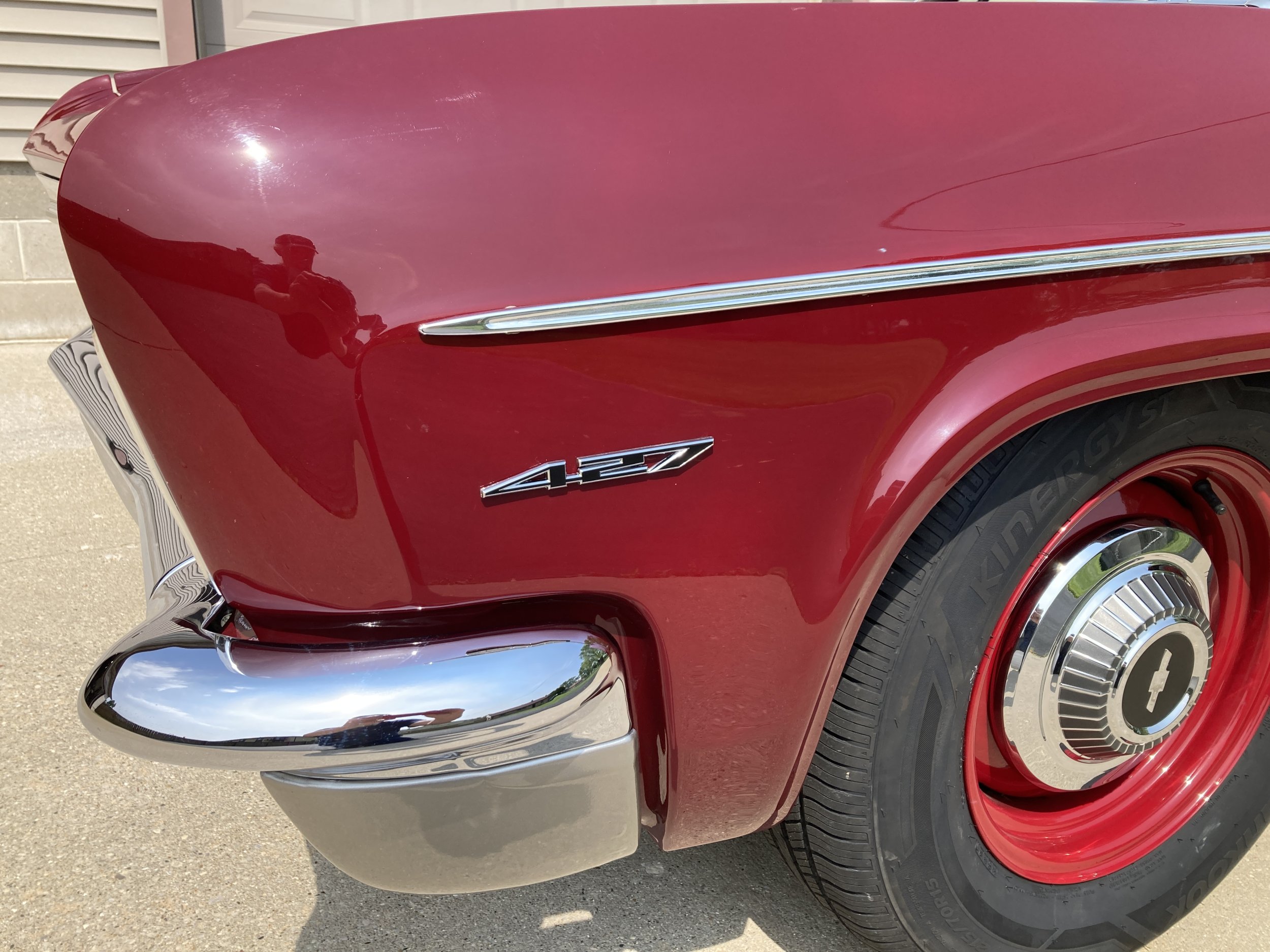

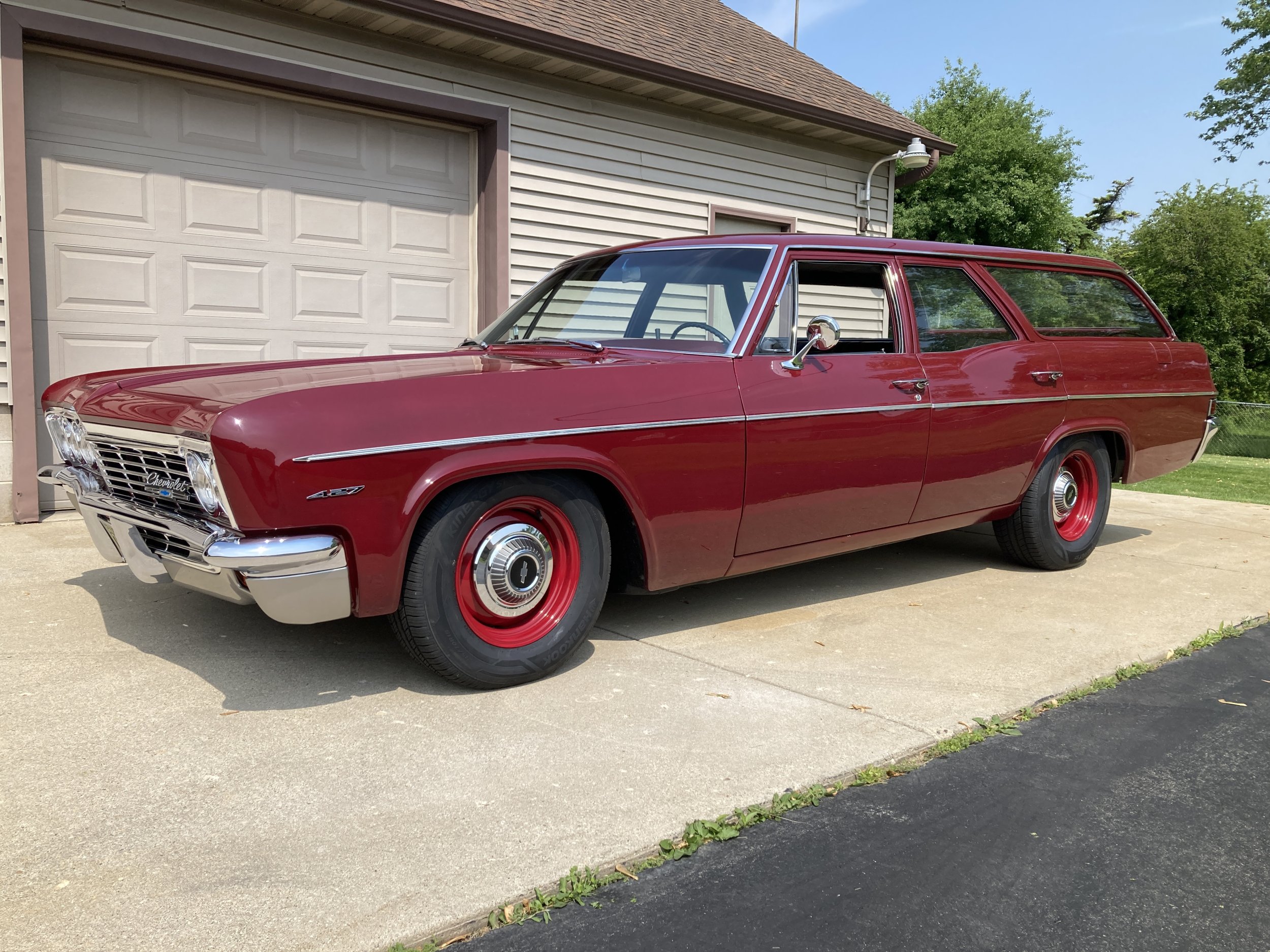

  2. Gave my wagon new shoes and stance, also a little clue this ain't your grandma's wagon. IMG_3421.JPG IMG_3422.JPG

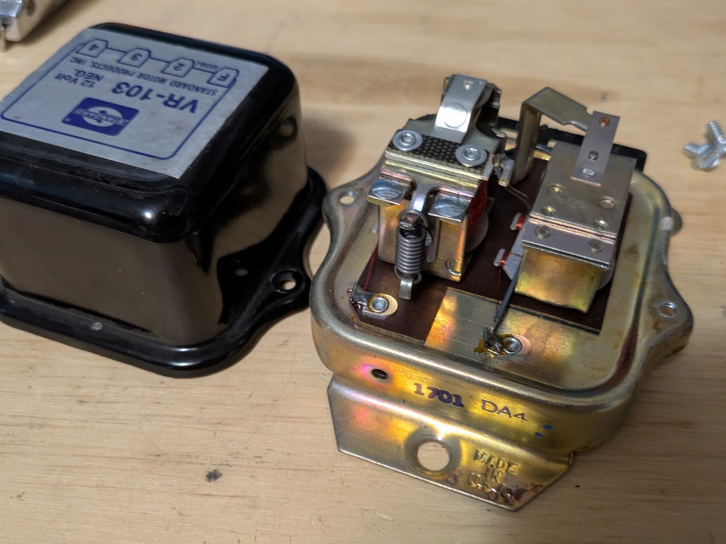

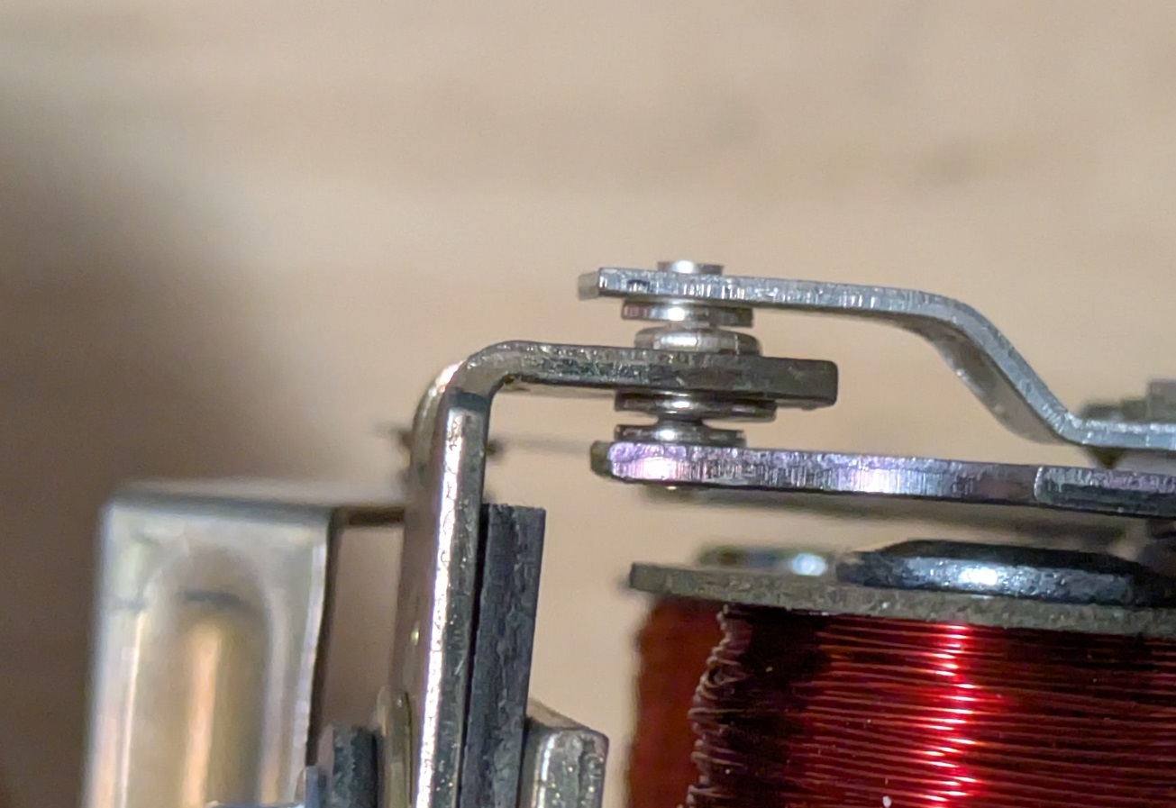

    Drove the corvette to the hardware store to get plumbing supplies for the house. Started to leave, the stereo quit, and then I noticed the ammeter was pegged full charge, 30+ amps. I keep some stuff in the car for fixing things, including the old voltage regulator that had been seeming to not charge quite enough. And a volt meter. Volt meter confirmed 18v at the cigarette lighter socket. So I swapped out the regulator, and it was happy again.
    When I got home, I opened it up. I think the date code means 2017, I got it as old stock on ebay.
    looks like the problem is some contact material transfer, causing it to "lock" in the full field position?
    maybe I'll give up and put a 10SI on it.

    Can you not adjust the original regulator?

    I'll give it a try...and cleaning the contacts might help, too.

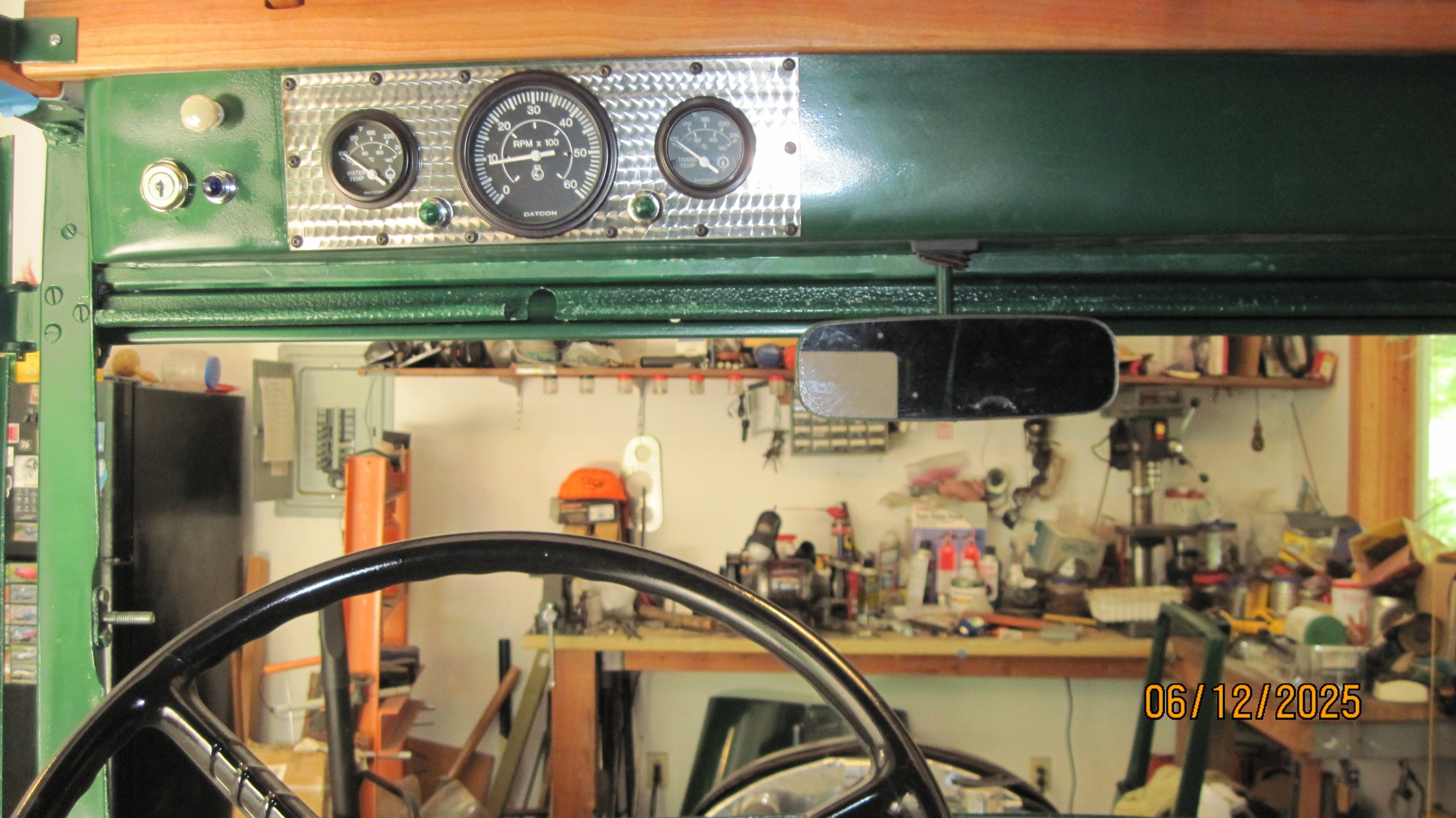

  20. IMG_2336 - Copy.JPG IMG_2338.JPG IMG_2339.JPG Just completed wiring the dash and overhead console on my '29 A truck cab. I put the trans and engine temperature gauges abreast of the tachometer, the ignition, light and hazard switches, left, right and hi-beam indicators and rear-view mirror all in the overhead console above the windshield. The speedometer, volt, fuel and oil pressure gauges surround the horn button in the middle of the stock dash.
    Next will be wiring the turn signals, brake light switch, fuel sender and lights. I think I can get that done in a few weeks, don't you? Then it's rebuilding the carburetor and hooking up the throttle linkage, buttoning down the floor, spinning the oil pump to get some lubrication to the crank and top end, cranking the engine without plugs in to get the oil pressure up, adding coolant and fuel, installing ignition wires and spark plugs, checking the firing order and timing, starting it up and running it in. Probably going to do the run in without mufflers and tackle that issue once I've got it down to idle.

    I have High Requency TIG machine , bastard would not work . Opened it up contacts stuck . Burnished them , worked fine until the day I sold it . I think you’ll be fine cleaning them

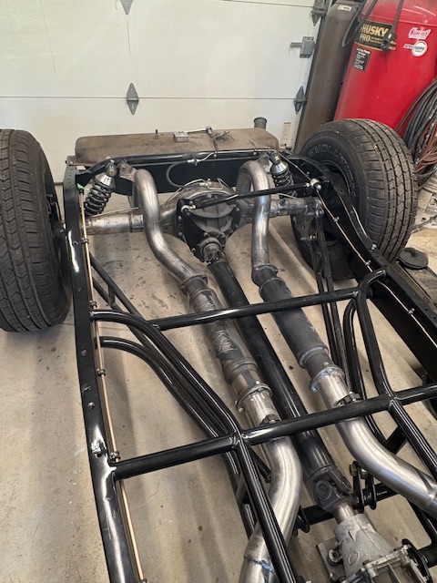

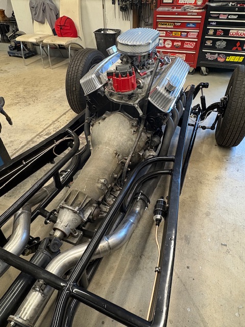

    Exhaust system complete, tight squeeze, I hope it sounds good.
  27. Robdski
    Joined: Jun 28, 2024
    Posts: 133
    Robdski
    3” all the way back.
  28. I thought it was bigger like 3 1/2, I run 3 on mine as well.

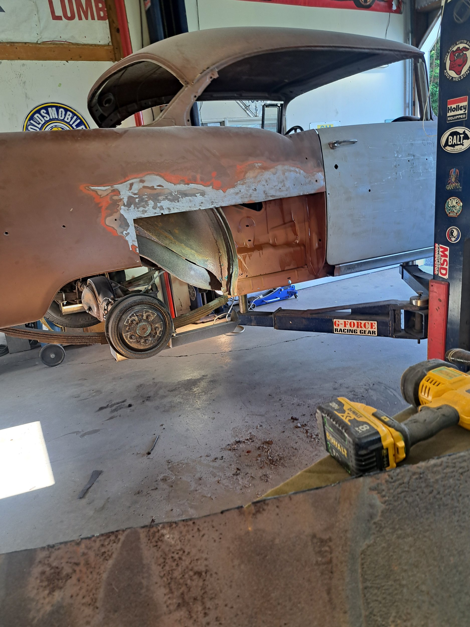

    20250530_094924.jpg 20250606_133605.jpg Quarter patch and floor in the '55. Rockers done.
