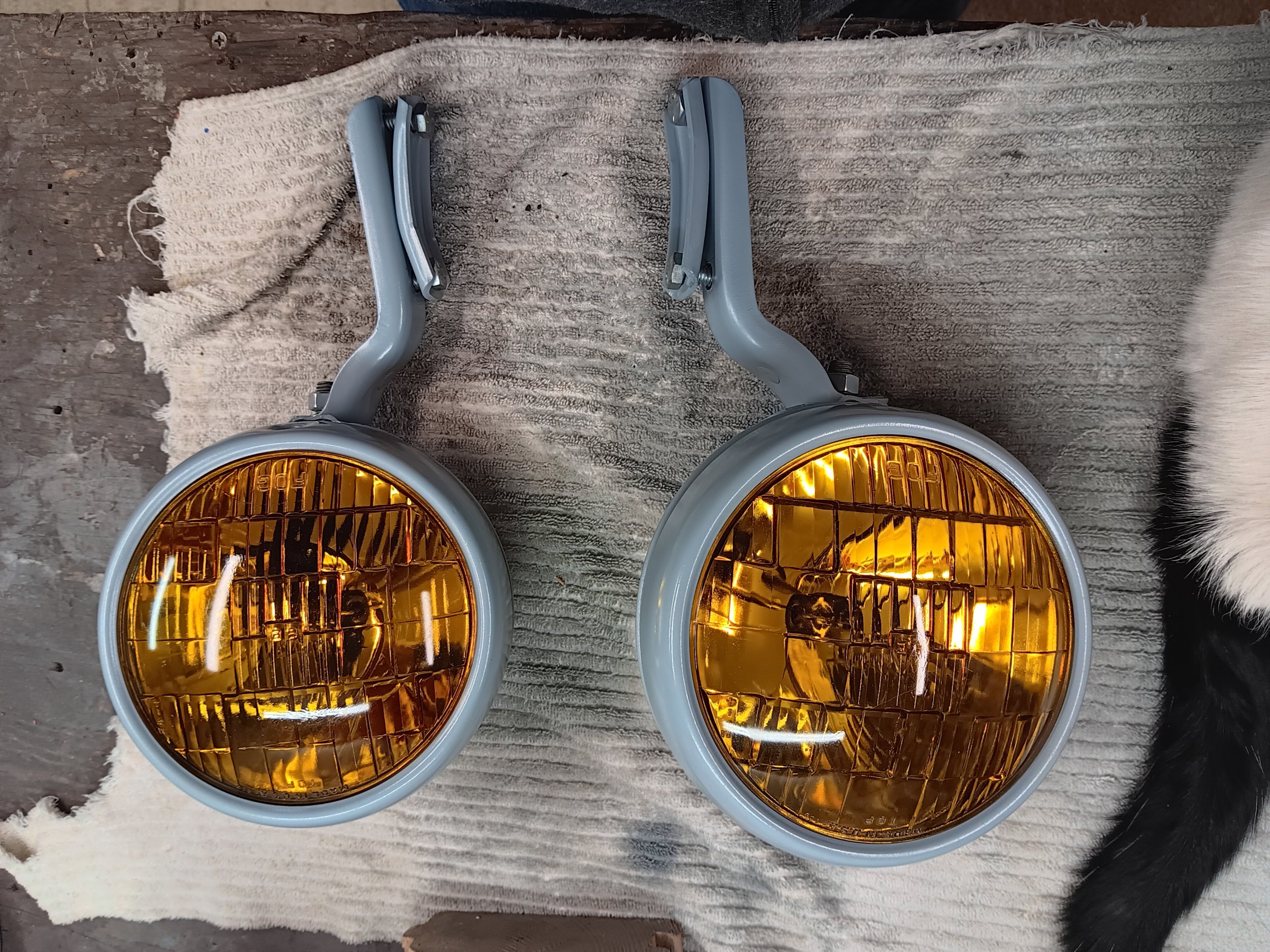

    20250112_112929.jpg Fog lites for my 38 Dodge Coupe'.

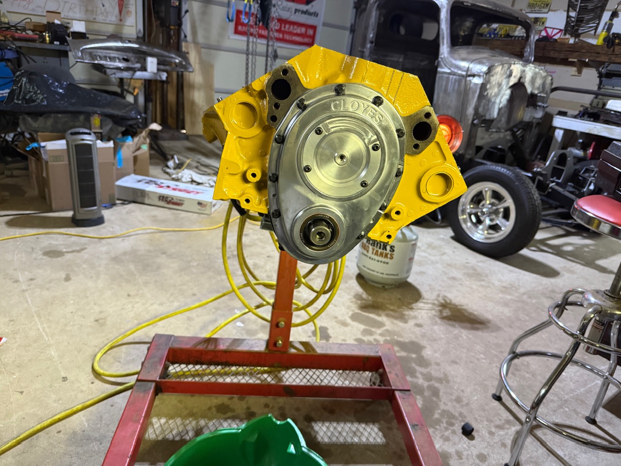

    Guess what? Moon finned timing covers for SBC don’t fit Sbc’s. Now everything has to come back apart. Poop.

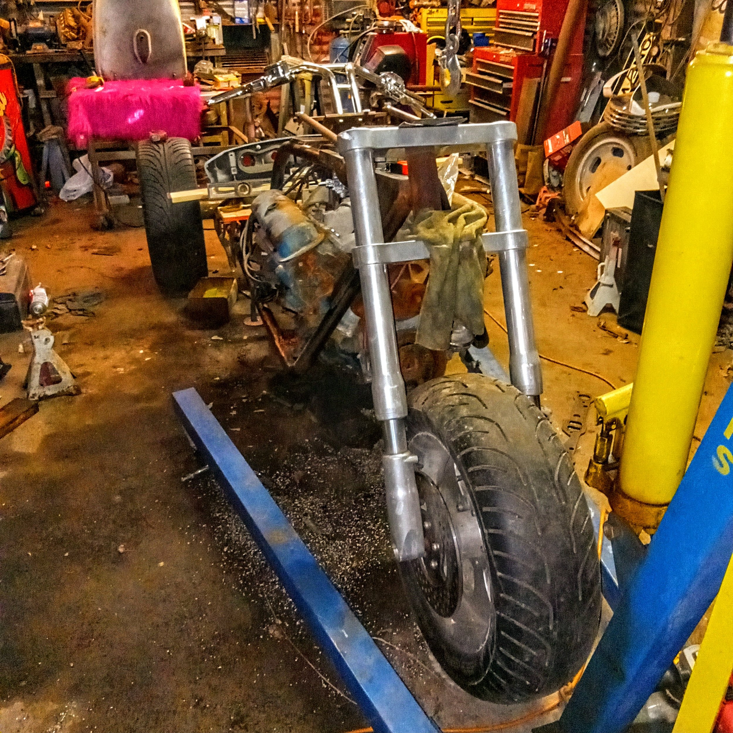

    Not a car but Pontiac powdered trike

    I bought a cloyes instead. I don t have a way to mill it down.

    I’ll be using a long pump, so should be good there. Got a cloyes cover instead. There is no way the moon will work. With the cam cover on it’s so far away from being seated.

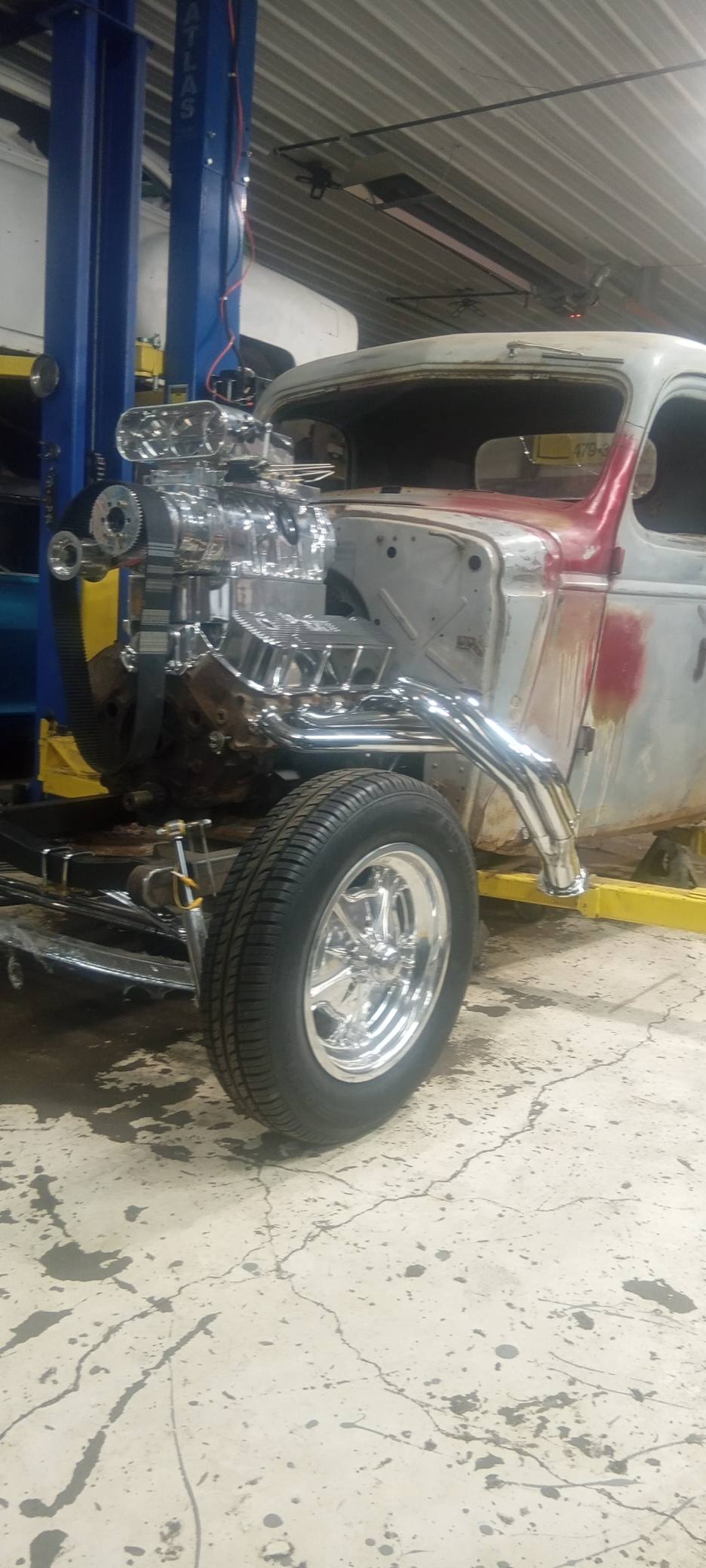

    Working on engine mounts. 473831055_9482732278417640_5954636530524856755_n.jpg 474070012_9482732575084277_2045772165027464284_n.jpg

    Is that an intercooler between the blower and manifold?

    Just a spacer to give more room for dist.

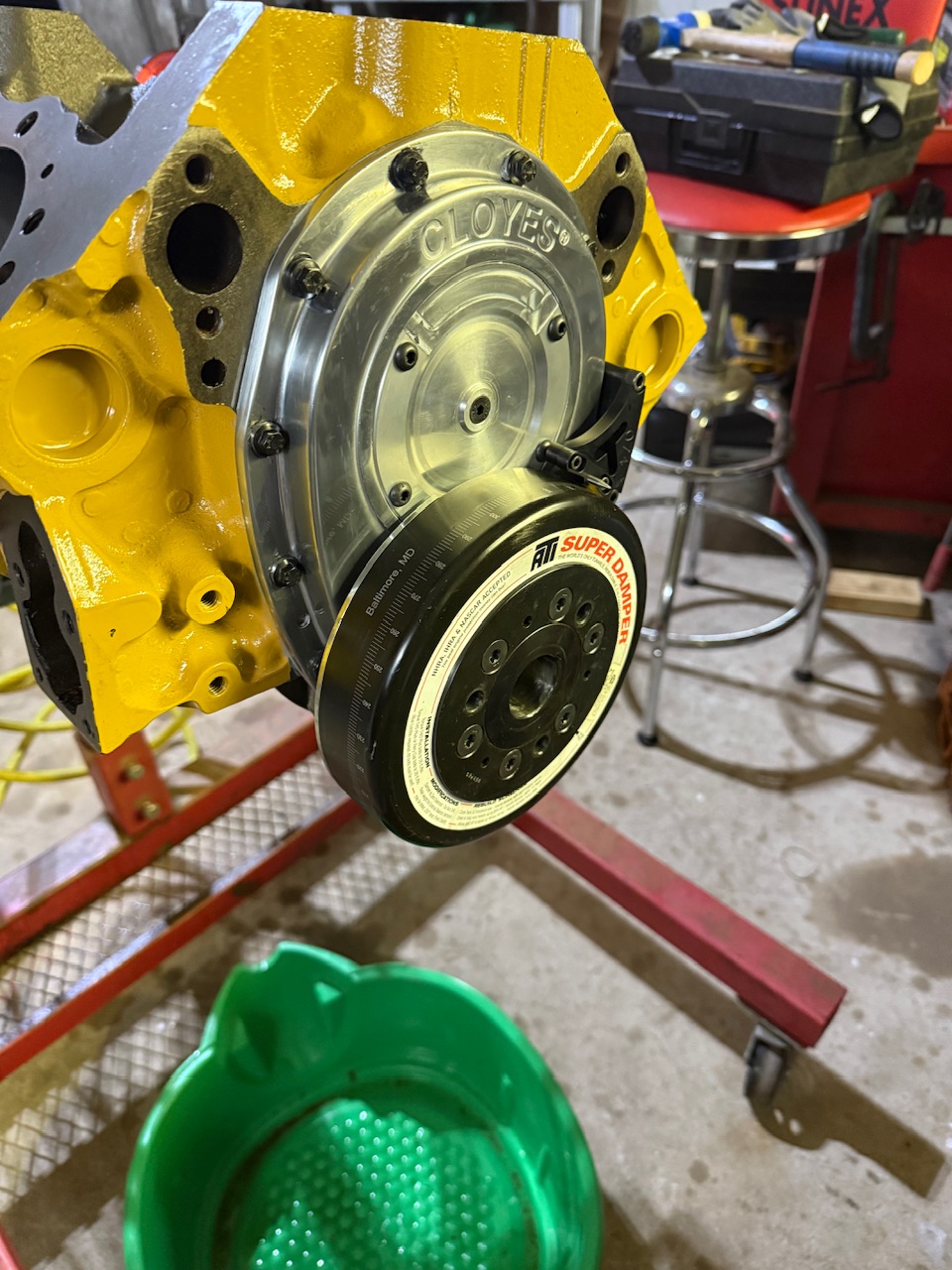

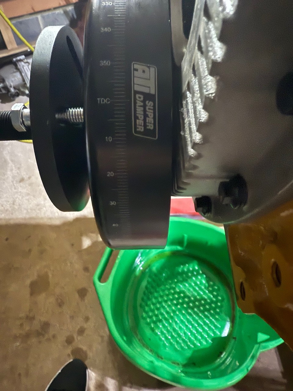

    Fixed. Cloyes cover was thinner, everything fits like a glove now.

    Flanges were the same width. The moon cover was 1/4” thicker, the removable cam plate was another 1/4” and the socket head screws holding the plate on stuck out another 1/4”. The moon cover is just not made for a normal damper of any type.
