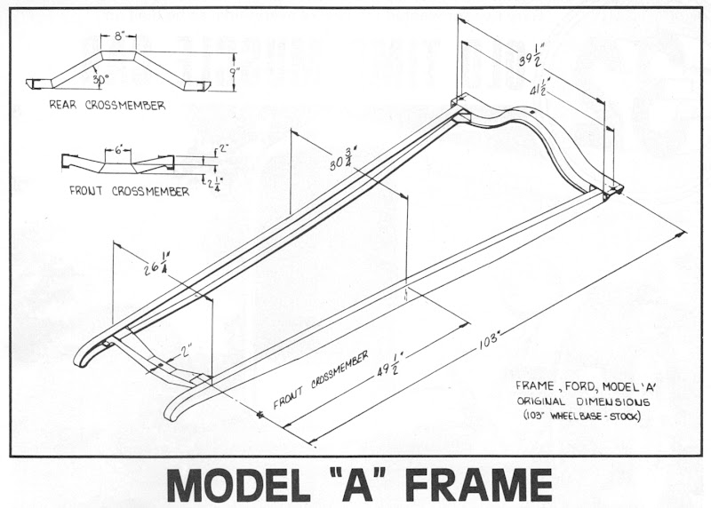

  8. This might help.
  9. Mark H
    Joined: May 18, 2009
    Posts: 1,461
    Mark H
    from Scotland
    Got this one on the HAMB.May be of help.
    Mark
