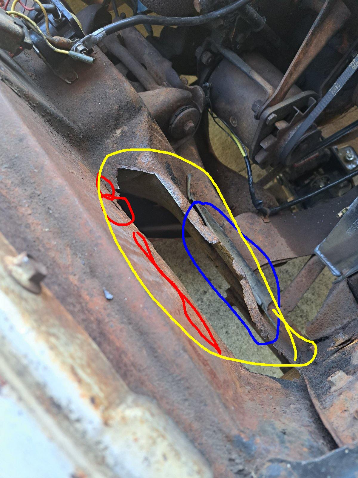

    This is way past the point the OP is at. He has to get to the point he can lay a bead, then that bead needs to be able to hold two pieces of metal together. The OP would do well to watch several videos on welding sheet metal. Hint, if the guy showing you how to weld is not wearing gloves, and is not wearing safety glasses when he grinds, look for a different video.
    This should be a one piece of metal patch. Start out measuring the area to find out how large that patch is going to need to be. With the measurements in hand, cut a piece of cardboard (I recommend the cardboard your favorite 12 or 24 pack beverage comes in) that is a couple inches larger then the finished patch will be.
    Card board that thickness can be bent much like metal bends and will pretty much hold the bend. If you screw it up, you can tape another pierce onto it, or toss it and start over. Start where the bends are close to 90 degrees. Measure the cardboard so it is a 1/2" longer then the distance needed to cover the hole to the first bend, and make that bend. Clamp (2) 2"x4"s on the cardboard and bend the cardboard around the edge of the wood. Then measure to the next bend, mark it on the cardboard and make that bend. Once the parch piece is formed, trim the edges to match up with the edges of what the patch would weld to. When the cardboard is fit to the hole, lay the cardboard out flat against the patch metal, and use a marker to draw around the outside of the cardboard. Cut the metal a little larger then needed, and form your bends, do one bend at a time. Lay the patch over the hole, trim as needed, clamp it in place, and weld the patch in. Way easier then cutting up a bunch of parch pieces and welding them together.

    Thats exactly my point .... making that patch with all the compound curves in one piece will be very difficult. You will need every tool in the shop ... sheet metal brake, shrinker stretcher , power hammer, everything you got & the knowledge to use it.
    While making it one piece at a time you need a vice, a hammer, just basic hand tools.
    Will it be perfect? .... Heck NO! But it will be very good & build confidence & experience for the next patch.
    I like watching this guy, he is very good but sticks to teaching with basic home shop tools.
    I repaired my transmission cover with 13 different pieces of small metal .... looks great & very solid.

    I'm calling BS on this. I've been welding in patch panels for 30 years. I have a home made metal brake (used 2 pieces of 2" x 4" before I built it). You can buy cheap metal brakes at HF. I have a vice, a hammer, and basic hand tools. I learned to use them by practice, just like I learned how to weld.
    I have never had a shrinker/ stretcher, and have never had a power hammer.
    2OLD2FAST, Tman and The_Cat_Of_Ages like this.

  11. luckily Im talking to @alanp561 about his son potentially helping me out.
    i have no intentions of making this perfect. its probably going to be a 3 piece weld, one go bolster the top, one to bolster the thinner side of the piece, hammer it roughly into shape, then fill in the rest. its going to be ugly as hell, but the goal is to make it solid, but hide it with the battery tray.

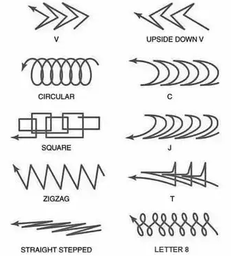

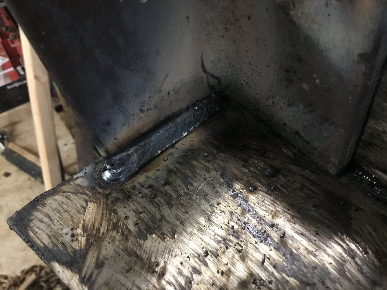

  29. trevorsworth
    Joined: Aug 3, 2020
    Posts: 1,988
    trevorsworth
    Start on thick metal that you can't blow through so quick. Running beads on thick metal (without even trying to fuse parts together) is how you start to learn to strike the arc and control the puddle. Only by doing will you develop the intuition for how your movements impact what the weld puddle is doing.
    You can't learn to weld by reading any more than you can learn to ride a bike by reading. Having someone with experience to guide your hand a little is a big plus but not necessary.
    Here are some tips based on your videos: slow down. The weld puddle has to have time to heat the metal in front of it in order to maintain a good arc and consistent weld. When you strike the arc, hold steady for half a second before you start moving the gun.
    Get your gun angle lower, I usually end up resting my hand on the work if I can. That straight-down angle sucks for making a good bead. Work on a table or get your body lower so you can be more comfortable holding the gun at an appropriate angle. Here is an example.
    Don't move the gun in a straight line. The tip should be moving in a pattern. Every welder develops a personal preference but here are some to try. A circular pattern is easiest and once you get it down will make neat, professional looking welds.
