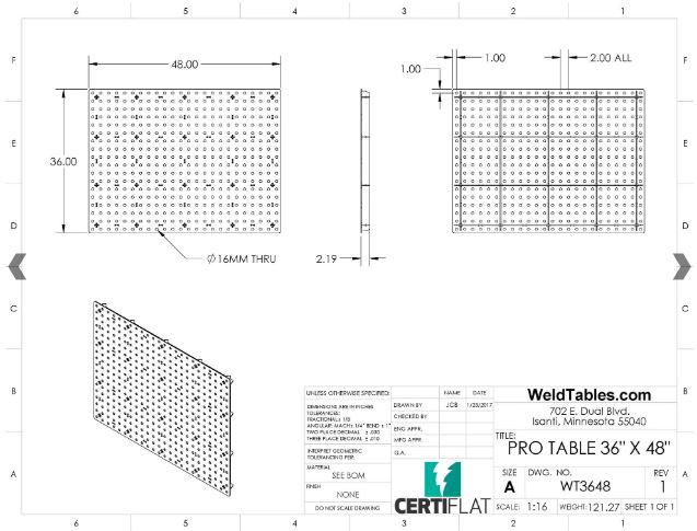

    Very nice. Exactly what you should be doing when retired; making yourself comfortable. A suggestion would be locking steel wheel castors. I had to chase my table all over the place till I got lockers. Ingenious storage! How flat do they claim the table to be?

    Don't know if Certiflat has a flatness spec. It probably wouldn't work if you are doing aerospace precision, but for what I do it's good.

  11. TBH, any flatness specification that's on the plate as supplied is going to be come irrelevant once all the ribs supplied in the kit get welded on to it. Like you write, though, not appropriate for high accuracy / high precision work, but good enough for something on the HAMB.

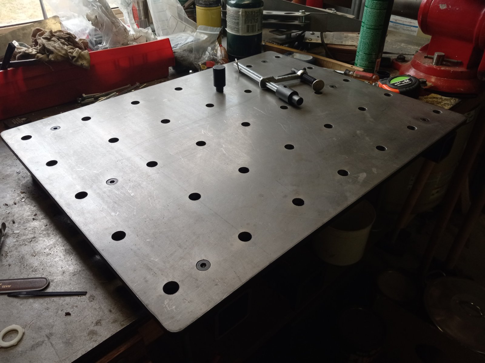

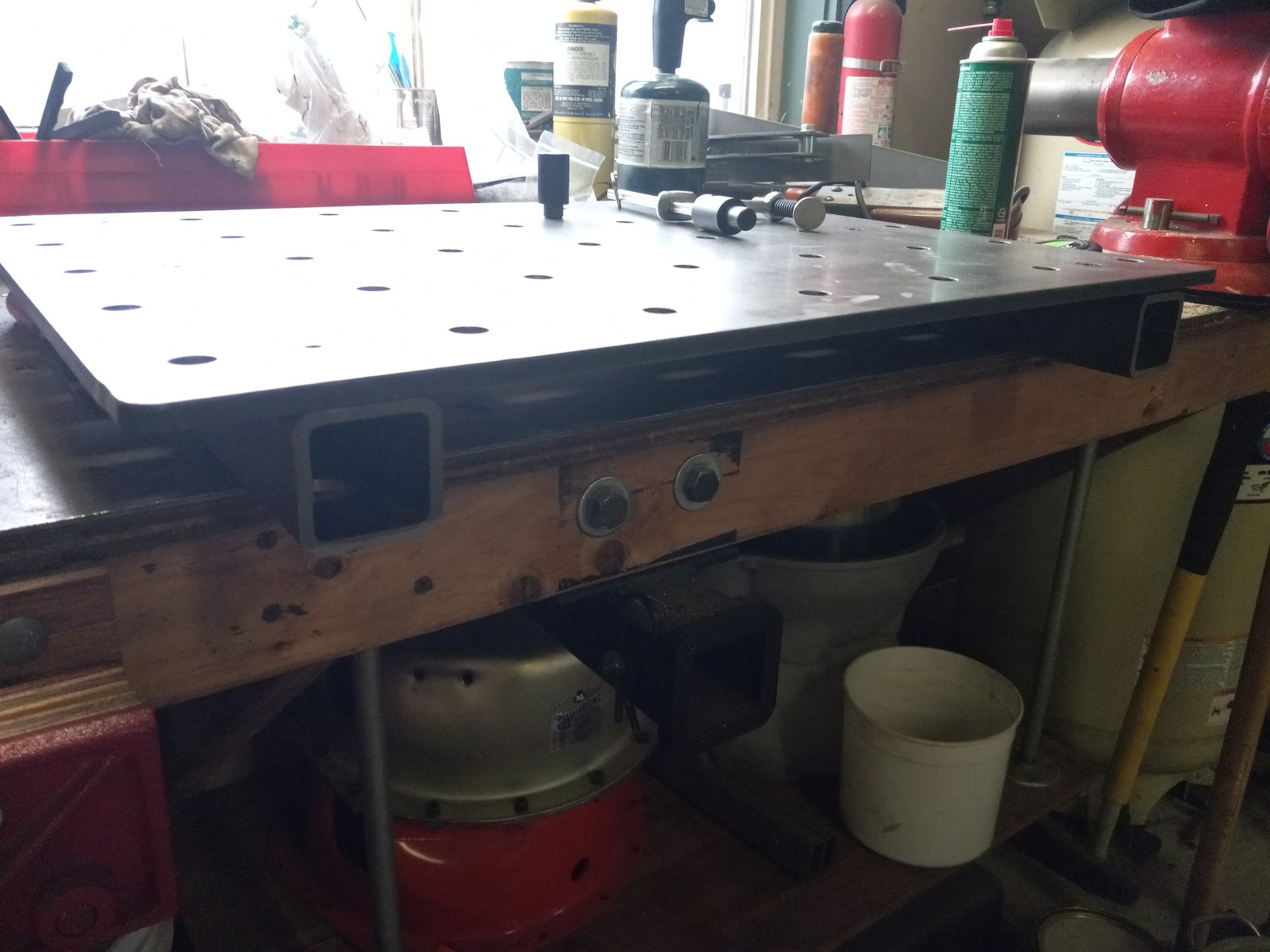

    I like your project. With that top, what style of clamps are you going to use? I had a similar want a few years ago. I wanted a table for smaller projects that require clamping, but didn't want another bench or table in my shop. Most of the welding table clamps rely on the table top thickness to wedge the clamp tight. I went over to my friend's fab shop and found a piece of 3/8" plate and trimmed it up on the water jet. It is 20"X26". Spent part of an afternoon at my drillpress laying out a bunch of 1/2" holes. I mounted the plate on two skids made from heavy wall 2"X2" tubing. I purched several types of welding table clamps. It's portable around the shop, although not exactly lite, and stores away easily.

    Nice welding plate. There are some pretty good videos on YouTube on making budget clamps (again for hobby use).
    Here's an example of one:
