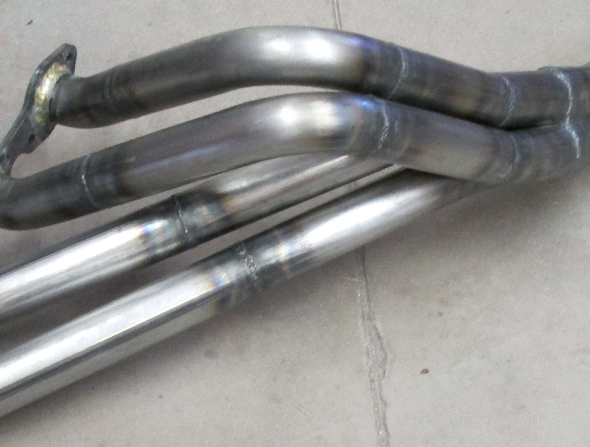

  11. Im with Snaptwo. No gap and little to no filler. Working on a set of headers for my S2D. I tacked with the torch in 2-3 spots then welded it, no mig at all. Clean Clean Clean on the metal
    metal [​IMG]
    and I brazed a fillet on the flanges too, this should prevent any cracking and remove the need to repair.
