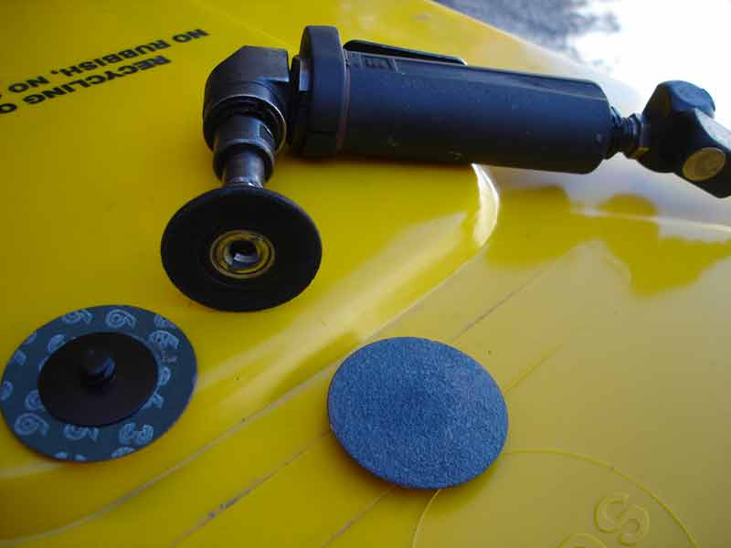

    These 1/4 turn 2" discs rule on an angle die grinder.
