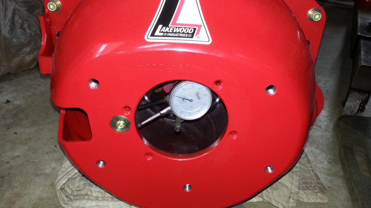

    So I need to pull my transmission and install my Lakewood scatter shield. Sounds like it's gonna be a pain in the ass getting it centered. Any tricks y'all know of to make it easier??
    Get a dial indicator with a magnet base set it on the flywheel with the plunger against the hole and have someone turn the crank as you watch the dial.

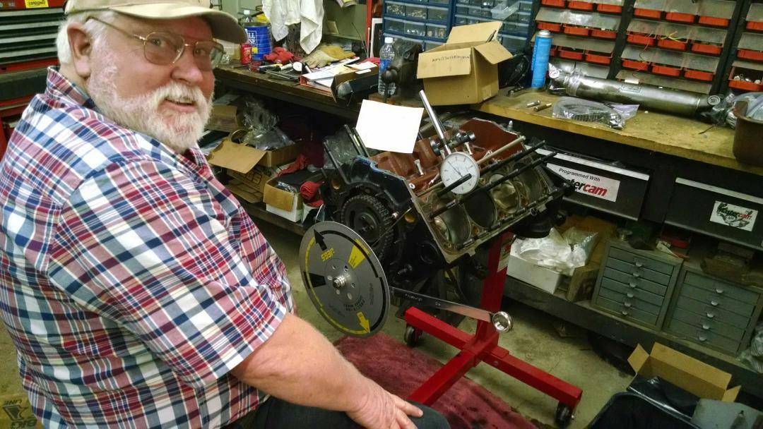

    I was playing with one of those ( dial indicators ) tonight.;)

    Will do. They need to make a centering tool. Fits pilot bearing fits hole , done.

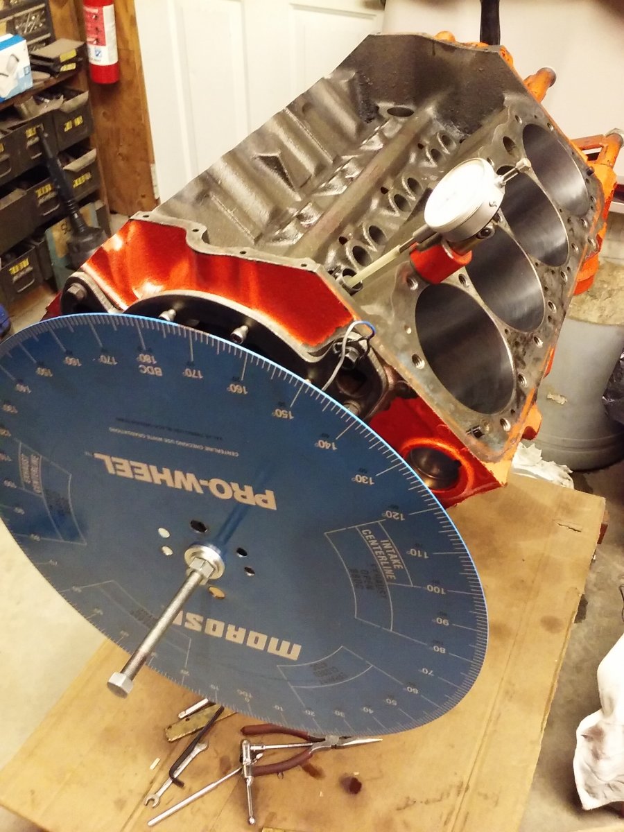

    You know as you get older you need to find dial indicators with bigger dials....lol

  10. dialing in a bell housing isn't too hard. as i take my measurements i write the on the back of the bell. that way i can see the direction it needs to move. i chose a offset dowel then repeat the procedure. having the numbers written down makes it easy to keep track. if you are making changes and it doesn't seem to be working out the bolt holes may need to be enlarged. the bell will not move much with the stock holes. after its all dialed in i put a few tack welds on the dowels. that way it can go on and off without having to go through all of the work again.

    I was a bit disappointed to find when I was doing this with my TKO600 bellhousing and was wondering how much it changed after I removed it and then re installed it just as it was before(using the same dowels). I then rechecked only to find out the run out had changed a bit (up to .004 one time). Spec on the TKO600 run out is .005 and it would move enough to make it out of spec by fair amount. After messing with it a few more times I said screw it and put it together knowing it was only somewhere near the .005 ballpark that was over 20,000 miles ago with no problems. The Muncies and most other older transmissions can get away with a lot more run out than the TKO's can as i undertand. So its not as critical I guess on the older transmissions. This was the first time I had used a Tremec TKO.
