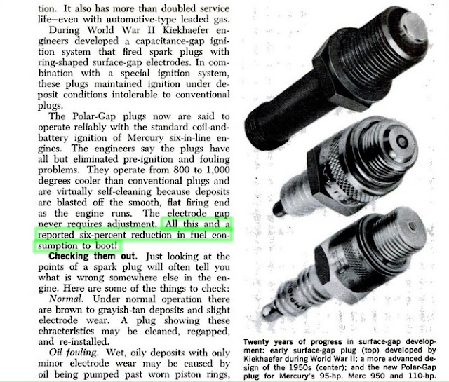

    Always wondered why autos didn't use "surface-gap" or "perma-gap" plugs like Mercury marine used?
    I guess differences in 2 vs 4 stroke combustion chamber and ignition requirements?

    I have a coffee can full of surface gap spark plugs that I bought at a swap meet years ago. The coffee can had "REATH" written on it, and the plugs are early hemi head length. Used Joe Reath hardware?
