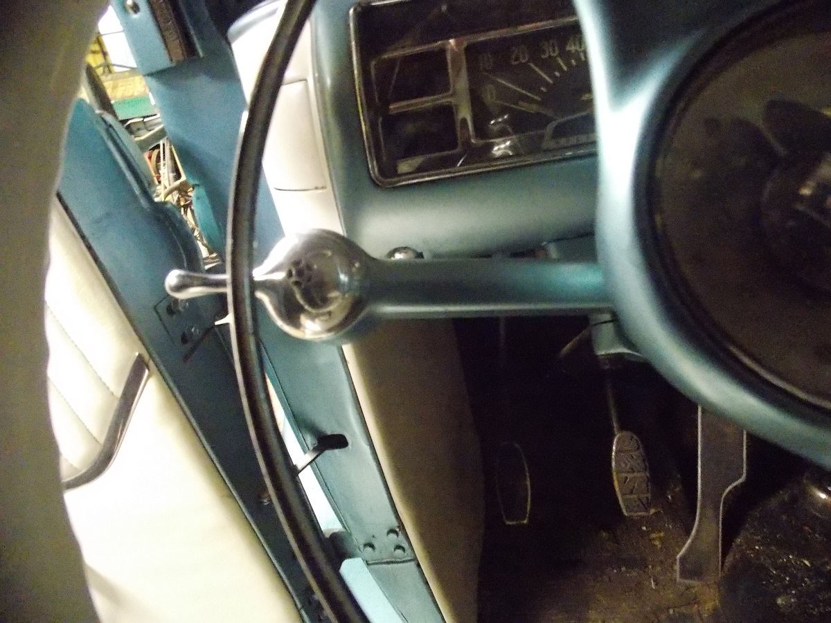

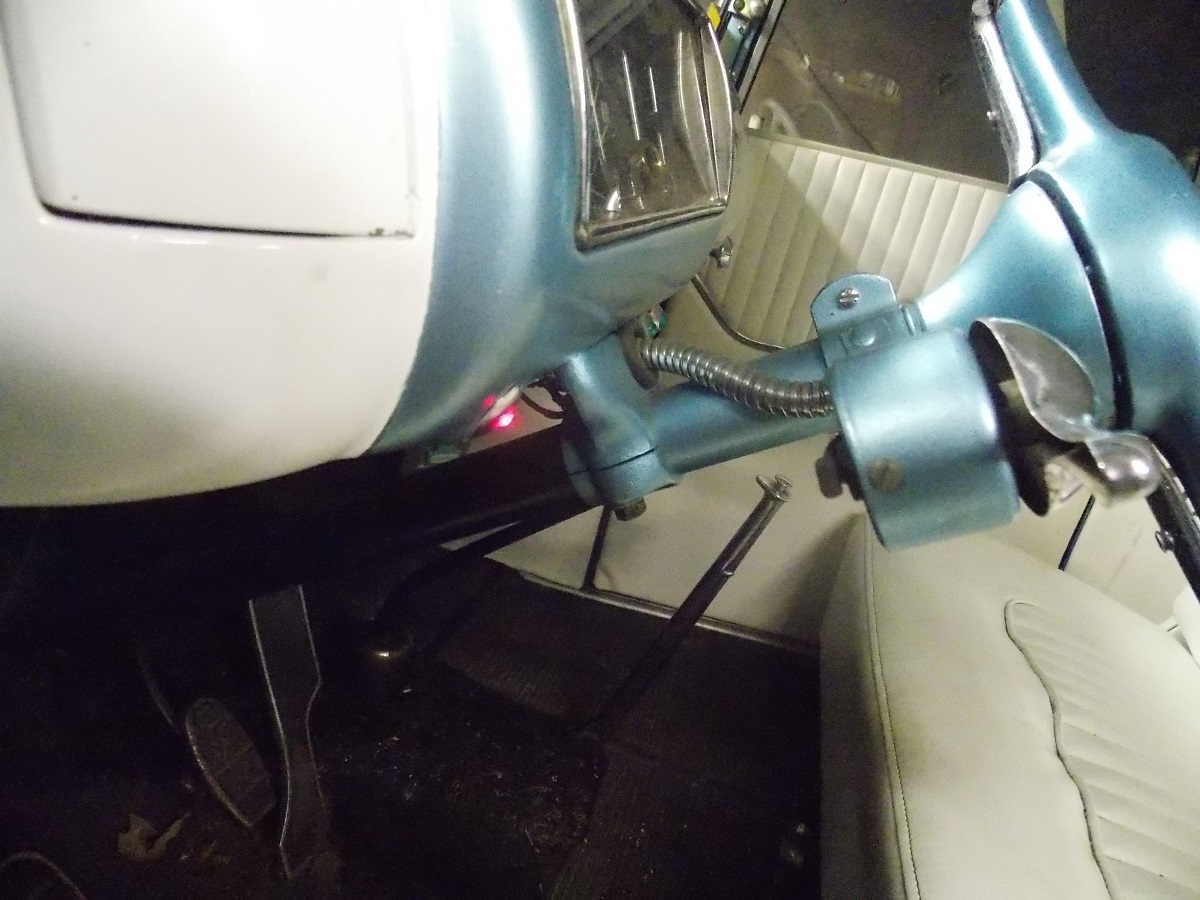

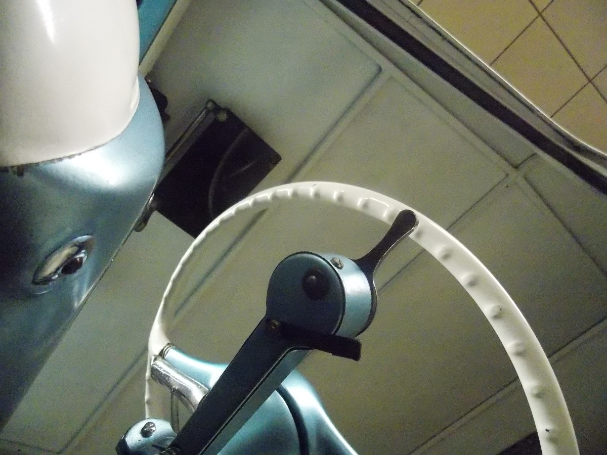

    Ok, I put up a similar question here on the end of my 32 build...no room whatsoever for a floor dimmer, but they asked for pics, and one sharp guy here asked if I could hide a small switch behind my ancient signal light lever housing..
    Here are some pics, I used a SIMPLE (free) stock early 70s VW dimmer relay that I had, behind the kick panel, which only needs one thin wire to trip the relay..a "momentary ground wire".
    I made the contact from the spring-steel part of a set of used ignition points. That is held to that old T/S switch back side cover, with a machine screw to act as a ground from that cover, Then another machine screw, insulated from the cover with a rubber grommet. All that switch does is create a ground each time you barely touch that spring steel lever. I put a thin piece of Vacuum hose on the exposed tip, so the steel tip is not sharp. >>>(one pic here, shows that I swung that contact spring out of the way, so you could see the contact point made from a screw through the grommet. That screw holds the wire to the relay, inside of the back cover)
    The relay is so simple, the three wires that are needed for a floor dimmer, then one new thin wire to the homemade switch. On many cars, there is a thinner 4th wire on the floor dimmer that hooks to the Hi beams, for the hi-beam indicator. I used the old hole for the 40 Ford dashboard starter button, to use a red jewel for high beams. It is "on" in one of these pics. I think the jewel and chrome bezel was from a 56 Olds parking brake warning light, from a parts car I had.
    This was so simple, cost me zero, works sweet, and that Hamber saved the day with his idea. :)
