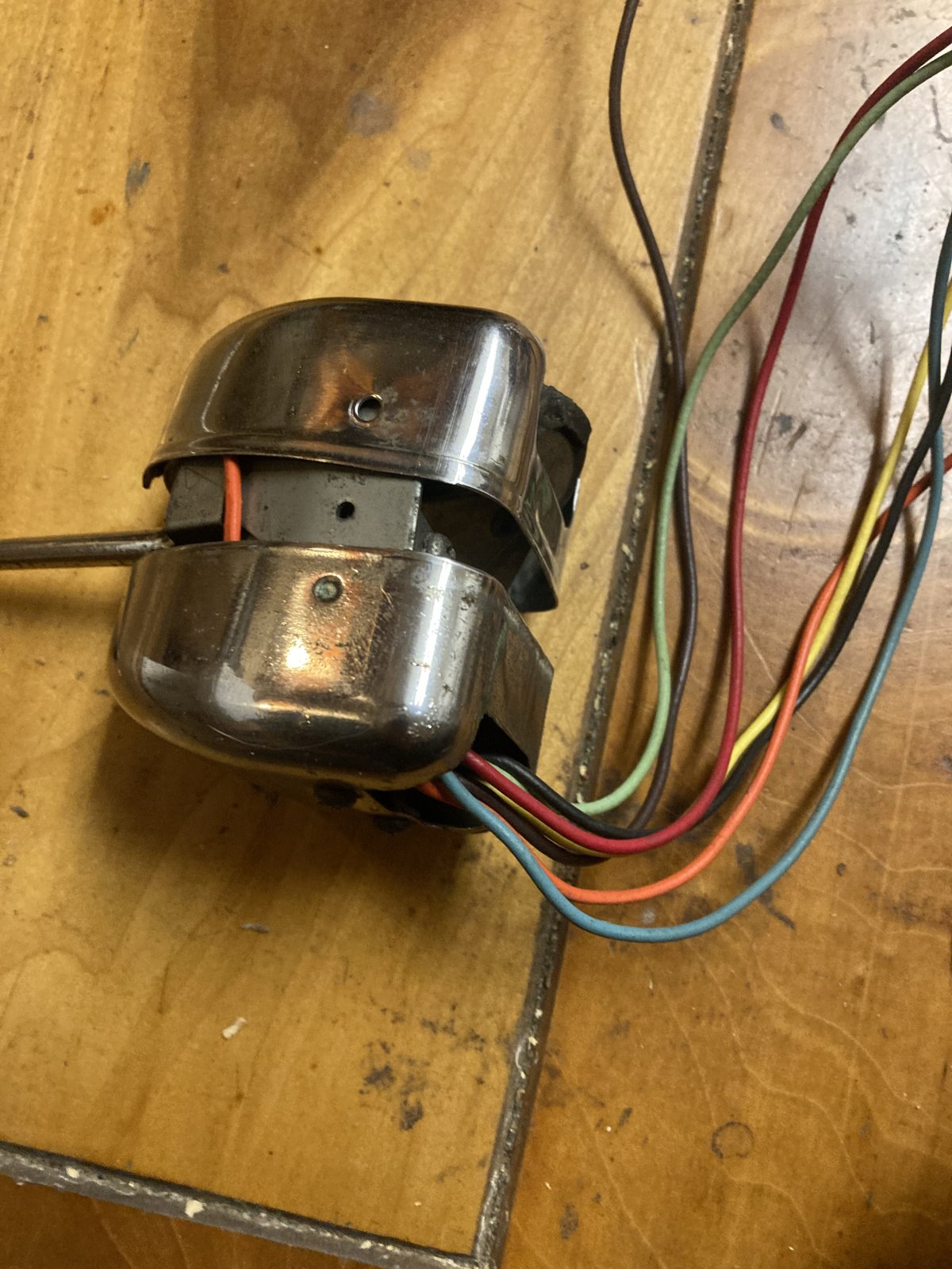

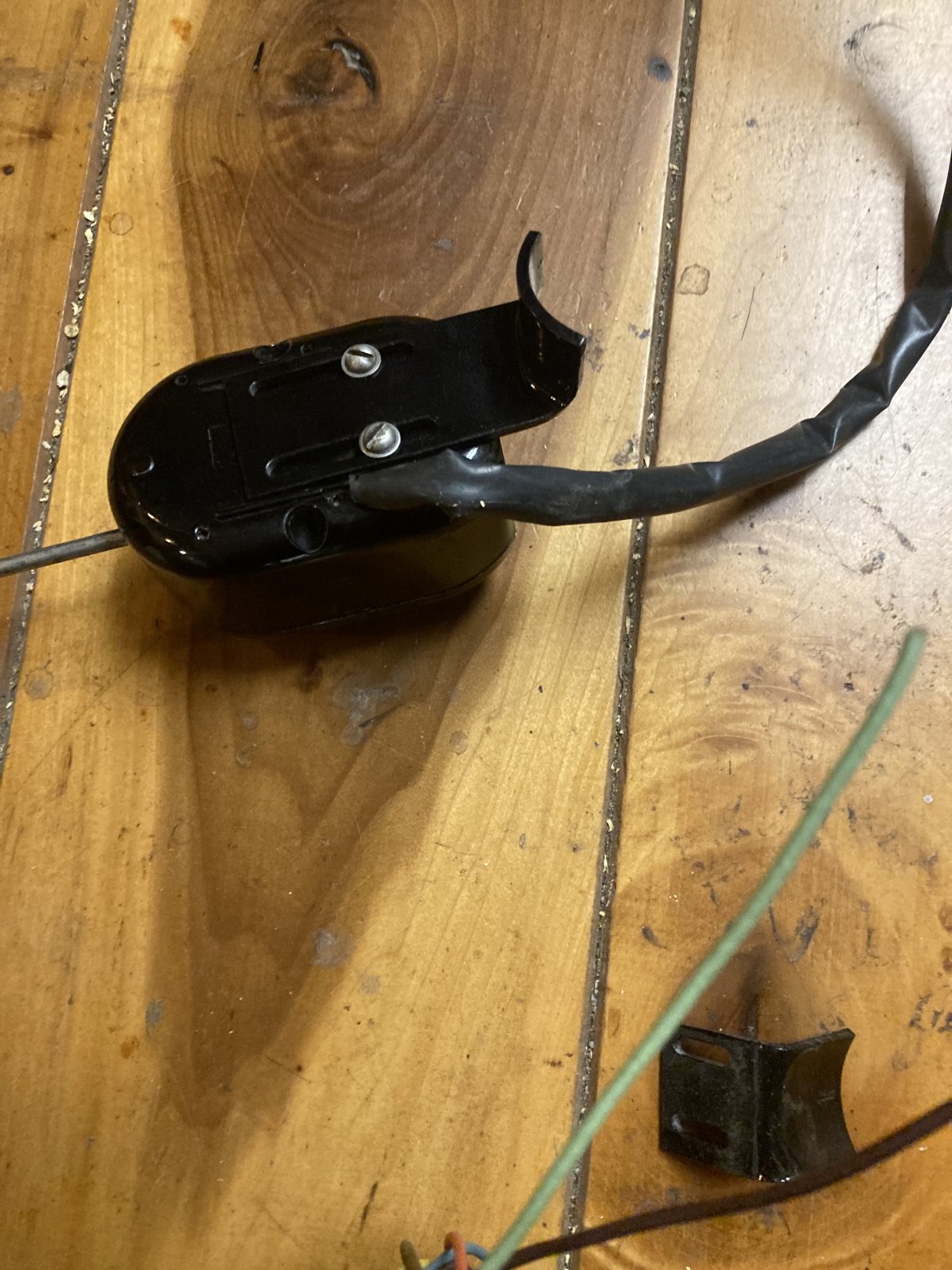

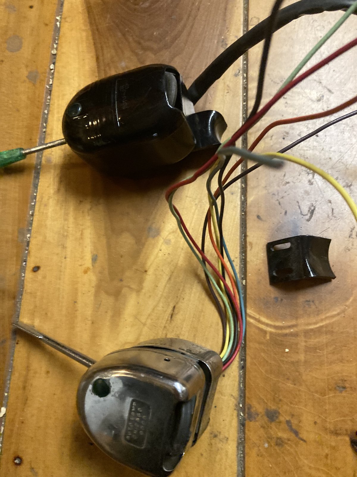

    I have two vintage turn signal switches, one four wire and one seven. I have wiring diagrams for both. The four wire, the black one, has a sliding bracket that fits around the steering column, held in place by a worm clamp. There is a small black wheel that rubs against the column, protrudes when the signal is activated, and should retract when the steering wheel is turned.
    The black switch's wheel will protrude, sometimes, and sure doesn't retract as it should . It also doesn't switch 'all the way' on either left or right consistently. I've only assembled it once and may get it to work properly with enough fiddling.
    The chrome signal is an Auto Lamp, seven wires, and has a very positive action on left and right as well as retracting as it should.
    I do not have a colum bracket for the chrome one, and I seem to recall seeing a photo of a similar unit that had a clamp, sort of like an old flashlight clamp that clamps on the column, and may also be held in place by a worm clamp.
    I have two brackets for the black unit, one short, one long and imagine either will work.
    Thus I'm wondering if anyone can educate me on the clamp for the chrome unit. I prefer using the black unit but not totally sure I can make it function as it should, and am
    positive the chrome unit will work well.
    So any assistance, photos appreciated.

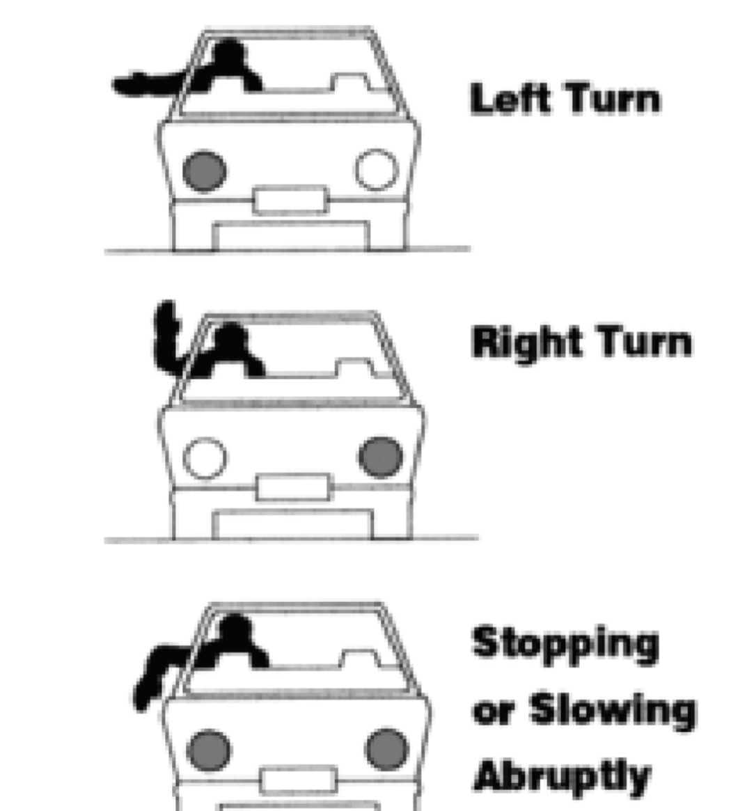

    bschwoeble, lucky ink and lostn51 like this.

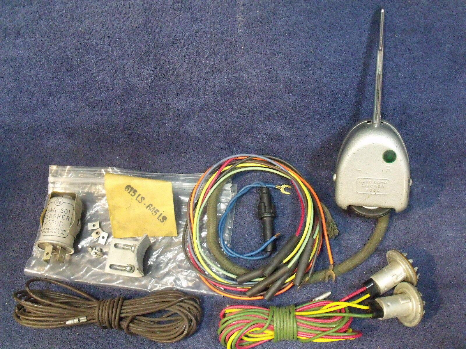

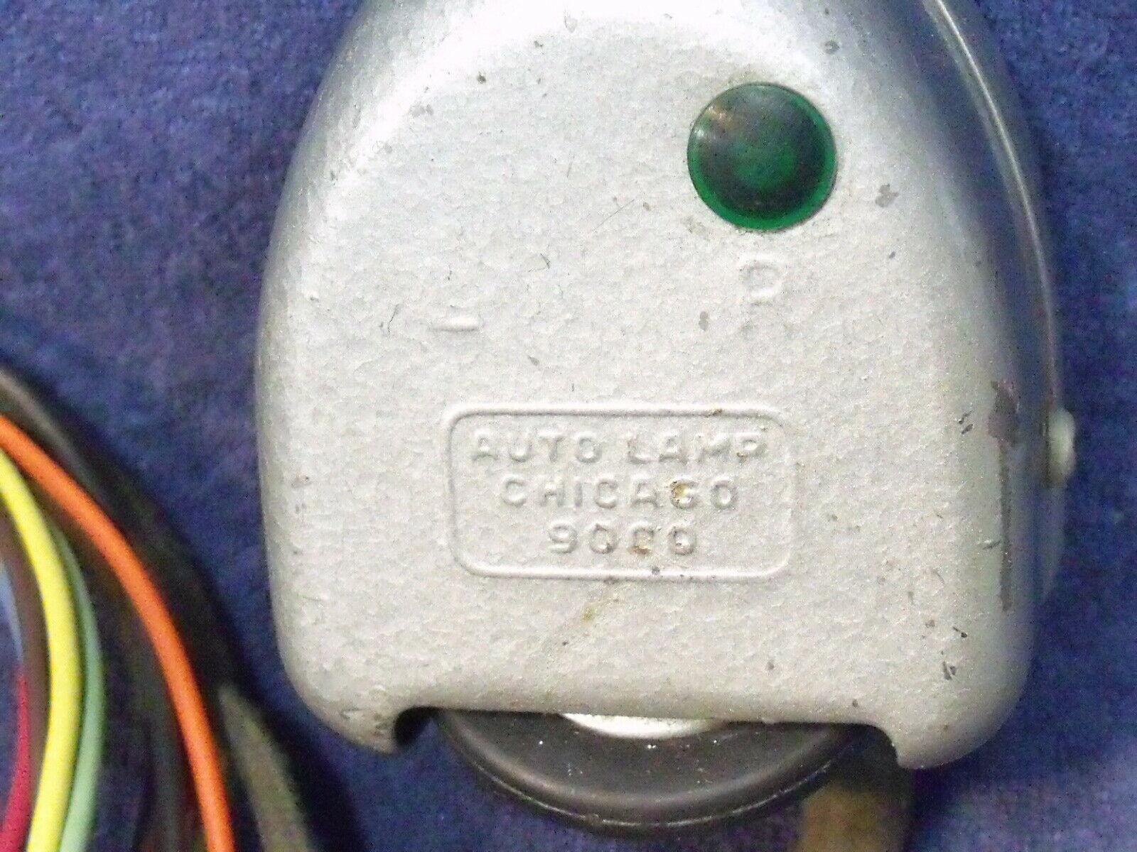

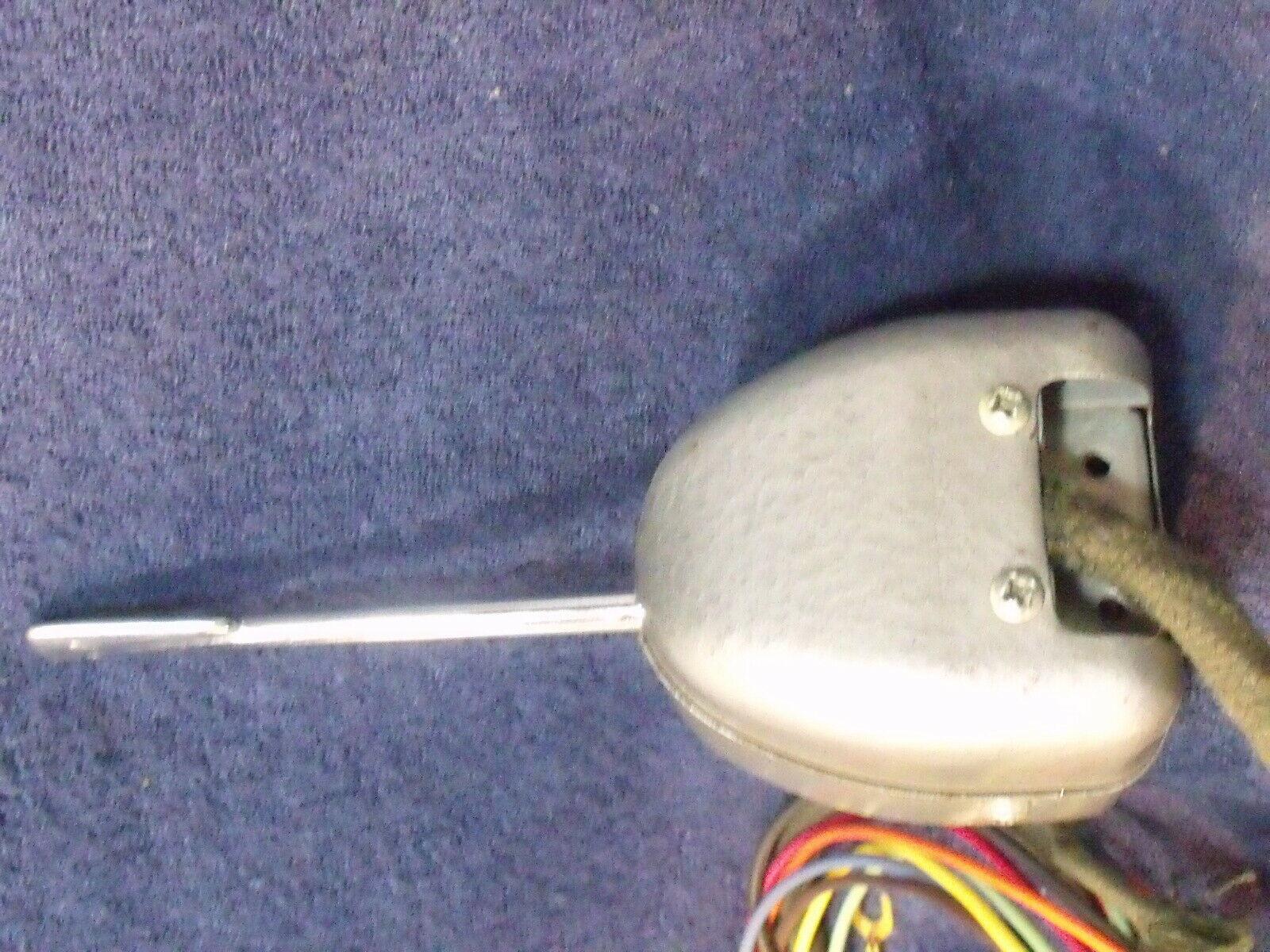

    The chrome Auto Lamp 9000 should have the same type bracket as the black unit to attach to the column with a hose clamp.
    mgtstumpy likes this.

    Great photos but they don't show the bracket. And lo and behold as I was taking the photos I noticed the small bracket was bent at 90 degrees, and it looks like it will fit the 7 wire unit, so my problem may be solved. Regarding the 4 wire unit I've ascertained the rivet holding the wheel has worn a slot in the bracket, vertically, and lets the wheel slop around. The rivet has a washer on it that can stay solid while the wheel turns, so I just socked it full of JB Weld and will wait til tomorrow night to see if that solves the problem.

    The bracket is in the first pic just to the right of the flasher.

    Got it. In fact I have one just like it and didn't realize it...thanks.

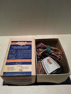

  17. mgtstumpy
    Joined: Jul 20, 2006
    Posts: 9,266
    mgtstumpy
    My NOS Allstate has a cancelling wheel on rear from memory. and attaches to column tube via a hose clamp. allstate indicator.jpg
