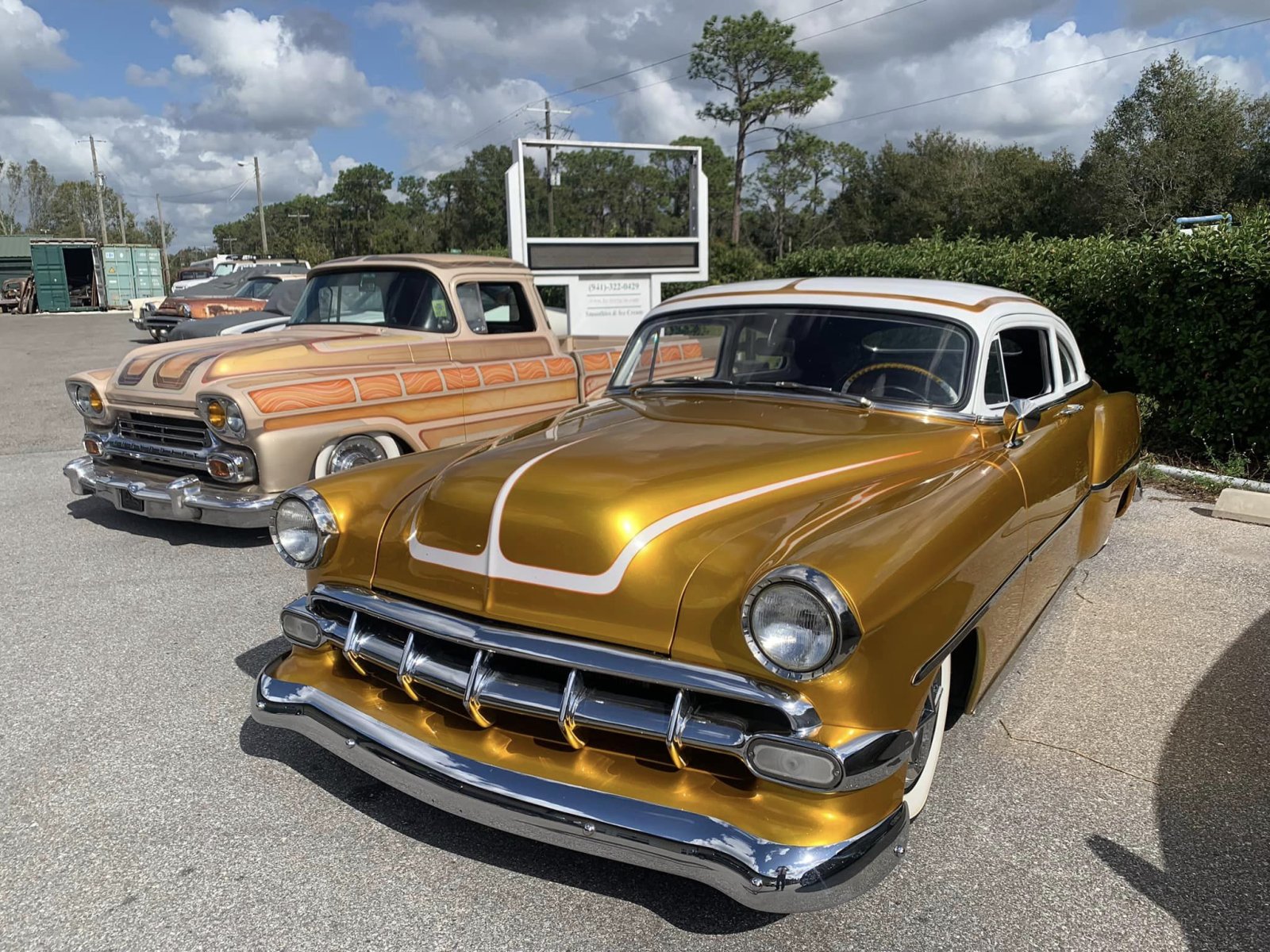

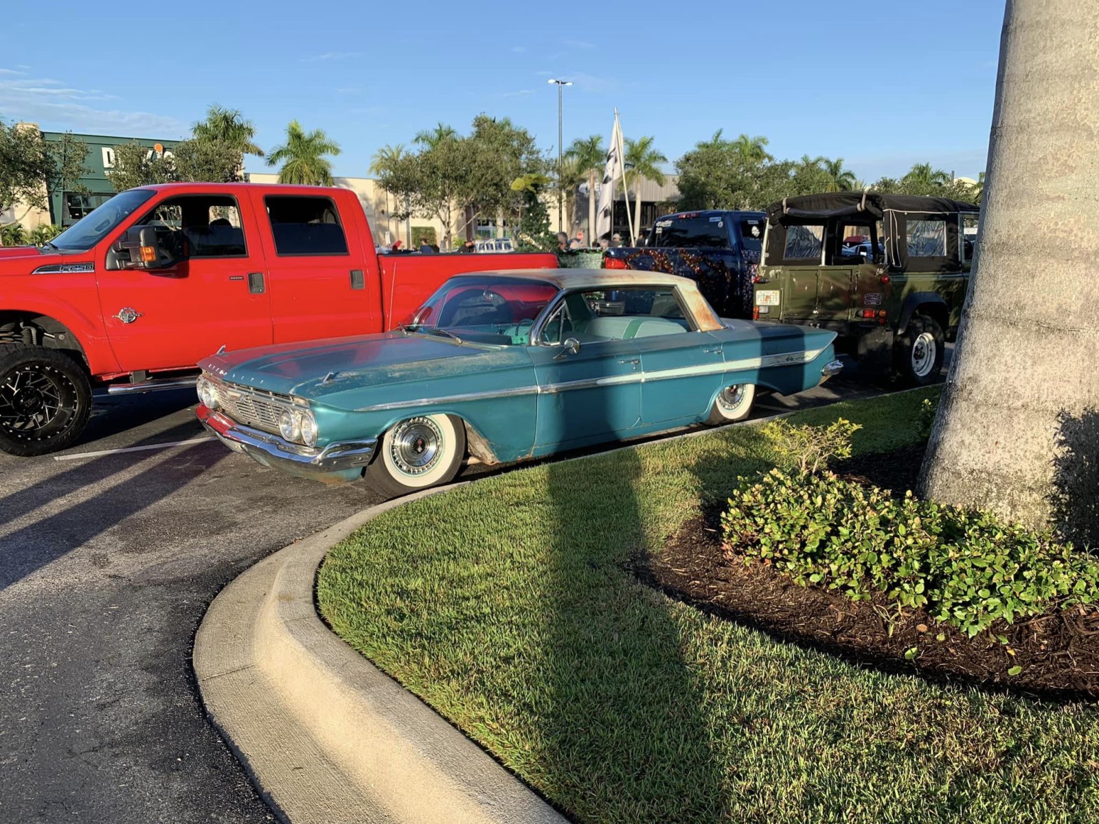

    Cars and Coffee in Sarasota: 900 cars. 200 New Mustangs. 100 new Corvettes. 100 new Camaro. 50 new Challengers still with the stupid yellow shipping protectors on the front splitter. 50 new Lambos. 50 new Porches. 50 new BMW's. 50 New Tesla Plaids. 50 Ferraris. 50 Aston Martins. 20 lifted 3/4 ton Bro-Dozers. 10 Art cars. 10 Bentleys. 10 street rods. Half a dozen early 60's Impalas, half a dozen Tri-5 Chevvies, one Diamond T, and me. The cool cars were all at Saltworks Fab. I can say I went though. ;) We drove to the beach last night to watch the sun sink into the Gulf of Mexico, no wiggling, no vibration.:cool: A9D825A5-8934-49E8-9E75-D26DA21B4249.jpeg 3379B50A-E202-41DF-A55C-B07B0063B3D9.jpeg F5173BD6-5E1F-42CE-B9C3-63BAE9BB3373.jpeg

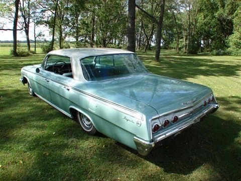

  19. DDDenny
    Posts: 21,651
    Hey Brian, did you notice whether the 61 Impala Sport Sedan was an SS?
    i.rant, SS327 and alanp561 like this.
  20. flynbrian48
    Joined: Mar 10, 2008
    Posts: 8,644
    flynbrian48
    It was not, at least it wasn't badged as an SS. Was the SS option available on the Sport Sedan? It's just a trim package.
    Stogy likes this.
  21. DDDenny
    Posts: 21,651
    Stogy, flynbrian48 and i.rant like this.
