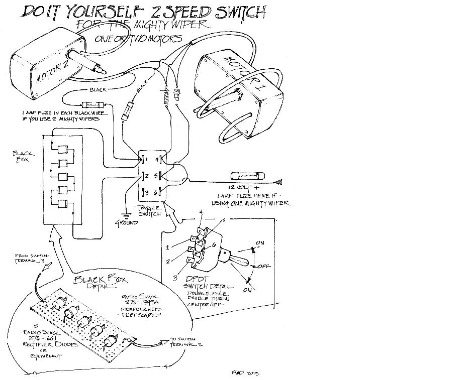

  3. mgtstumpy
    Joined: Jul 20, 2006
    Posts: 9,266

  4. squirrel
    Joined: Sep 23, 2004
    Posts: 59,253
    squirrel
    The diodes drop the voltage.
    Why don't you give the heater control a try, let us know how it works?

  8. I'm not too sure how that's supposed to work. Diodes pass voltage/current one way, and block it the other way. This also shows three wires from the motors, it appears his only has two. The 1 amp fuse size is suspect too, if accurate that's a very small motor. May be a stretch to expect it to run two wipers. And is Radio Shack still around down under? They're defunct here...
    The other thing to keep in mind is if you drop voltage to slow the motor, it will draw more current if the load is unchanged, sometime a lot more. More current means more heat, heat is the enemy of electrical systems.
    I'll throw out one more idea. Pretty much all small DC motors are 'timed' for maximum power/speed in one direction. If you reverse them, they run slower. Whether or not it will be slow enough to satisfy your inspector I can't say, but it may be worth checking. All you need for this is the switch shown above.
    In any case, I wouldn't run the wipers on slow speed for any time as the motor will very likely get pretty hot and it will probably shorten it's life.
    I've never seen a single-speed wiper motor run like this; all the two-speed ones I've seen have dedicated windings for each speed.

    Those diodes have a forward voltage drop of 1 volt, so putting five of them in series might give you around 8 volts or so at the motor, which should drop the speed roughly in half. It's a more accurate way to drop voltage than using a resistor...the drop does not depend on the load.

    Maybe the down under diode numbers are different but after a few hours making the circuit board and trying different connection combinations,it went frustratedly into file 13.
    Bought a NOS heater blower 3 speed switch on eBay . On the bench it seems perfect for 5 minutes running, it did not seem to get hot at any speed. It was something like 9v 10.5v and 12v . 8BDF6A47-6583-473E-BE97-191603447F57.jpeg
