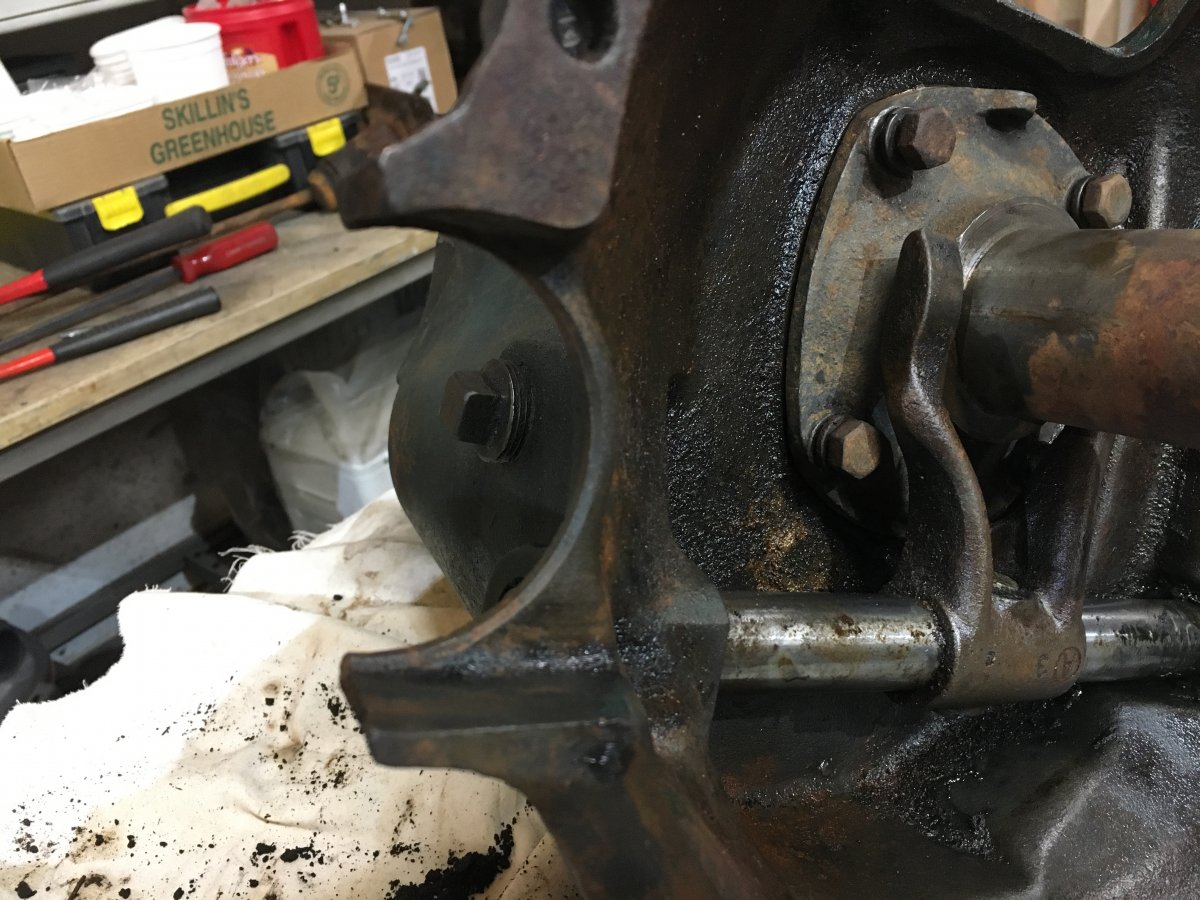

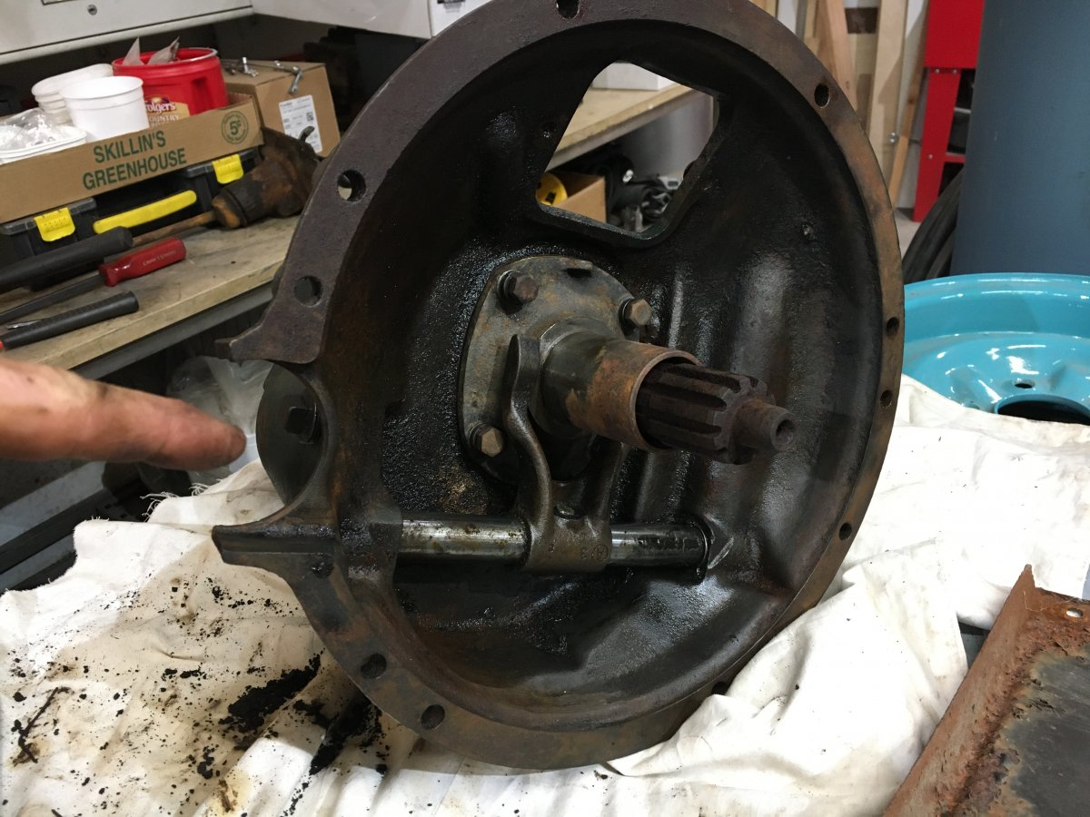

    Hello all,
    I picked up a pile of flathead 3 speed transmissions, shifters and housings last weekend and this one has me wondering.
    It is a 1940 V8-60 according to it’s serial number 54-541XXX. It looks like someone did some modification in the area for the starter.
    Question 1: Was this modification done to enable it to be installed on the bigger flathead V8?
    Question 2: It has a cluster gear with the following tooth count 29-24-18-14. Does this mean it’s internals are the same as the ‘42 to ‘47 half ton commercial?
    Question 3: Question two’s answer may answer this but will the guts from this ‘40 V8-60 fit in a 78-7006 top shift case? Straight install or will there be mix n match?
    Question 4: (Not V8-60 specific) Which of the 78-7006 housings (B, C, or T) are considered “best” or “strongest”? For what reasons?
    Thanks, Swerve

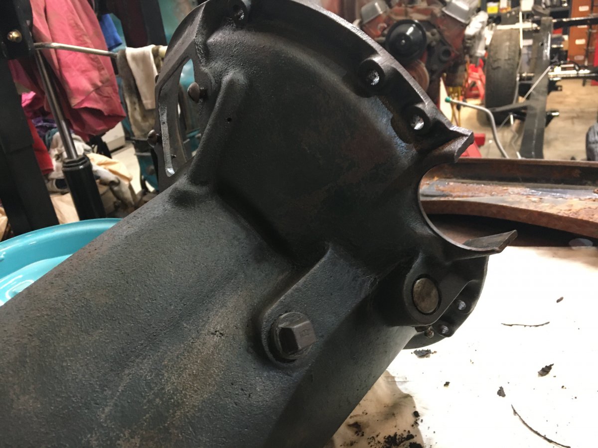

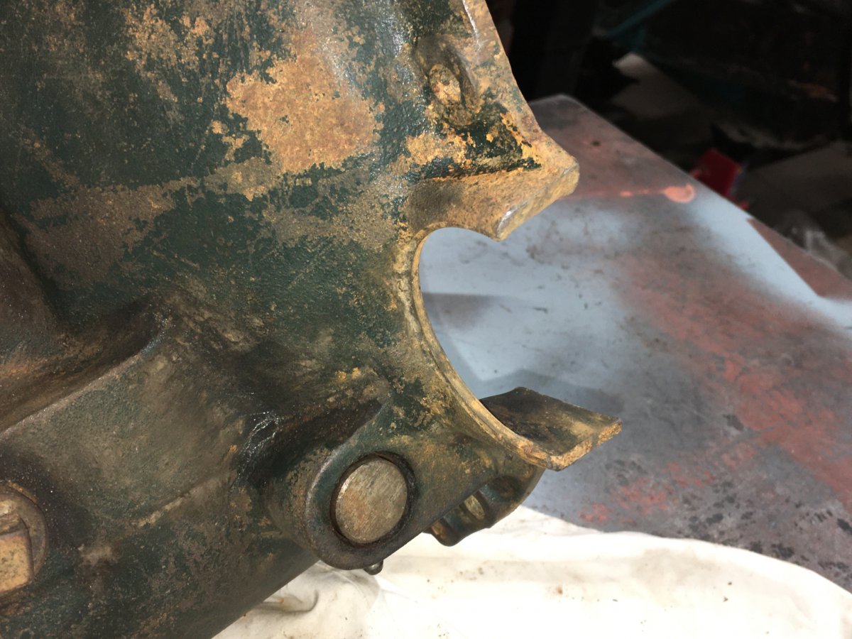

  3. I,m still doing the Covid-19 cleanup in the garage. Last week i found the 1932 cut-in-half gearbox that i did,nt even know i had ( other thread ) and yesterday i found this dirty old gearbox. So it only took 20 minutes to take apart and in my excitement how easy that went :eek: i did,nt even notice the bump in the casing :rolleyes: . Serial number is 54 - 491428. This will also fit the 21/24 stud flathead once i figure out what to do with the bump. Also a photo of the cut 1932 gearbox. So if you have any gearboxes with damaged casing don,t trash them. They can be used as a adapter .

  4. Not positive but if your 60 trans is the commercial one those gears should fit the V8 case.

    That's a V8 60 transmission, cut out is for starter clearance. There have been several threads on here about the 60 transmissions.

    The side loader transmission with the 60hp serial number is definitely from a 1940 Ford passenger car that came from the factory with the V8-60 engine. The odd “cut-out” area on the right hand side was to clear the starter bendix, and is missing the pressed steel cap that Ford crimped into the opening to close it off.
    The 1940 version of the 60hp transmission was an improvement in that it was designed for the 85hp gears including the newer type synchronizer. So technically, you can swap in any of the 85hp type gears.
