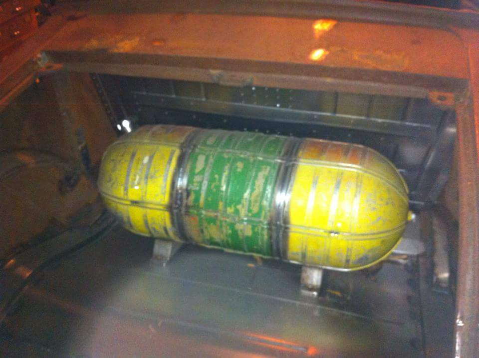

  16. the violator
    Joined: Sep 10, 2008
    Posts: 227
    the violator
    Here is one I welded together for Homemadehardtop57's Cyclone roadster. Used the straight center section of one tank and added it to another tank for extra volume. The diameter of the two tanks was consistent and the bands are on the outside for stiffening , I'm sure they had a lot of psi in them as an oxy tank . I made the feet and Jerry supplied the filler neck. I dont know how much it holds but it fits nicely in the ModelA. 1 016.jpg
    Sprout, orbitup and alanp561 like this.

  18. 5window
    Joined: Jan 29, 2005
    Posts: 9,897
    5window
    Well, it looks good in Jerry's car but I don't know about sitting exposed in a truck bed. It looks kind of dumpy to me-diameter and length just not quite in proportion. But, it's not my vehicle, just my opinon.
