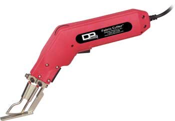

    An overlocker is a totally different animal but not necessary. You can prevent fraying by cutting fabrics with a hot knife
