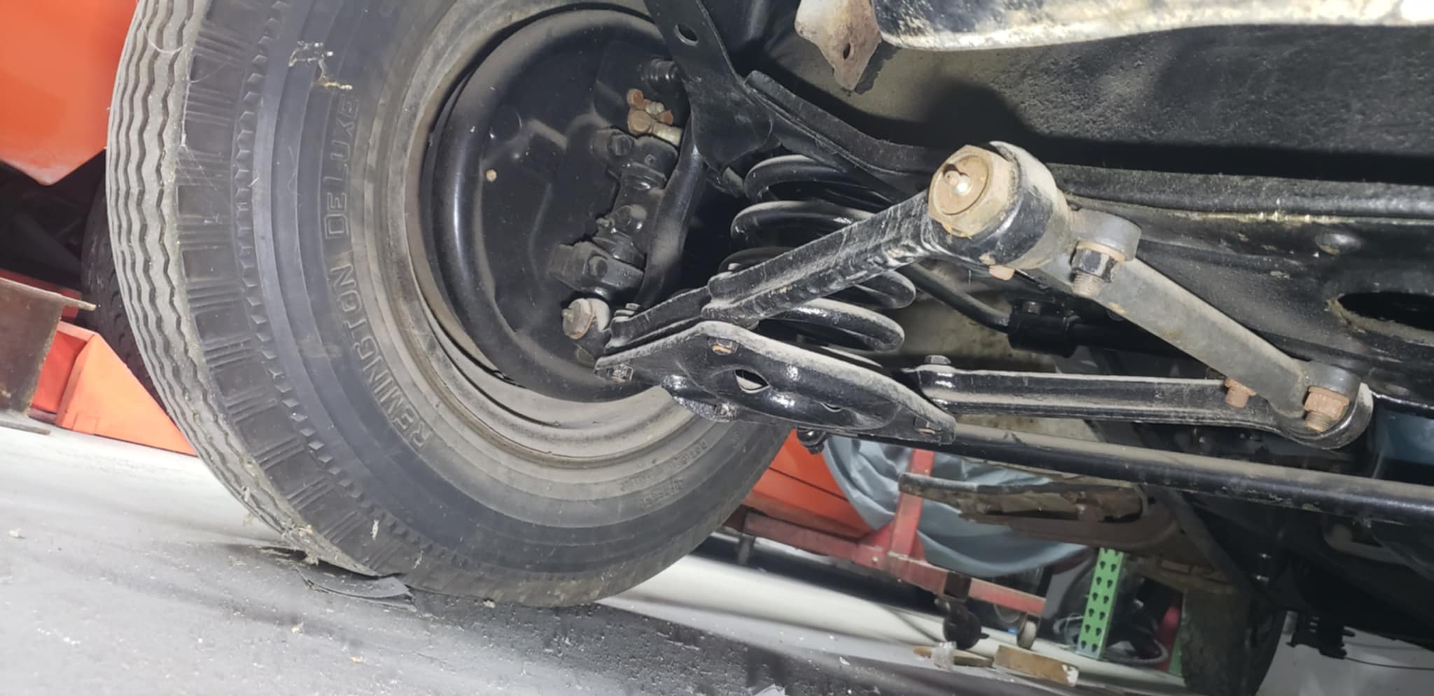

    I have a 38 Buick Coupe that is 100% original. I have a healthy 401 Nailhead and a switch pitch 400 that will be going in it. Id like to update the front suspension with modern tubular arms and ball joints instead of king pins. I'm not interested in MII stuff or grafting a late model front clip. I'm a decent welder and fabricator. Any suggestions ?

    Independent front suspension with lever shocks.

    It's all been rebuilt including the lever action shocks. Zero miles on it. I guess I'm just concerned about more than tripling the horsepower and torque on 1938 technology

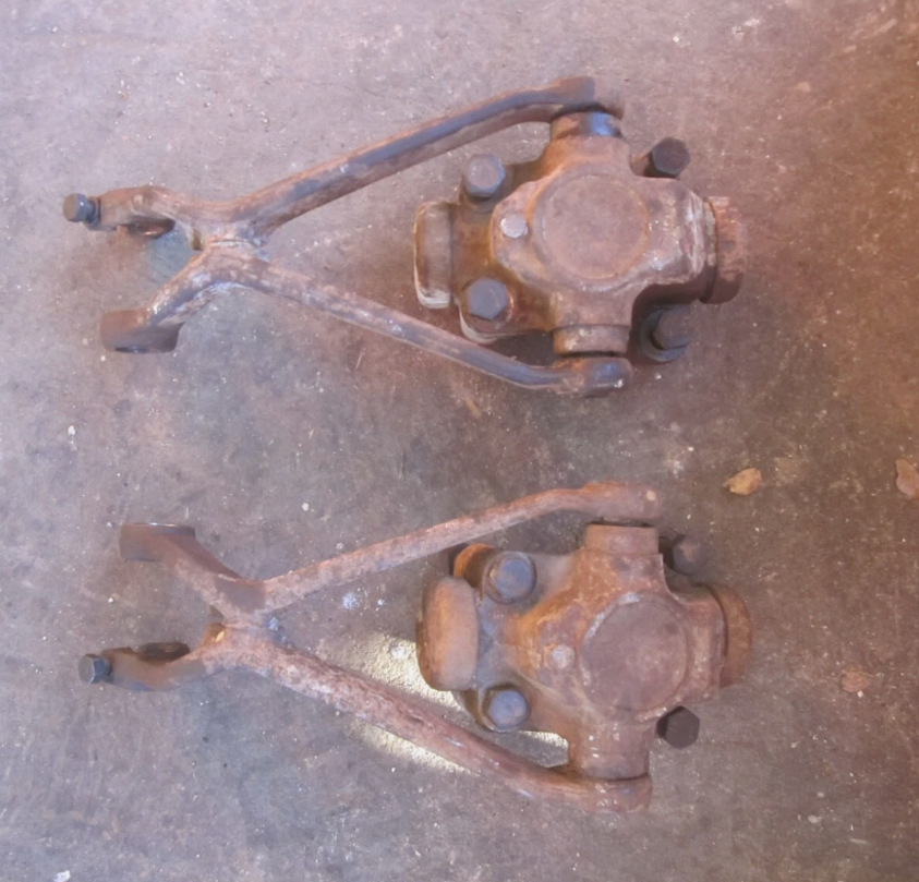

    It might not be all that dificult to fit a ball joint to the lower control arm (s)
    These shots snagged from Ebay.
    The uppers will take a bit of creative fabricating.
    Spindles will have to be rear steer spindles. That will limit things a bit if you want a disk brake spindle. Screenshot (275).png Screenshot (274).png Screenshot (273).png Screenshot (277).png
