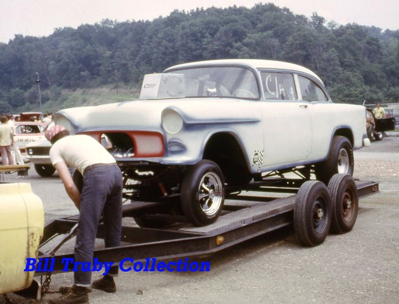

  6. Yep, yep. You just cut the frame off at the firewall, get some 2x4 box tube and a straight axle, and...
    Uh, nevermind..
