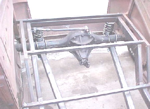

    Steve and shari made it over today to get some more work done on the T today, we finally rounded up all the stuff for the rear suspension and stuck it all together, heres a pic of the setup
  2. titus
    Joined: Dec 6, 2003
    Posts: 5,191
    titus
    it basiclally consists of:
    overload automobile springs (the middle weight load)
    2x2 steel square tubing
    2 4-bar set up type bushings (wider version)
    an early ford drag link (shorted for the panhard bar)
    a u-bolt and lower plate kit from a local trailor
    parts place
    perches from the same
    some 3 inch od tubing (to center the springs)
    some pads for the springs to sit on
    and yet to come shock mounts
    Its a very simple set up and works fine, i didnt almost the same thing on my 34 p/u, funcional and cheap.

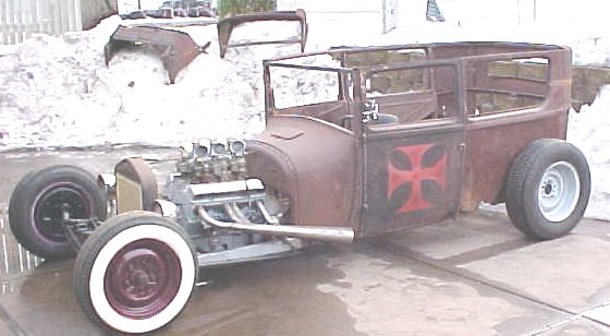

    heres an over all shot, the rear whitewalls are on order and should be here soon

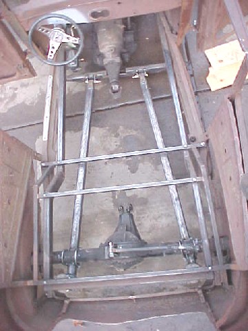

    heres also a pic of my getter all put together

    If I am 'reading' the pic right the spring appears to be resting on the 2x2 tubing that extends past the rearend. Is this the case? Also is the 2x2 attached to the rearend with u-bolts through a plate? It appears to be such a straight forward solution .. so I figure I must be missing something [​IMG] Any comments would be great.

  11. That is stupid-simple. I like it.
    Nice work
    TZ
  12. Roothawg
    Joined: Mar 14, 2001
    Posts: 25,811
    Roothawg
    Are there Heim joints on the front? Just kinda wondering about up/down twisting motion if only one wheel is up. Looks neat.

    Laverda, your not missin anything, just a simple set up.
    we are just using 4-bar type bushings, it wont realy twist much the way its put together
    never realy measured the amount of drop, but heres the best pic of the front end, i would take a better pic but battery is dead and misplaced the charger!
