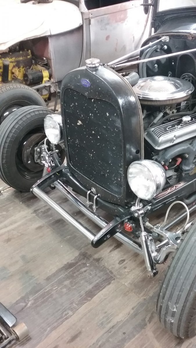

    The most objectionable is the feeling that the wheels are out of balance or out of round on the front end...but not all the time. If they were the front end would "bounce" or oscillate on smooth pavement as well as on slightly rough pavement, but it doesn't. On smooth pavement and at higher speeds the front end is dead steady. But on normal roads that have a little character the front end just isn't right. It feels like the suspension just isn't controlling the wheels. It's weird.
    Here's a photo of what I've got for a front end. The spring is from Posies and seems plenty flexible when I step on the spreader bar. Shocks are Pete & Jake's. There's nothing unusual about the front suspension at all other than the big clunky brakes. The calipers are the big, single piston late '60s to late '70s jobs along with the matching hubs and rotors.

    Just to add to what has already been stated, on my roadster I have a Posies front spring with the teflon buttons and in the rear I have coil overs with hairpins. The short test drive I have been on it seems to have a decent ride. Of course I got the shocks and coils suggested by Speedways website for the weight of my car and I am sure that helps. Front shocks are just standard Monroes and the spring is a dropped spring with reverse eyes on it.

    @missysdad1 is your frame notched for the spring?
    My 29 has no notch and my spring may be contacting the inner frame possibly contributing to my bumpy ride on less than stellar pavement.
    The Hotrod has been driven on this setup I have for since about 2010 but I have been meaning to add a spacer above the front spring to raise the nicely raked profile a tinge perhaps 1 to 2 spring thickness's to add some clearance at that location and possibly improve the ride.

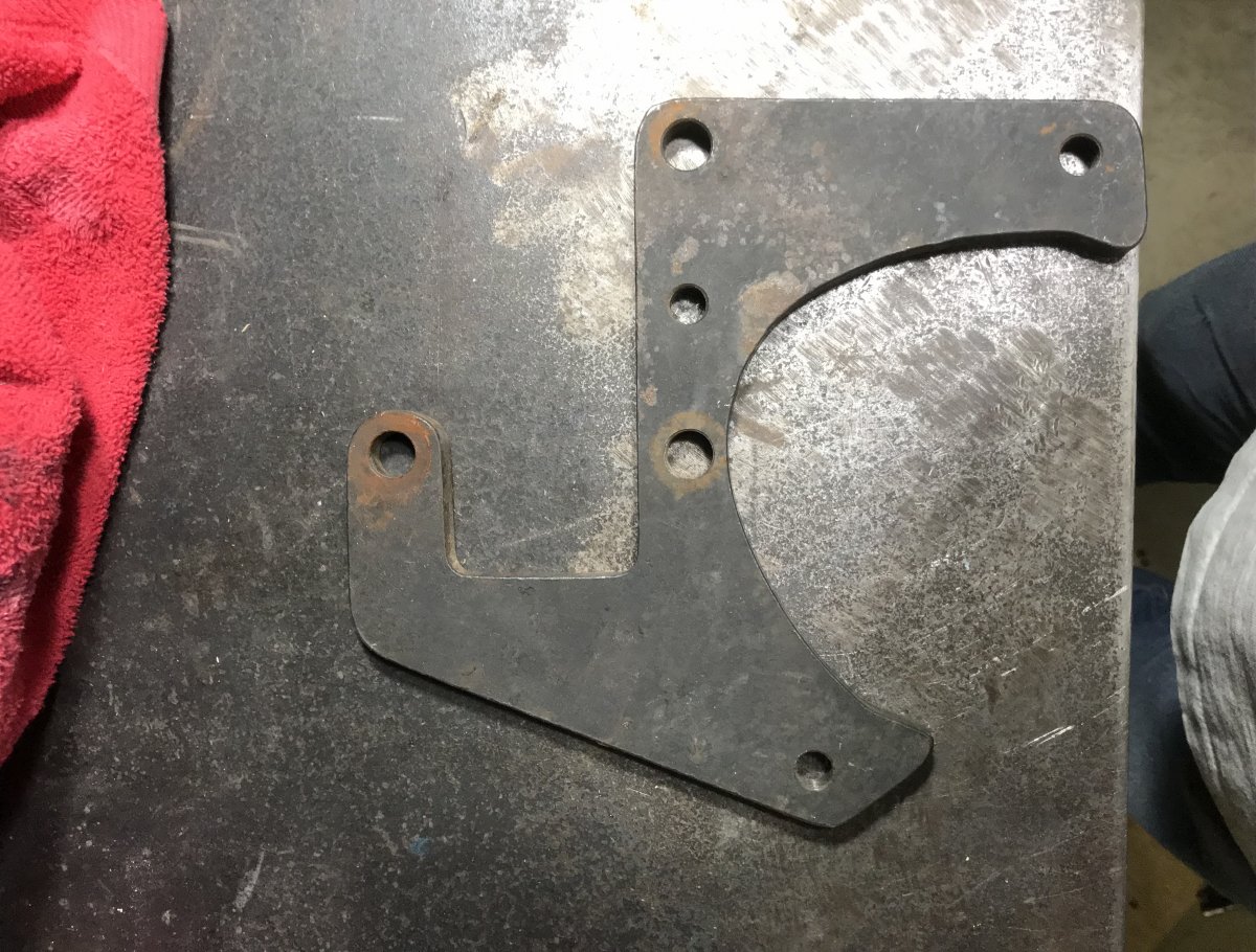

  25. Which bracket ?

    Flame cut, 3/8” plate from an old Butch’s Rod Shop kit.
    missysdad1 likes this.
